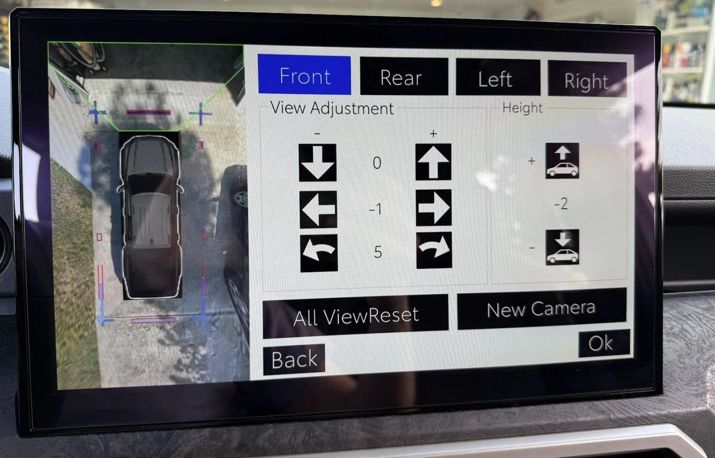

6. Navigate to Function Check > Camera Settings > View Adjustment
6a. If an option is greyed out, just hold the desired option for appx. 5 seconds and it will let you select it.​
7. After selecting View Adjustment, select Next.
8. You will now see the birds eye view of your truck where you can make adjustments.
9. After making your adjustments, select Ok.
10. Once it completes saving, click OK and you can exit the Service Menu. The next time you start the truck, it will ask you to complete service mode and just choose ok to complete.

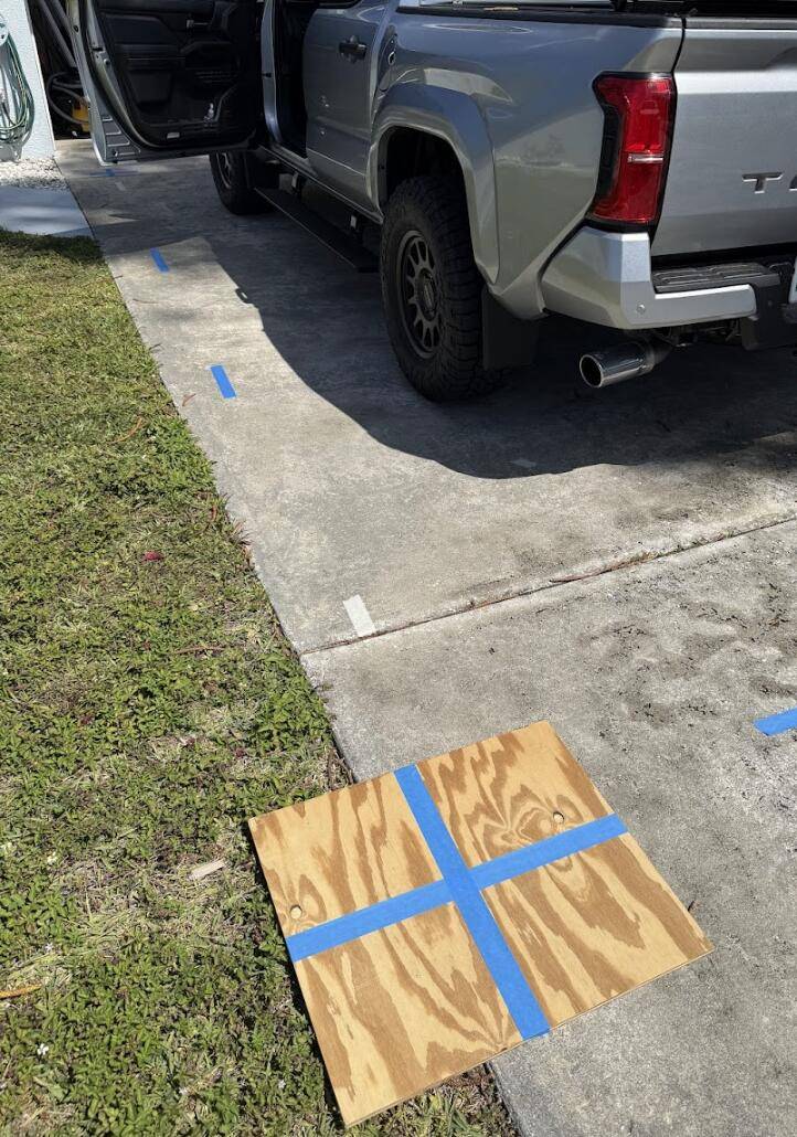

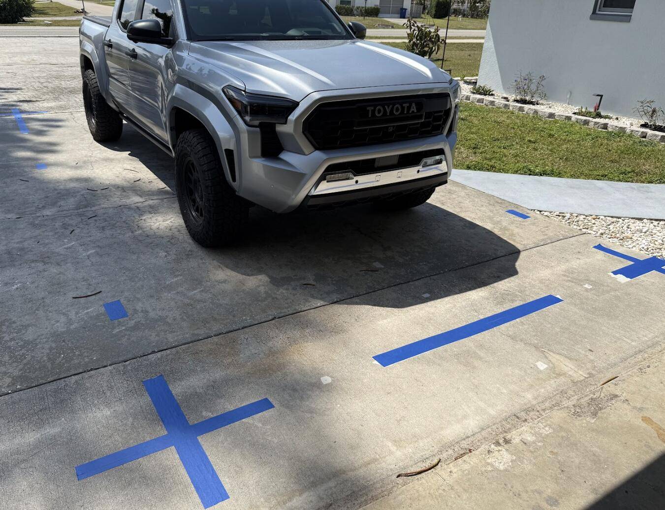

The official calibration procedure of laying tape down in precise locations was time consuming and very tedious to get all the tape lined up perfectly. Honestly, I think if you just take a 2ft x 2ft piece of wood or cardboard, put some painters tape on it, and move it around to each corner of your truck where your cameras 'mesh' together in the view, it will work almost as good. I've saw someone else mentioned they just went to a parking lot and used the painted lines.
2024 Tacoma How to recalibrate your 360 Cameras 1744997174649-i8
Tape laid out per the Service Manual Procedure
2024 Tacoma How to recalibrate your 360 Cameras 1744997187680-wq
This was as close as perfect as I could get it. It's not perfect, but I was happy with the results. Much better than how it came from factory. The adjustment values in this picture are not accurate, as each time you save, the value returns to zero.
2024 Tacoma How to recalibrate your 360 Cameras 1744997007899-5z
Using wood instead to save time.
2024 Tacoma How to recalibrate your 360 Cameras 1745002731767-d0

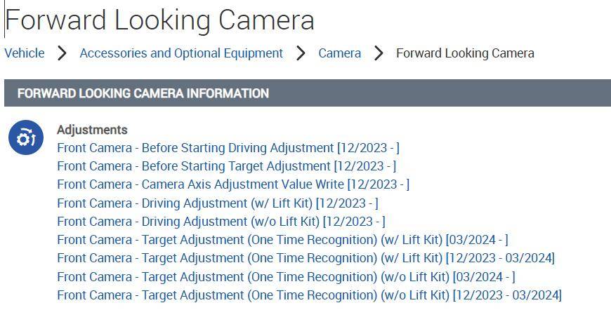

I have an ALLDATA account and found this. Several options depending on what your driving.
2024 Tacoma How to recalibrate your 360 Cameras 1745005233965-ee
What's the difference between these? Just references of initial starting positions?
Can you share PDFs of each link, similar to OPs calibration instruction file?
ALLDATA doesn't have PDF's, it's just webpage format which means if you have to deal with the formatting issues if you print or save to PDG. PM me if your interested in something.
