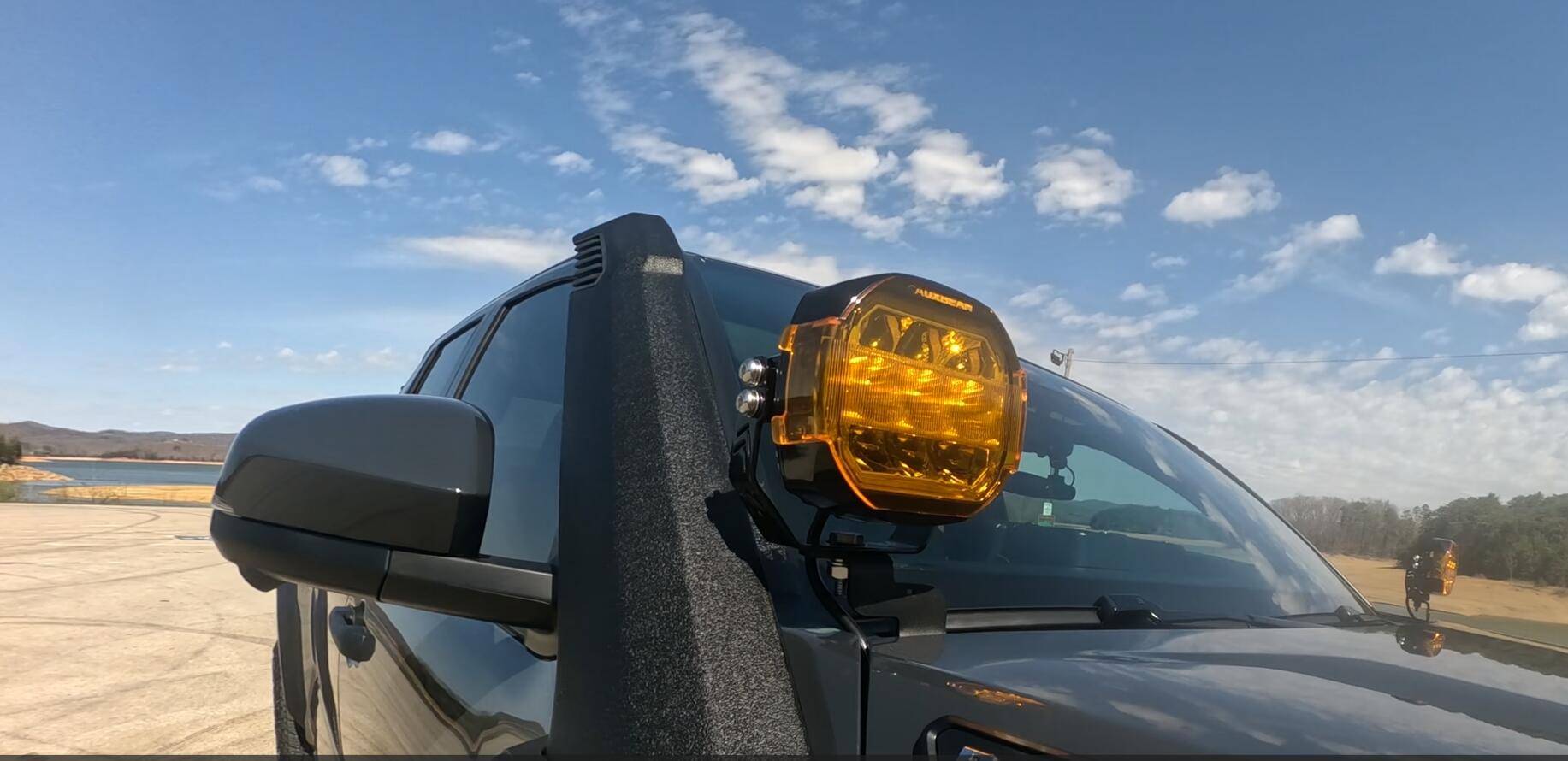

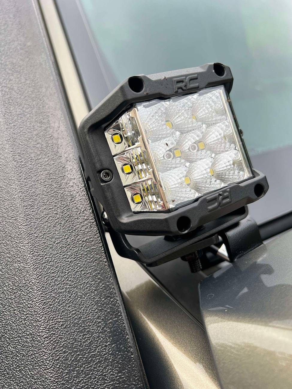

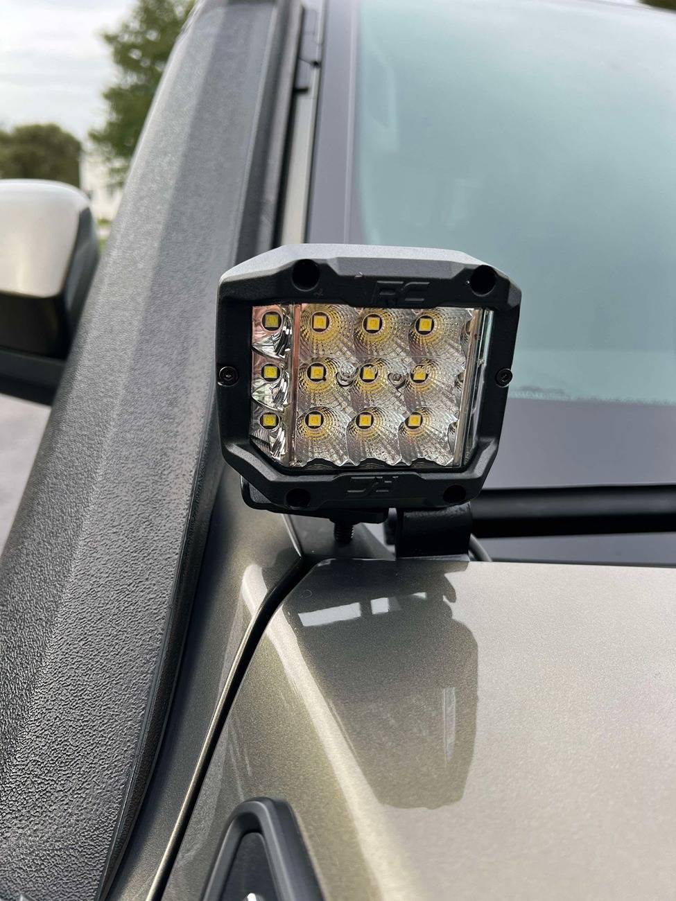

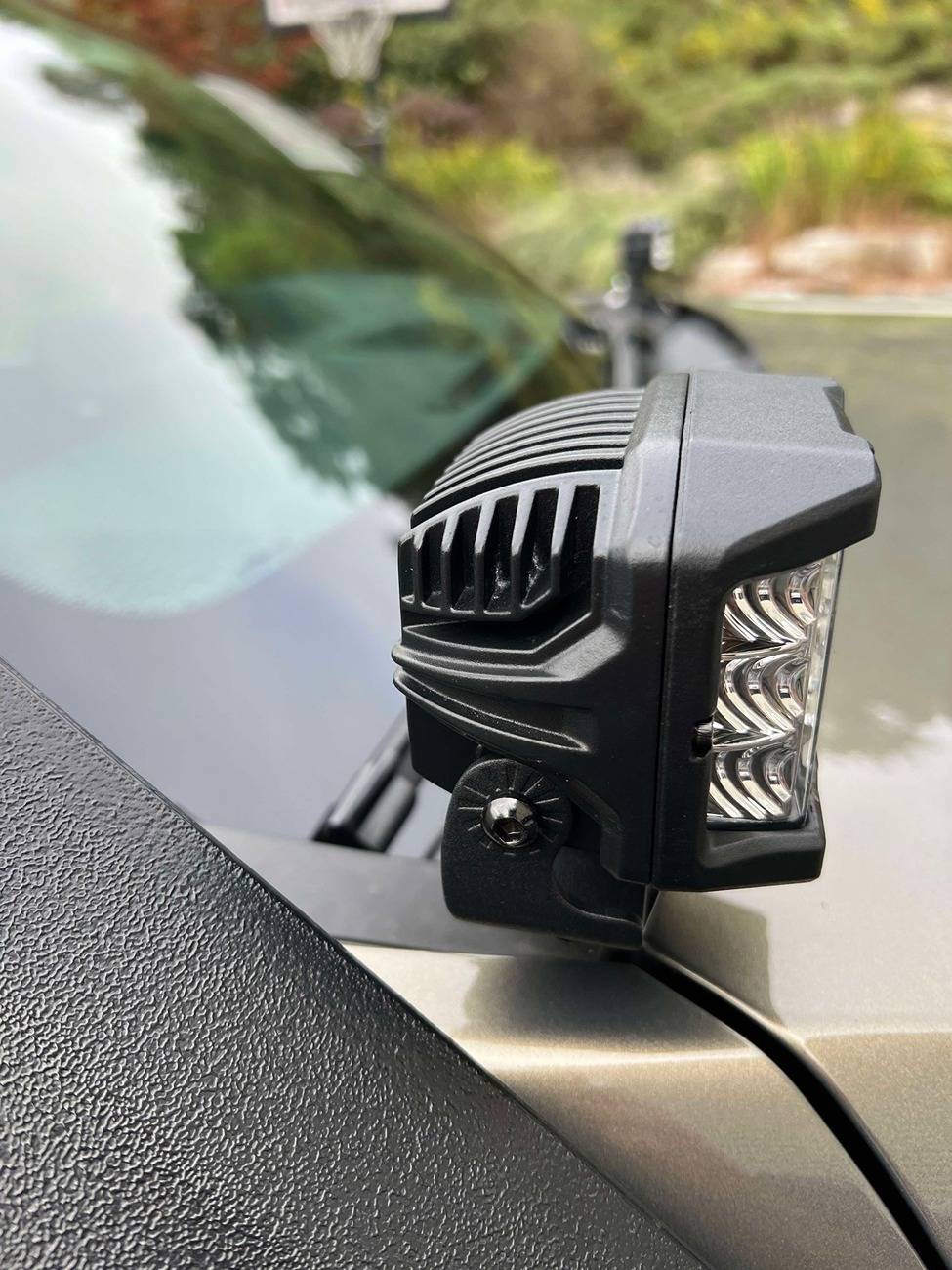

Same as the post above, except I used AUX 1. Running the wires in the engine bay is the hardest part. I used the same pigtail connector behind the driver's side headlight.
As for interference with the snorkel, depends on the size of your ditch lights. I would think anything under 3" will be fine. My 3" Rough Country Osrams barely fit while the hood is opened to the first notch (see pic). On the second notch - the one where the hood is open higher (not shown), it will definitely touch. If you're worried about someone accidentally accidently knocking the ditch light into the snorkel, you can try taping the second hole shut with some black duct tape or electrical tape. If it did happen, I don't think it would do any damage, but it would definitely mess up the position of the light in the housing.
