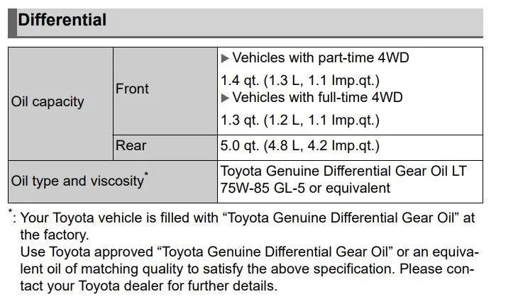

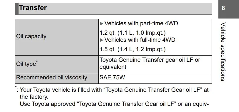

I did not go with Toyota, only because my local dealership didn't have any- and told me it would be weeks to get, which I don't really believe, but then I'm convinced I have the worst local dealership on the planet. (Chattanoga.) I cropped the manual pages below, the closest I could find was 75W-90 oil, and I used that in the xfer and both diffs, same thing I used to do on my 2004- so hopefully it won't be an issue. My recommendation is go get all the replacement fill/drain gaskets first- it's quite the collection of different types of washers- one copper, two solid aluminum and three of the crush aluminum types.

How did the old fluid look?
Good, light gold on the axles, clear on the transfer, large piles of shavings on the front and rear magnets, but that’s expected on the first change after breakin- I don’t get concerned unless that continues.

Toyota does unfortunately not carry the correct transfer case fluids and diff fluids are usually stocked in drums not for over the counter purchase. According to my system the Transfer oil isn't even available anymore saying its obsolete. From everything I have seen, information in conflicting. My dealer uses Mobil Delvac modern axle 75w gear oil(its 75w90 GL5) for all 4WD fluids including transfer cases yet from what I have read GL-5 is not compatible with the transfer case as the case has yellow metals(brass, copper, or bronze) and the sulfur in GL5 is corrosive to yellow metals. But if Toyota is using it, it should be safe? Because I cannot find any definitive answer, I am going to be doing my own fluid changes and using Redline MT-LV 70w/75w oil as it is yellow metal safe and meets the exact fluid viscosity requirements. Do not need my transfer case failing from Toyotas use of incorrect fluids.

Does anyone know if the transfer case has a vent?
It should, but I have not seen it. From what I understand it is somewhere low on the engine side of the firewall- difficult to find, and not high enough for deep water.
JayTech
Jay
May 5, 2025
197
199
2025 Toyota Tacoma TRD ORP
It isn't a small breather/vent like what you will find on the differentials but it does have one. It is part of a bracket and has a hose that attaches to it.
