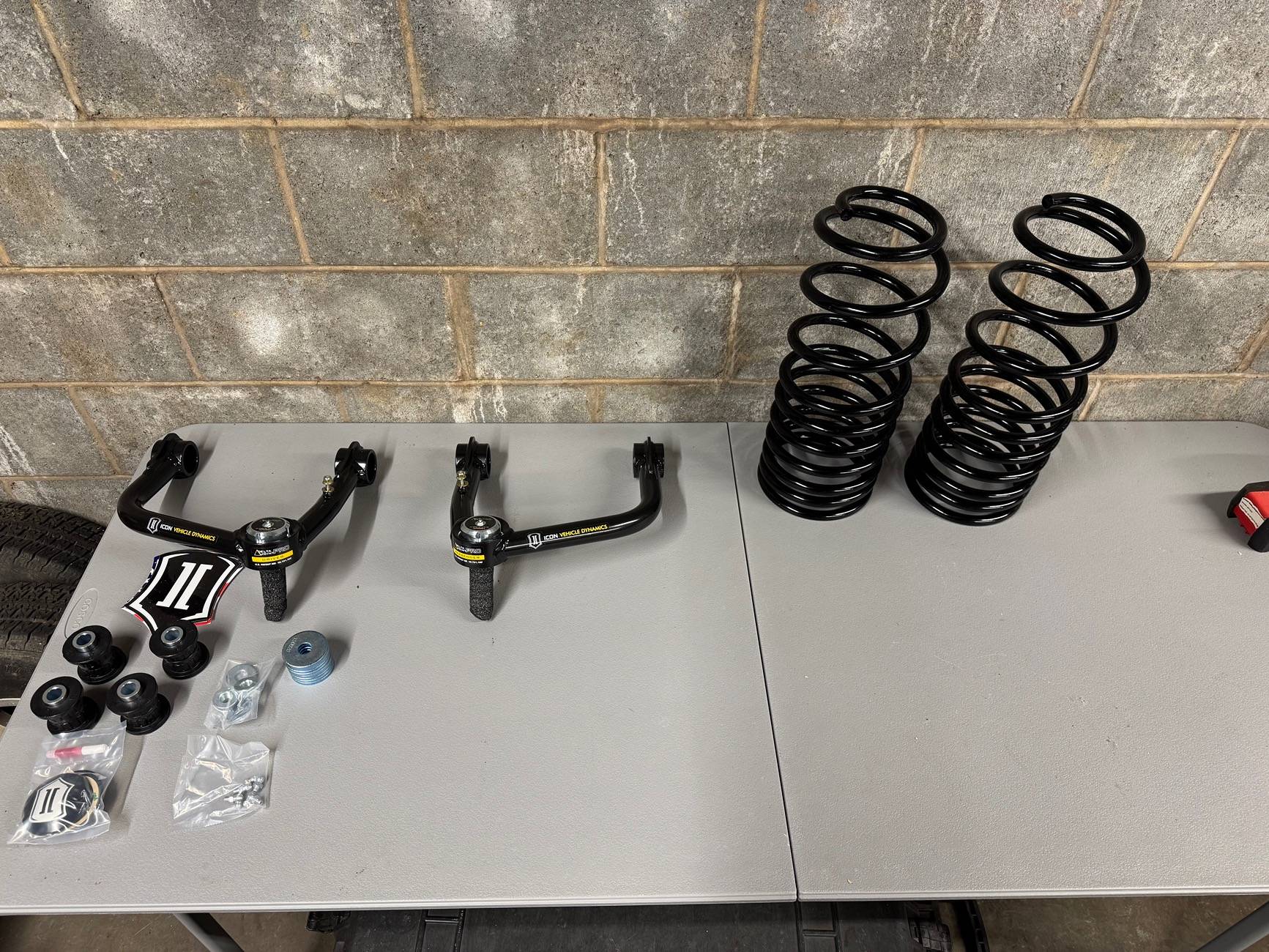

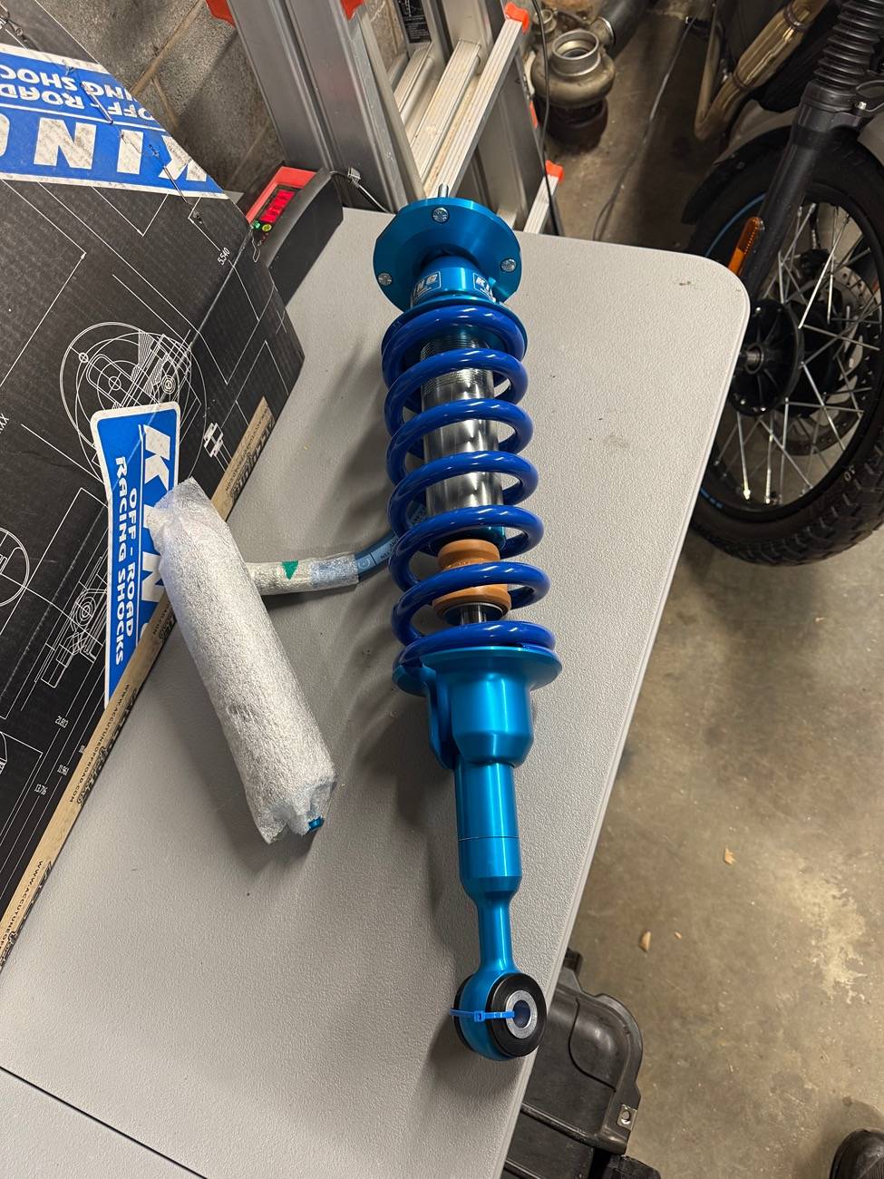

Starting to receive parts for the suspension upgrades!
Ordered:
Icon UCAs- Arrived
Icon triple rate rear springs- Arrived
Kind front struts
King rear shocks
All ordered from Accutune last Wednesday.
Springs and UCAs arrived today via fedex. I’m assuming the shocks will take longer since they’re being tuned per my specs.
I am not an over lander so this truck will not see a ton of extra weight added but I occasionally tow my small camper and trailer loaded with motorcycles and dirt bikes. Also, I’m definitely not pleased with the front suspension, I have bottomed out several times just coming off curbs and small dips on the trails. It’s a harsh hit that really makes me question how long the stock struts will hold up.
The stock shocks just don’t feel right after driving the Canyon AT4X so I’m doing something about it.
I chose the Icon tubular UCA because I can’t imagine a situation where I’ll need forged parts and honestly couldn’t justify the price of the other control arms that have the same style joint and bushings. Tubular just looks cool, too. I’ll be keeping an eye out for lower control arms.
How do you guys feel about the front diff drop? I doubt I’ll need it for the modest 1.5” I plan to lift. I like a little rake because I do still use my truck to tow and haul.

My front lift is 1.5, no diff drop. CV angle looks good

Bit of an update…
Installed the Icon Triple rate springs and lost 3/4 of an inch in height…
Scratched my head for a bit and then realized just how stupid I was.
These springs are for a 2024 Tacoma TRD Off-road WITHOUT the iForce max option. Icon’s website doesn’t list an iForce option so it’s totally my fault. I completely glossed over the fact that the hybrid version is over 400 lbs heavier.
luckily it’s an easy swap. If anyone is interested in some new Icon triple rate performance springs, hit me up and I’ll make you a great deal!

That sucks! Maybe the Tundra springs will work?
What’s the lift of the Icon springs 1/2 inch?

I considered Tundra springs but my goal was a softer ride off-road. I think these icon springs would be perfect for a non-hybrid truck.

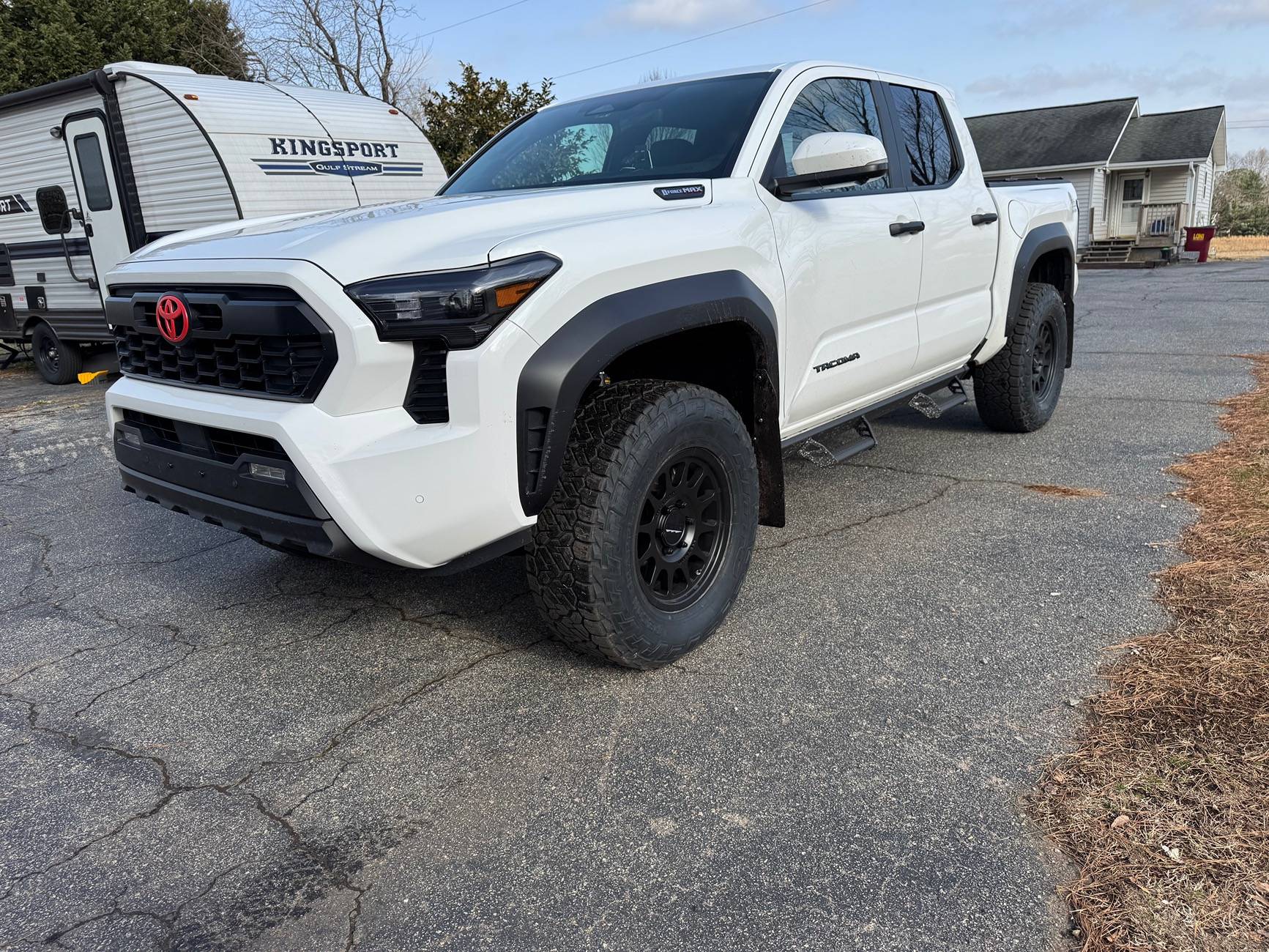

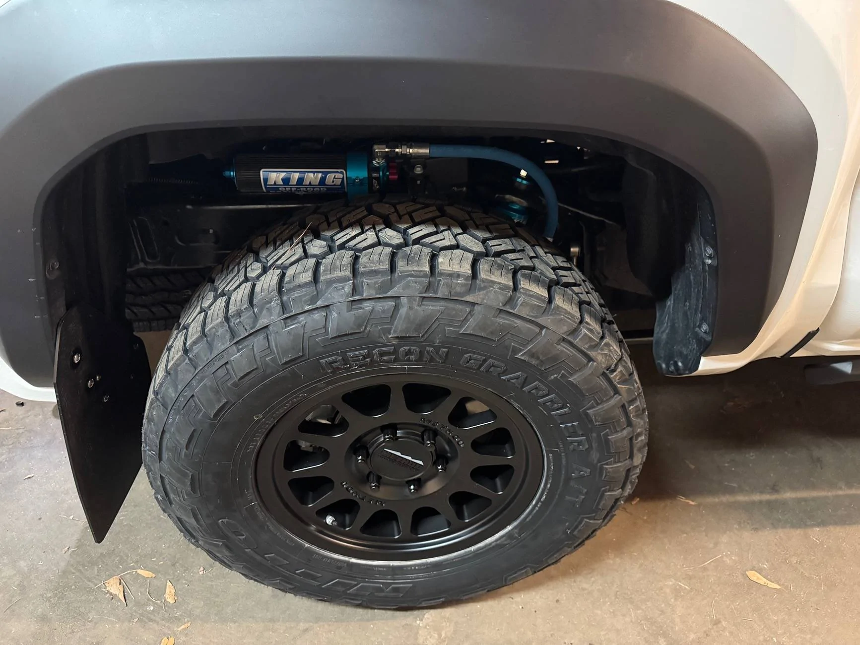

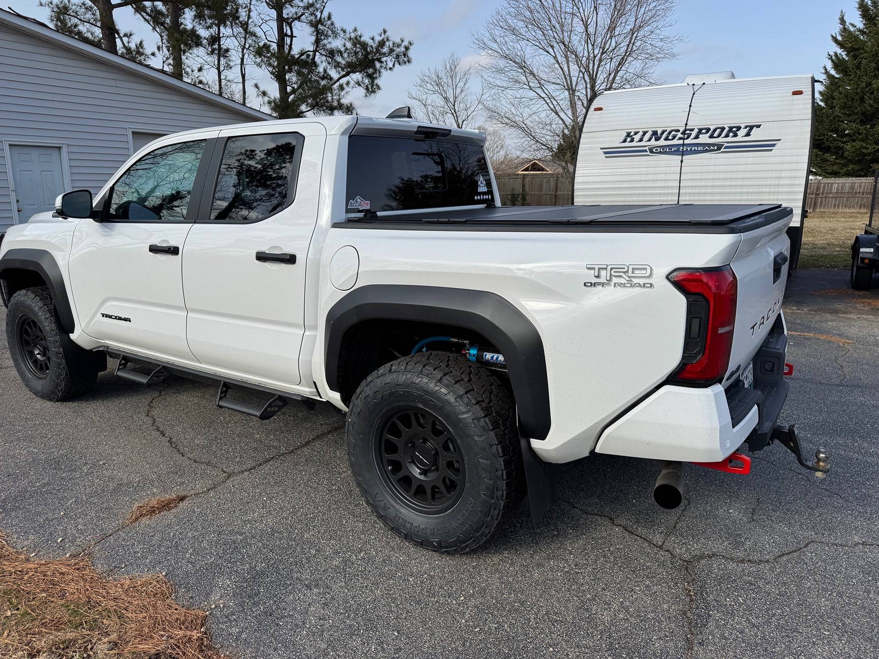

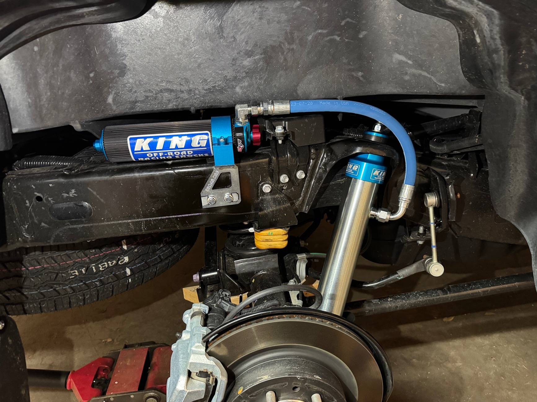

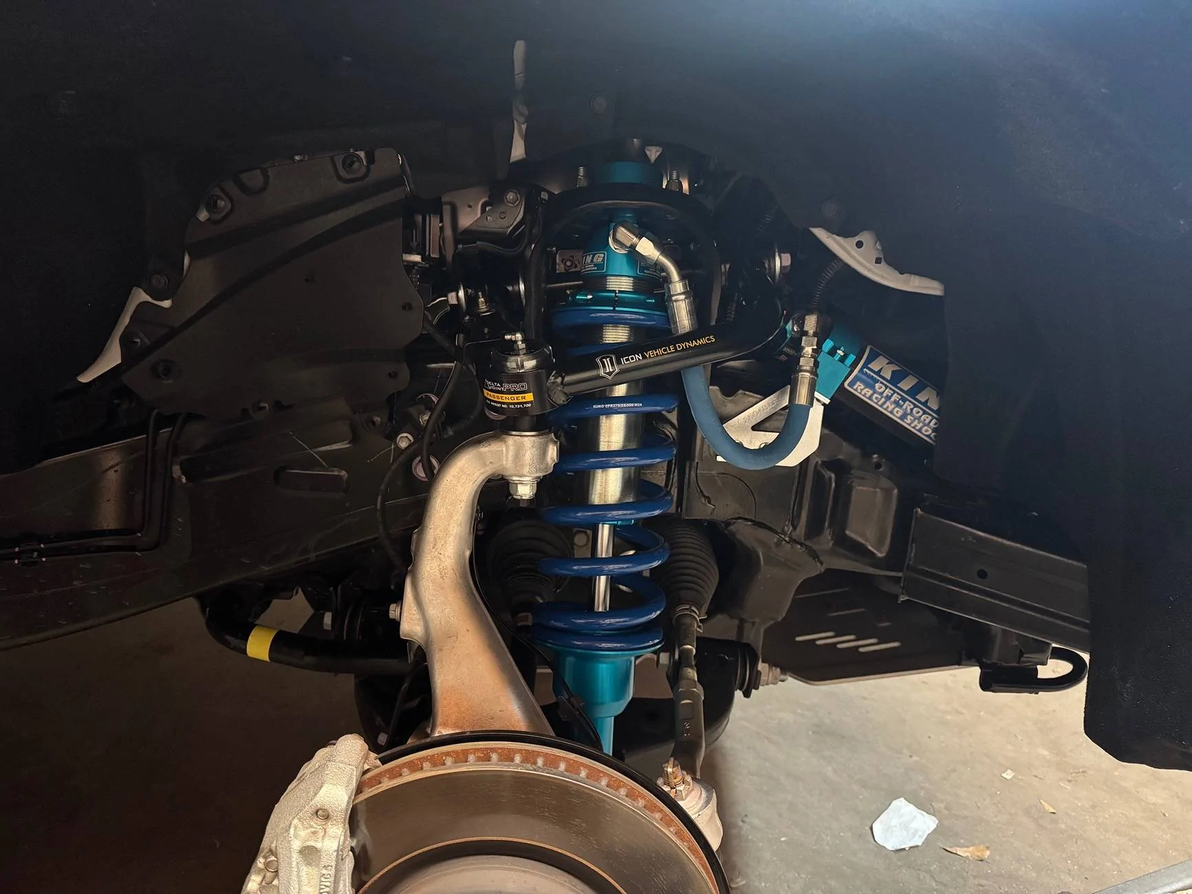

Finished installing the suspension components last week. What a difference!!! No more bottoming out and rides so much better!
I did the alignment myself in my garage with an angle finger and tape measure after installing everything and drove it for about a week while waiting on my appointment with the Toyota dealership.
The dealership checked the alignment and said it was spot on! No adjustment needed, so now I feel confident in doing my own alignments on this truck from now on. Which is good because I have more plans for the suspension down the road.
