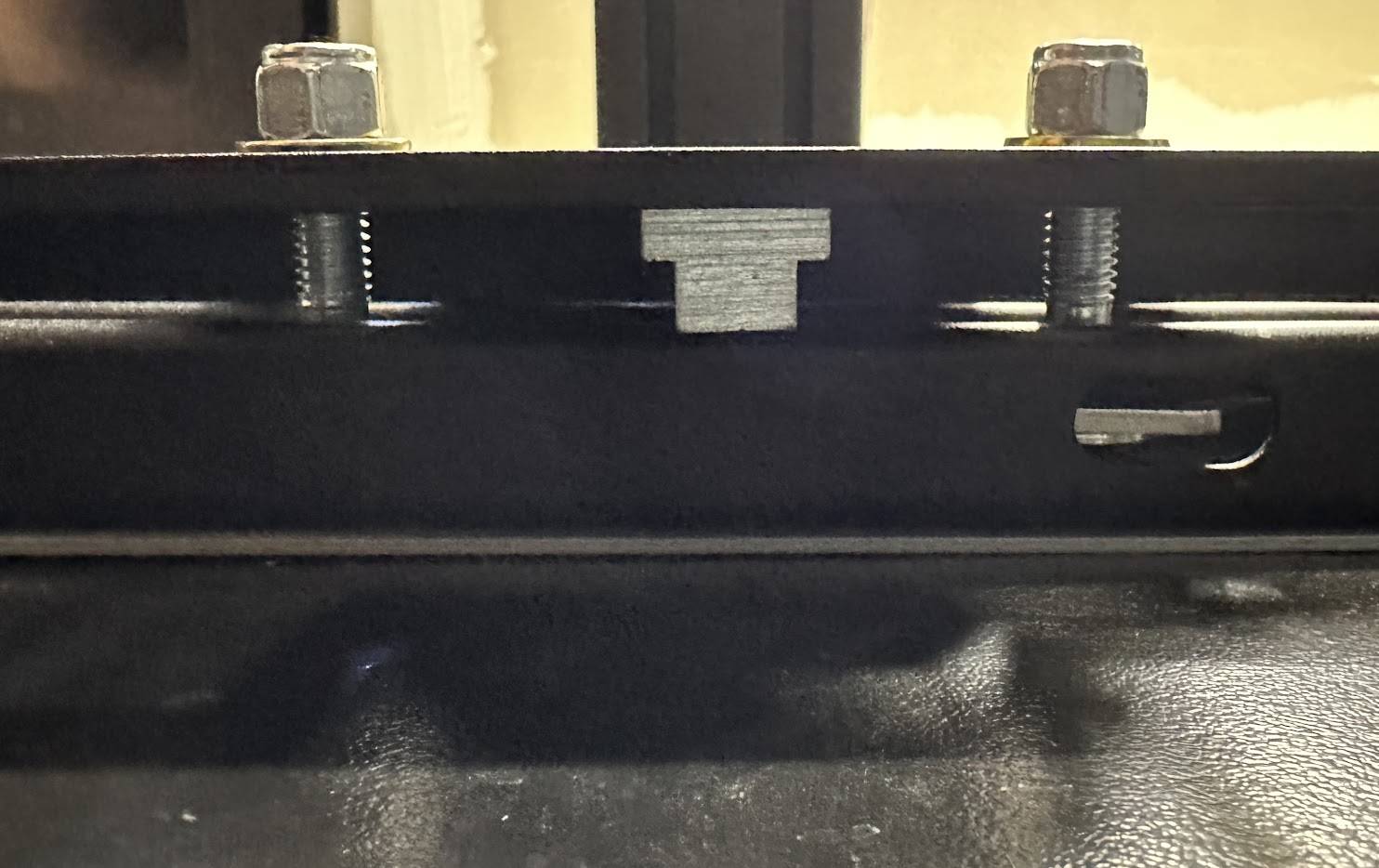

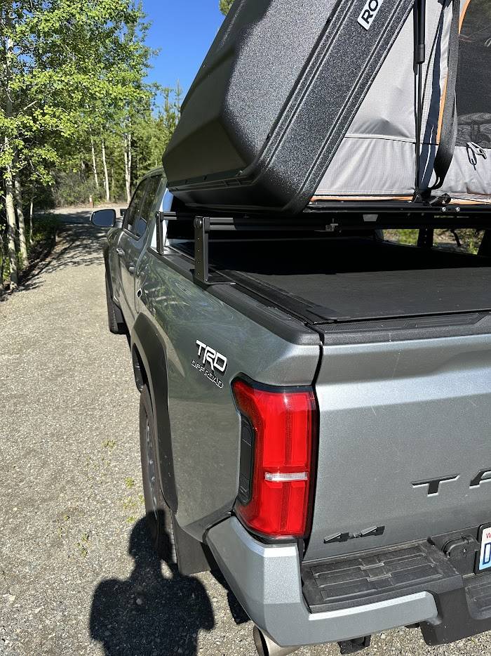

Before we even bought the 4G, we purchased the RTT and had a vision of how we wanted to build it out. Our lifestyle lended us to needing a solid lockable storage option for the bed and not tanking gas mileage with it being my daily. After researching the 3G forums, the most practical and secure option for our situation was the BillieBars + Bak Revolver X4s combo.
  • Tonneau cover criteria
    • above average security (no soft covers)
    • bed access with RTT installed at mid height (no tri folds)..
    • not eat into bed space (no retractable)
  • Bed rack criteria
    • keep RTT close to roof line
    • tonneau cover compatibility
As we most of us have since learned, Realtruck has poor customer service and order fulfillment transparency. I originally ordered the BillieBars with Bak-specific brackets anticipating having to relocate the bed rails like they did with the 3G Tacos (and apparently OEM 4G tri-fold). After 6 weeks finally received the X4s and learned they changed the mounting hardware and no longer required relocated bed rails. The Bak-specific BillieBar brackets are no longer compatible with the 4G Taco because of Bak changing their design!
This is where BillieBars came in CLUTCH!! We were about to head out on a 1,200 mile trip and needed to figure out a solution asap. Dozens of pictures and emails later, Billiebars sent out custom bars + standard brackets without hesitation and arrived in time for our trip. Because of how the new Bak X4s tonneau cover mounts are inset inside the bed (decreasing bed width at the rails), shorter BillieBar bar lengths were needed. Mind you, I have no presence online as an influencer. Just a normal guy trying to make this setup work and seemingly one of the first to do so. BillieBars went above and beyond to make this all possible in such a short period of time.
We considered multiple different fitment options to get the Billiebar brackets to pass through the tonneau rails and this route seems like the easiest way to go about it. I used 1/4" thick x 1/2" wide weatherstripping between the tonneau cover mount and tonneau cover rail to fill the void. A shim was also needed behind the BillieBar bracket to help it stay flush to the mounting rail. I expect BillieBars will probably be working on a similar solution for this. I haven't done a water test yet, but I'm confident it's very water resistant knowing no covers are 100% wateproof.
Edit : The tonneau cover rolls under the rearward bed bar, but does not have another clearance to roll under the forward bed bar. I can access ~80% of the bed with it rolled up, but at least everything underneath is still usable storage space. Pictures in next post.
I have many detailed photos I'm happy to share if specific questions arise, but here are some of the end result! Super happy with how it all came together!
