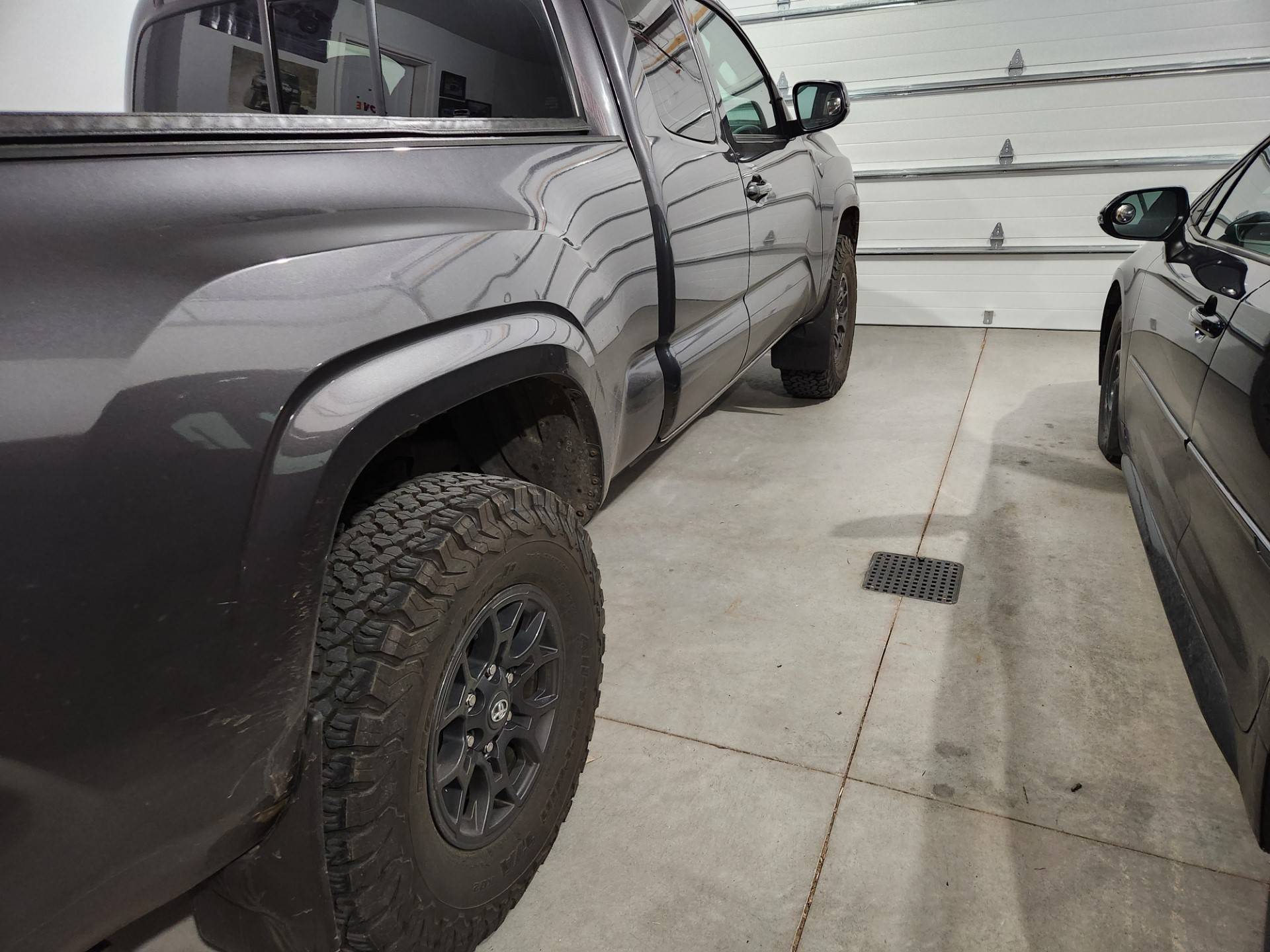

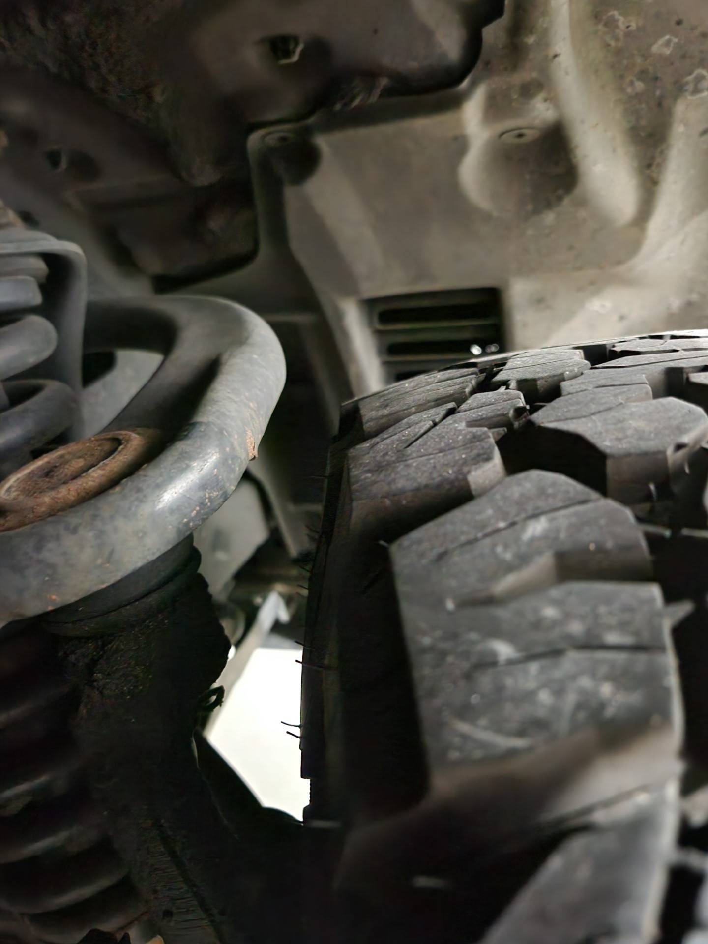

2024 Tacoma SR5
275/70R18 fit without any modifications needed and no rubbing
