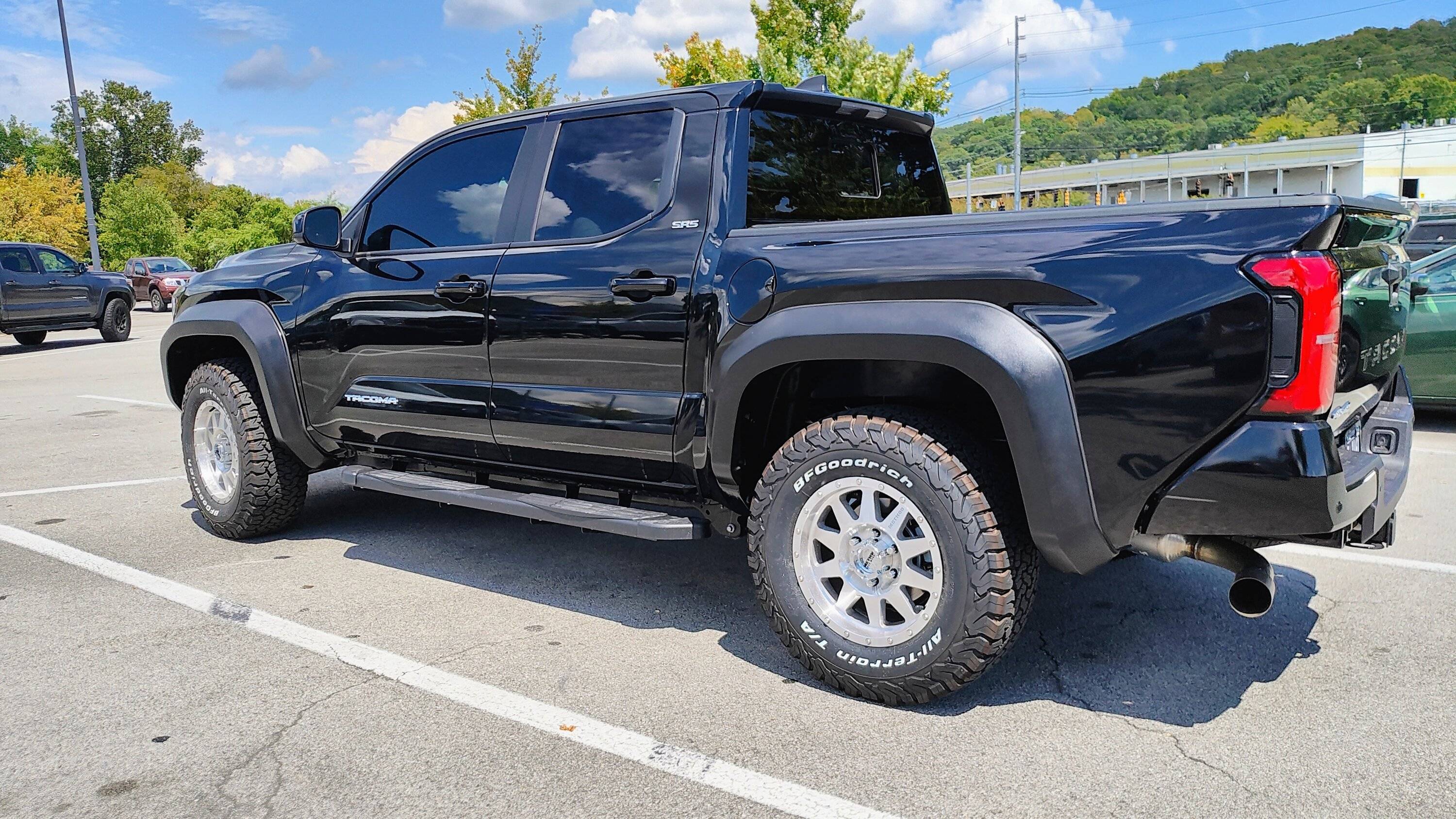

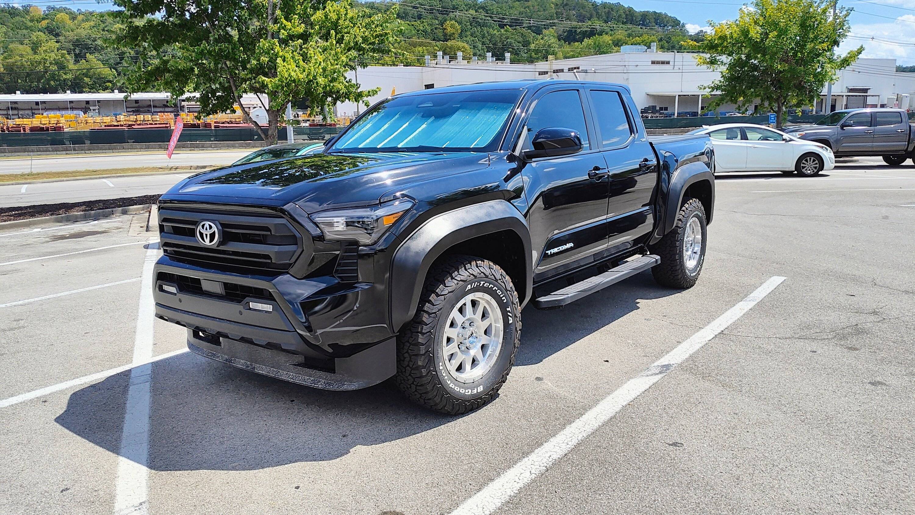

Any modifications to make them fit such as removing the crash bar? Looks good.
No modifications needed, these 285's (32.8" diameter) fit nicely with a decent amount of room to spare. Thought about going a little bigger, but then I wanted to make sure there was room if I ever need snow chains, or to help avoid something getting lodged in the wheel wells if I run over something.

Nice. Can we get a perfect side view right down the side so I can see how much it sticks out? Only thing from keeping me upgrading yet. I want totally flush and have not found the perfect wheel and wheel offset yet.

Nope still haven’t found what I am looking for. Everything seems to poke. I may just go get a set of TRD Pro all black wheels during Black Friday. Problem with that is all my local dealers SUCK and never discount and the far away ones that do want like $1000 for shipping which is absurd.
Nice. Remove the airdam in the front and add the Westcott 2.5” level kit. You’ll be stoked.
