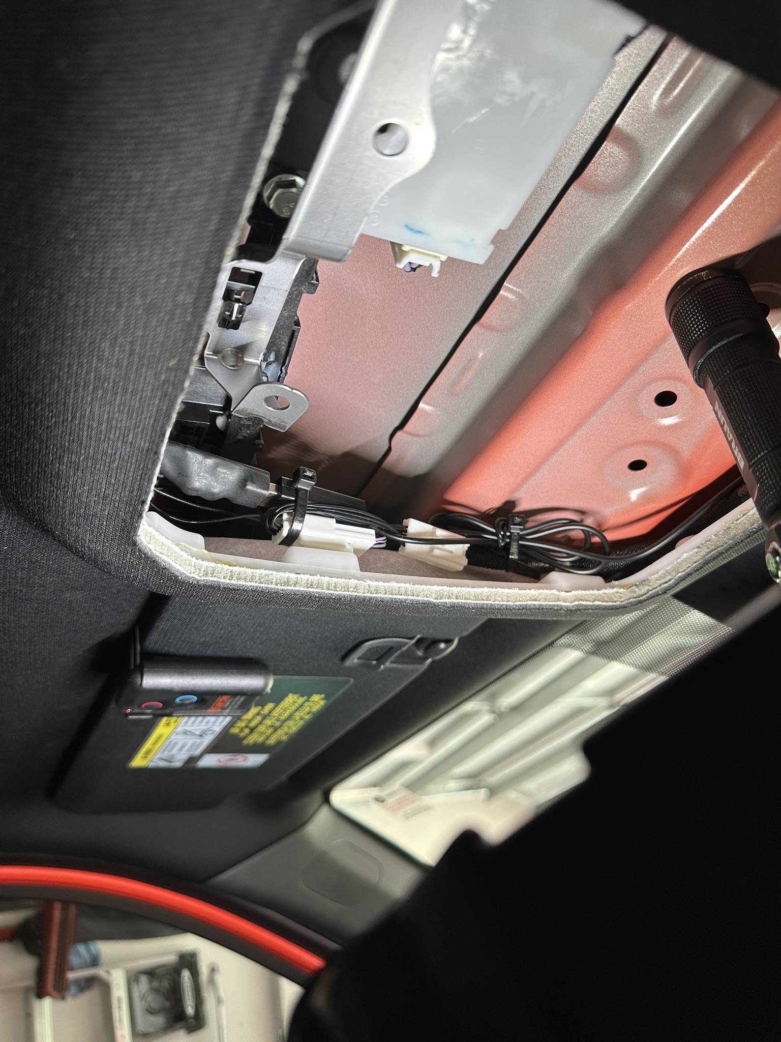

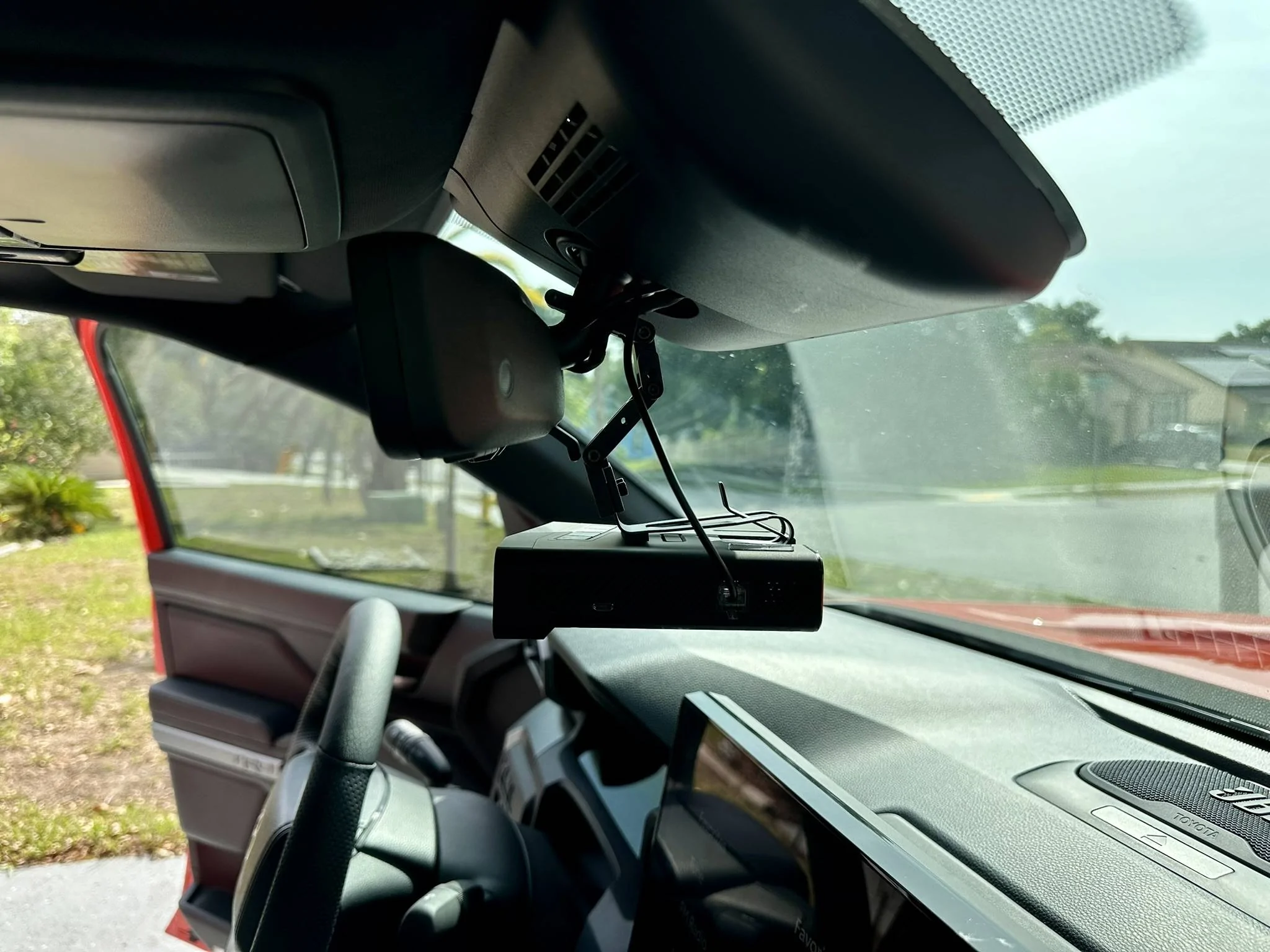

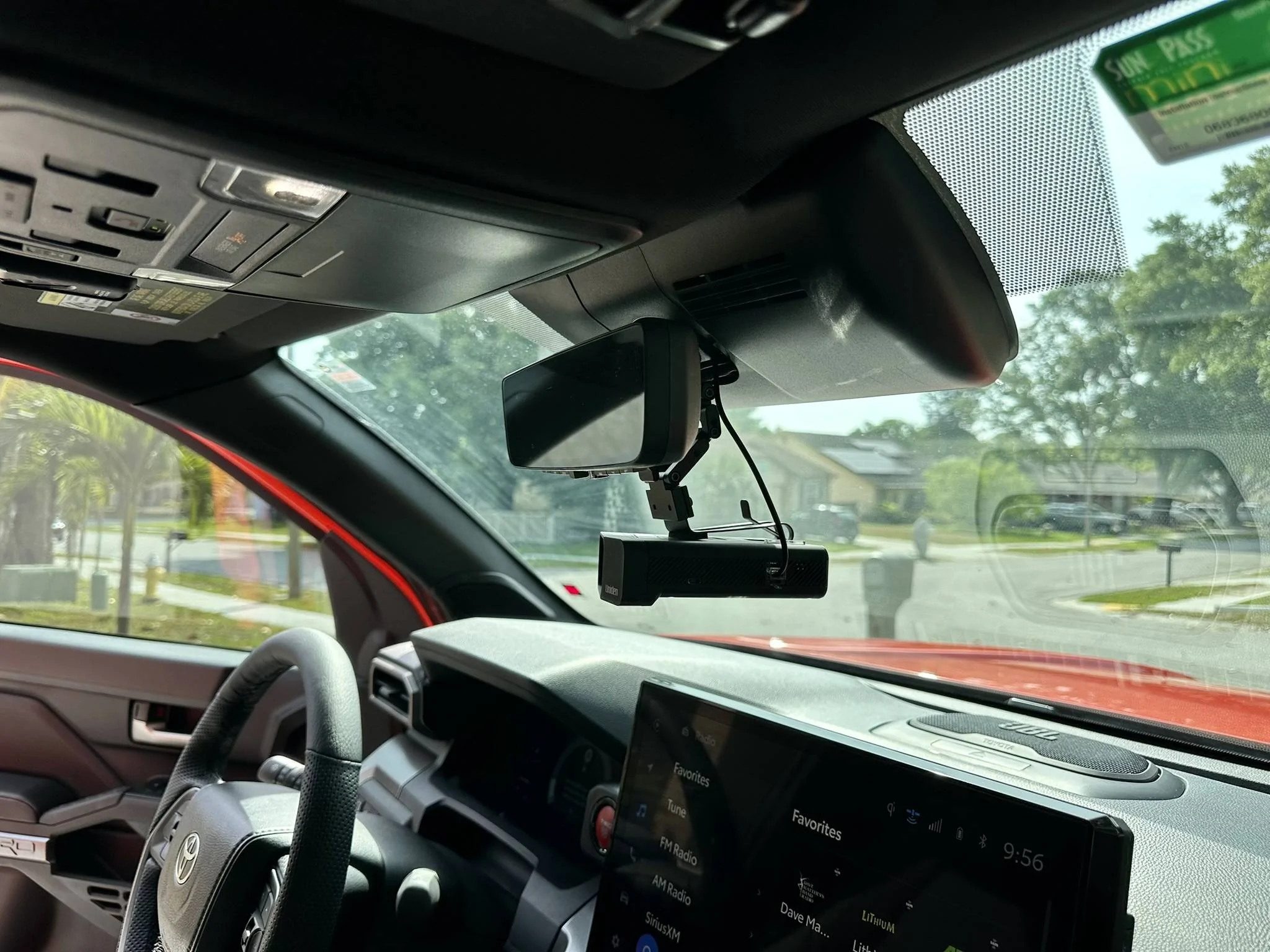

Solved - I used the Dongar 5pin and then a USB to RJ11 adapter adapter above. It turns on/off with the car. No issues! Thanks!
