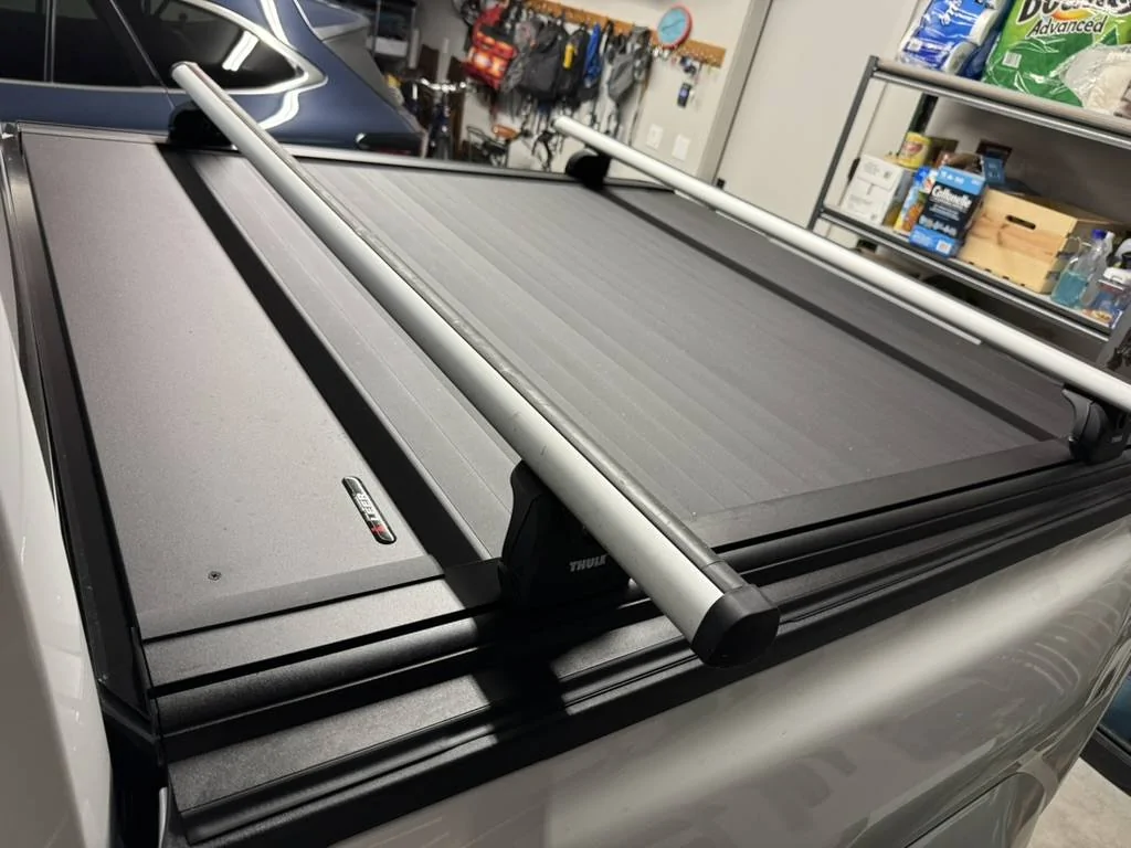

1) I purchased from E-Trailer and the unit delivered (311-KMTA10A38) didn't fit the truck. It was for 3G Taco. The difference is that the 4G bed has tapers at the front corners of the bed that block the tonneau cartridge from mating up to the front of the bed at the cab. The 4G unit merely has an extra piece that fills that gap. E-trailer was no help and wanted me to return the unit. Instead I contacted Pace Edwards directly and they expedited me the missing piece free of charge. After that the install was easy. It clamps to the bed track system in the truck on the sides, which is a more robust connection that some cantilevered clamp systems I've seen on-line. One downside is that it blocks the bed track front and back, so you have to get whatever accessories (I have a modified OEM bed divider installed) onto the track before installing the tonneau. See photo.

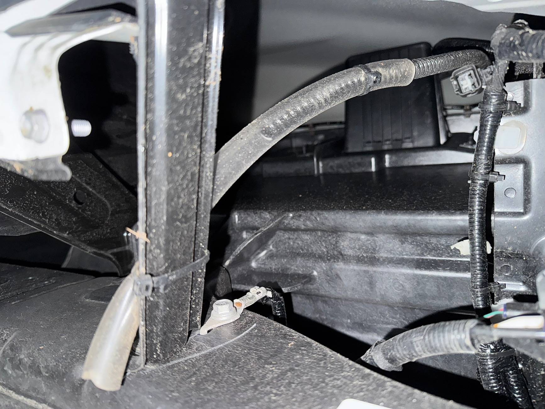

2) Drain System Tubing- This tonneau has gutters that collect water from the sides and front and direct it to drain tubes that need to be routed out of the bed. I drilled holes in the sides at the rear and front of the bed at the front to route water out of the bed. See photos. The rear drain worked perfectly after initial install with no issues. The routing of the front tube put some pre-load on the somewhat rigid tubing leading to canting the flange where the drain tube met the cartridge. This leaked significantly after the first test drive. I ultimately added silicone sealant around where the flange meets the cartridge and the leakage stopped. See photo. Maybe a bit over the top, but I also ran the Pace Edwards tubing through the side wall, then fitted it to 3/4" tygon tubing which I tie-wrapped to truck frame down below the bottom of the body just to make sure I didn't introduce water to any place that wasn't normal for the truck. Each one is a little different, but I added a photo of the drivers rear side wall drain for example.

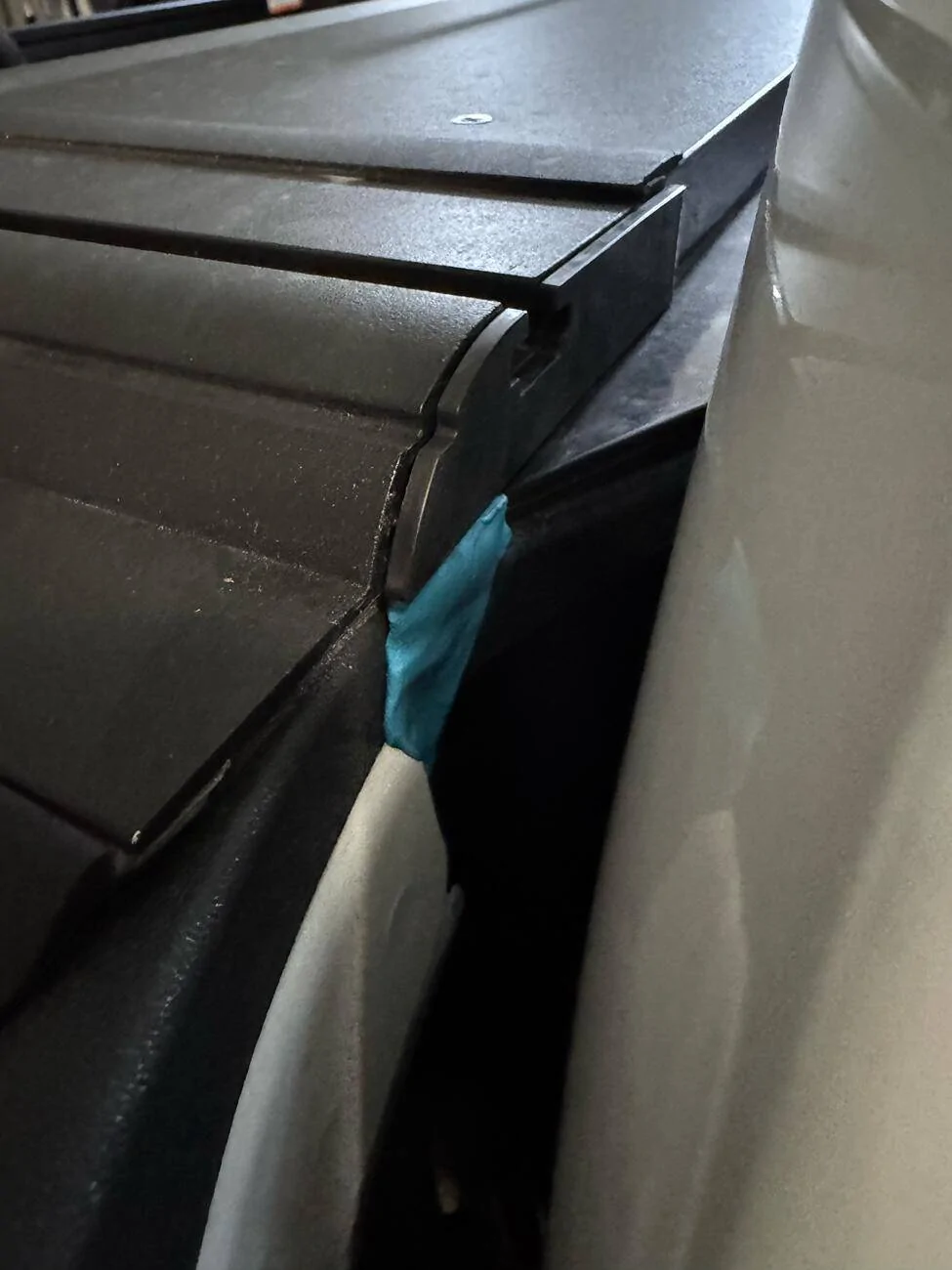

3) Bed Front Corner Leakage - At the front corners of the bed, there is a small gap where the front panel meets the side wall caps. The tonneau does nothing to address this gap, which falls right where wind driven rain will go when driving. I've read online about filling this with RTV, but the photos looked a bit messy due to it being in a hard to access location. Before committing to an effort like that I decided to test with some picture hanging putty I had on-hand. I installed it as shown in the photo. The putty is light blue. This appears to have completely resolved leakage from that point, so if my putty starts to break down, I know where to put some more permanent sealant.
