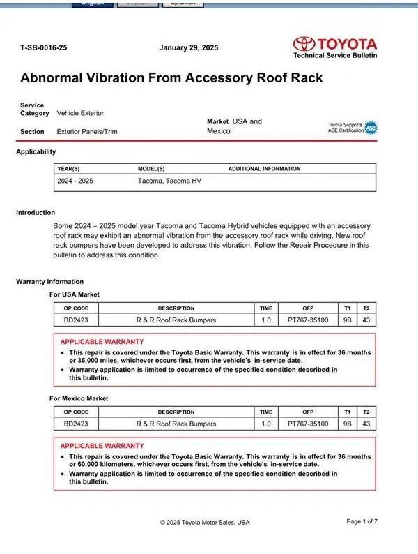

My dealer just called and told me that the parts are in for my roof rack TSB.. going in on Monday morning so I hope that solves the issue."will post results after the fix.

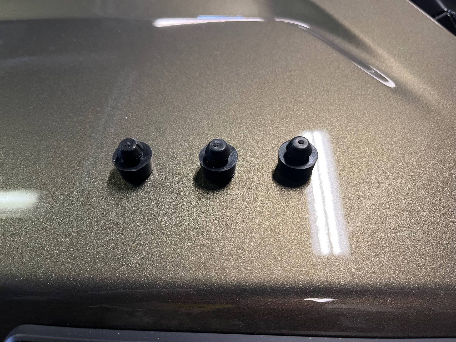

Went to my dealer this morning to get the roof rack TSB done.. no more vibrations at all." Got the truck up on the freeway over 70 and no vibration any more. They change out 3 rubber buttons with longer ones and re-torque everything. These are what they replace
