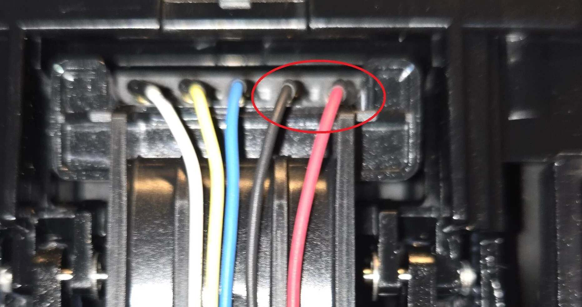

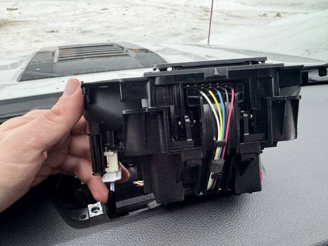

Like a lot of you I am not a fan of the JBL center speaker and prefer that it is silent, but still charging.
I pulled the speaker and its enclosure out of the dash to see what I was dealing with. I'll let the pictures do the talking...
2024 Tacoma Attempt at Charging the Center JBL Speaker without Hearing it... 1738121630928-zz

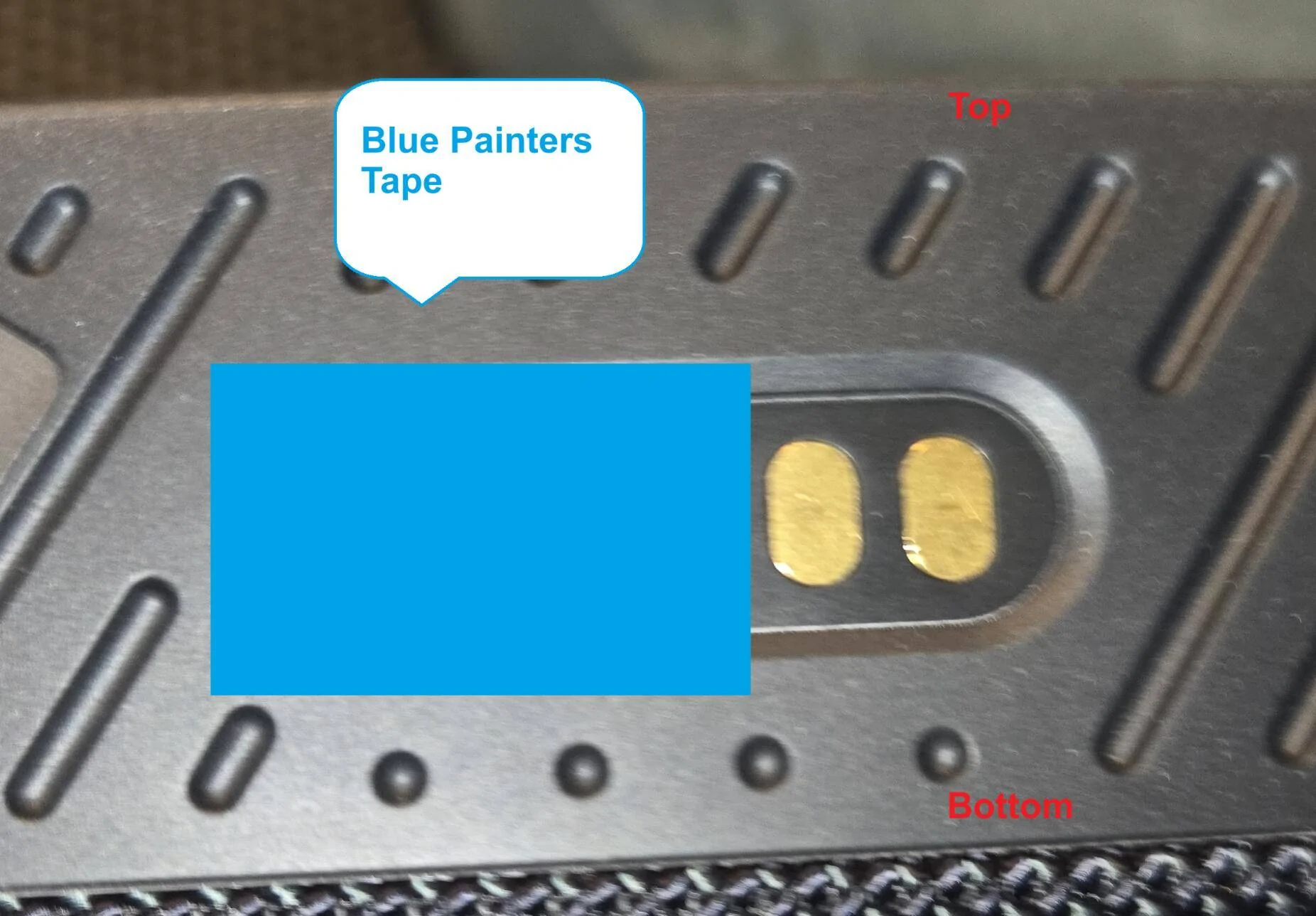

Blue painters tape over the audio connection leaving the positive and negative connections only.
2024 Tacoma Attempt at Charging the Center JBL Speaker without Hearing it... 1738121837840-a6
I'll report back after testing for a few months.
