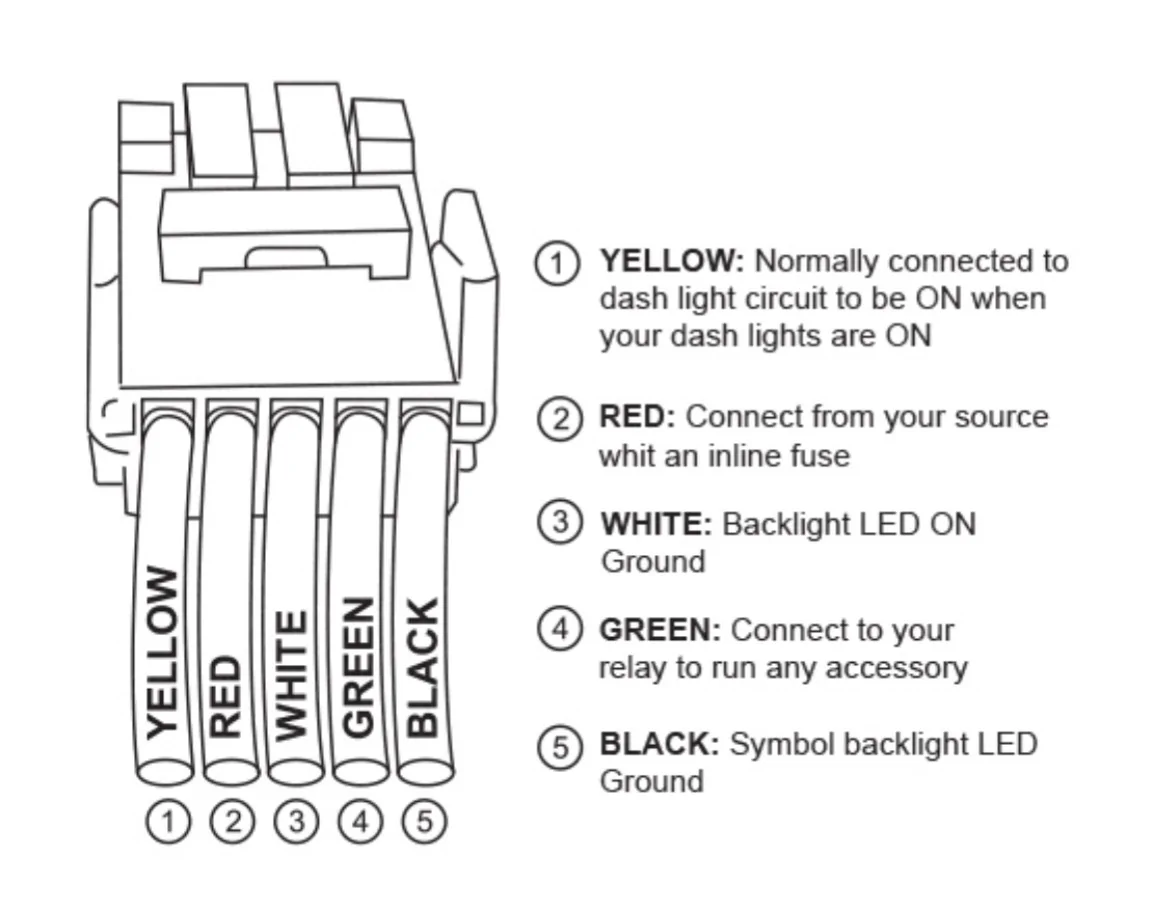

I'm wondering if anyone with the 3 factory AUX buttons has a picture of the back side of their factory AUX button wiring they're willing to share so I can see what wires and how many wires connect to each button.
I have spare wires back behind the dummy dash buttons and am trying to figure out if they're for AUX buttons or something else because I have everything else, including fuses/wiring/connectors for pigtails under-hood/bed, but am missing the dash buttons and the Denso relays under the hood - but the relay/fuse spots are wired into the cabin harness.

Switches are on page 3.

While Ididn't have the buttons themselves, I did have the button wiring. Take a look at the photos in my post on installing a heritage grille without aux. You'll see pictures of the backside of the dash button panel (if that's what you're looking for)
