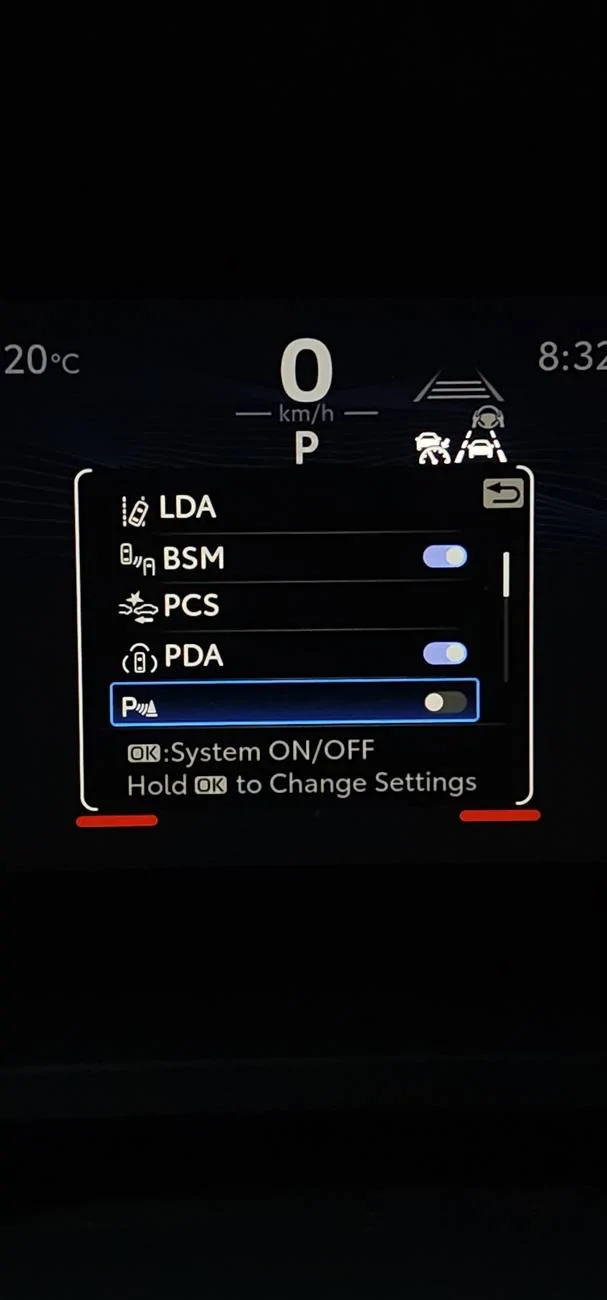

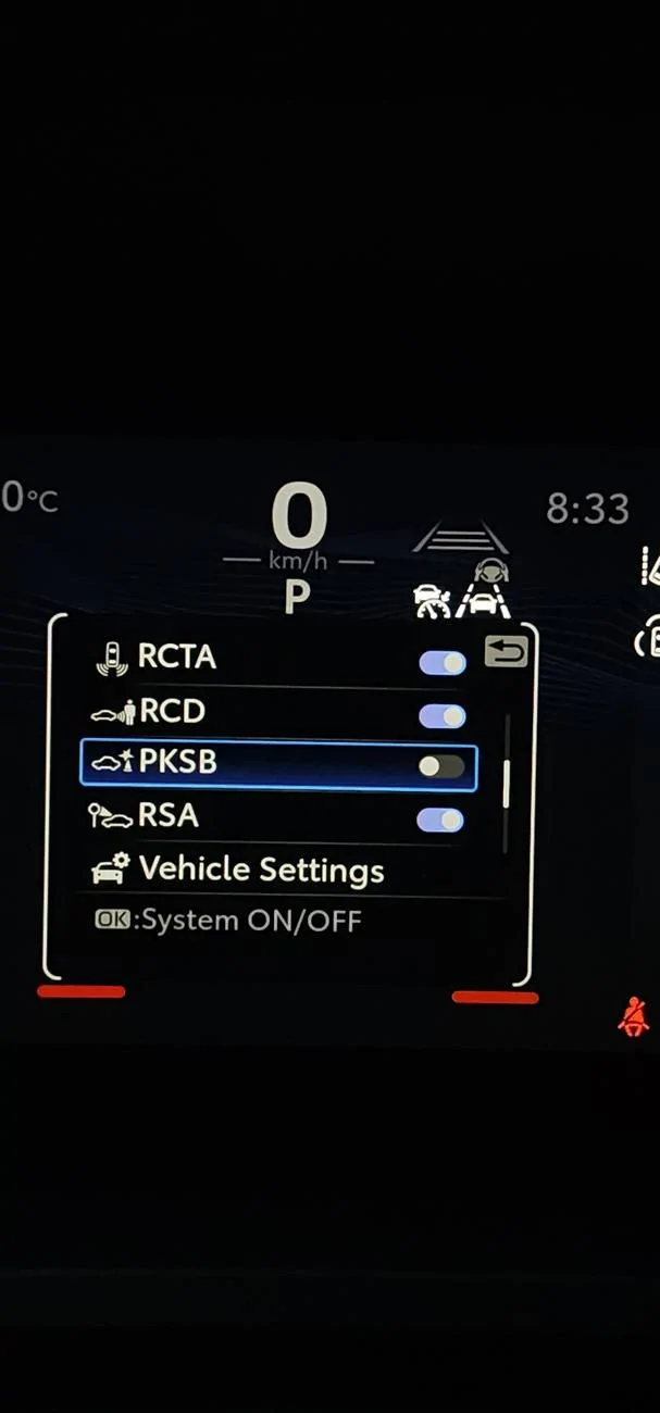

Had the same issue when I installed my hitch bike rack and I disabled these 2 things in the settings and it's been fine and not asking about a trailer.

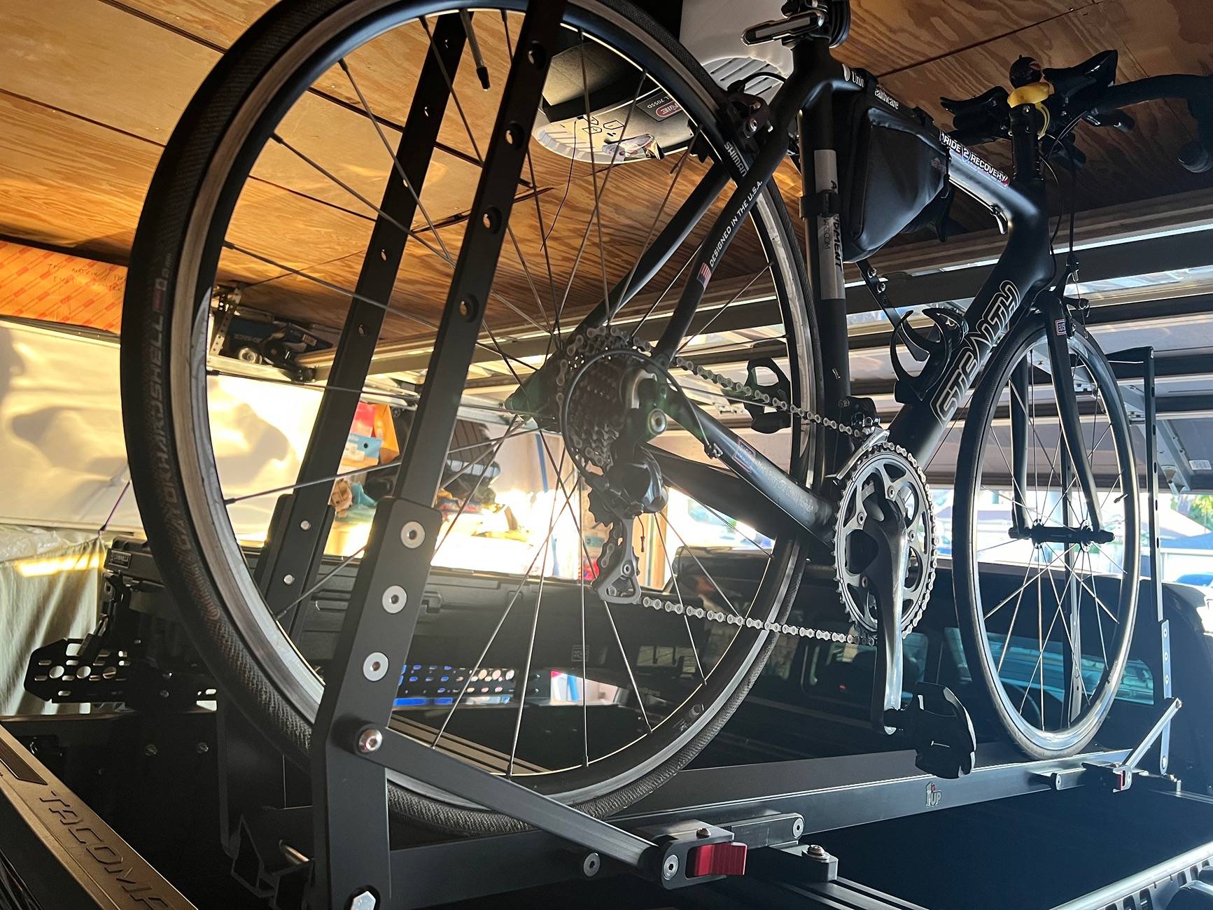

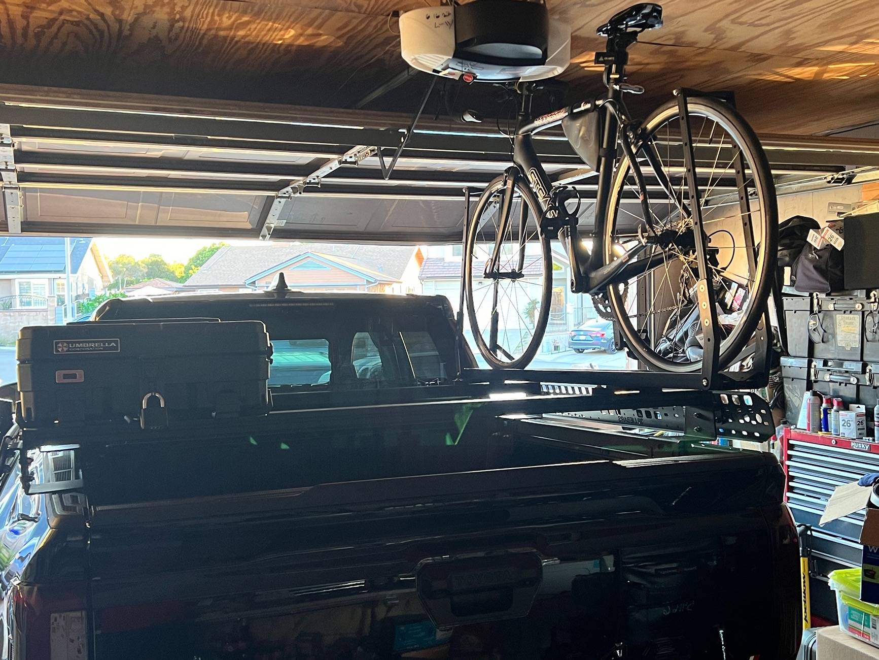

Ive got the 1up super duty but it’s mounted on to billie bars
