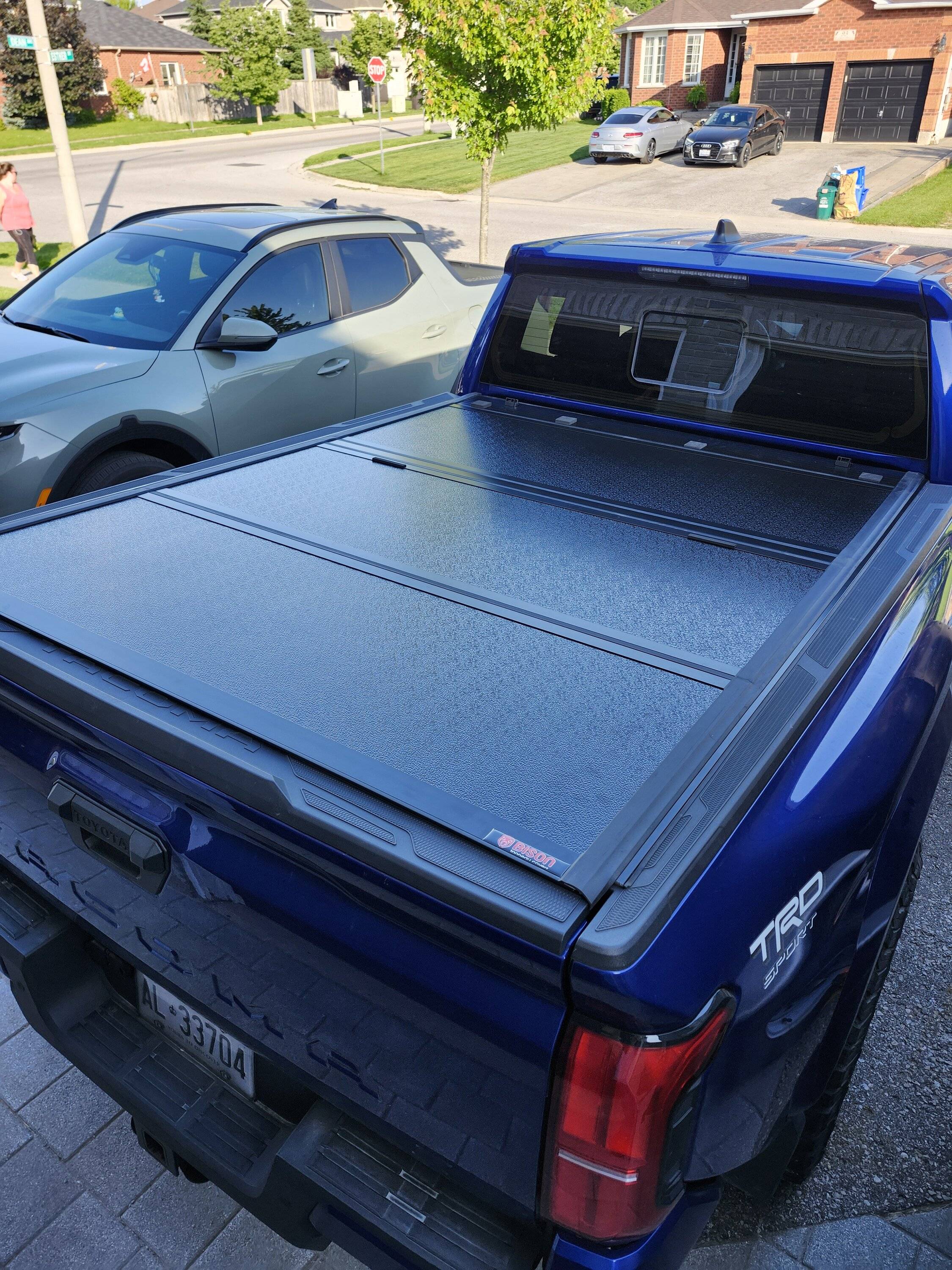

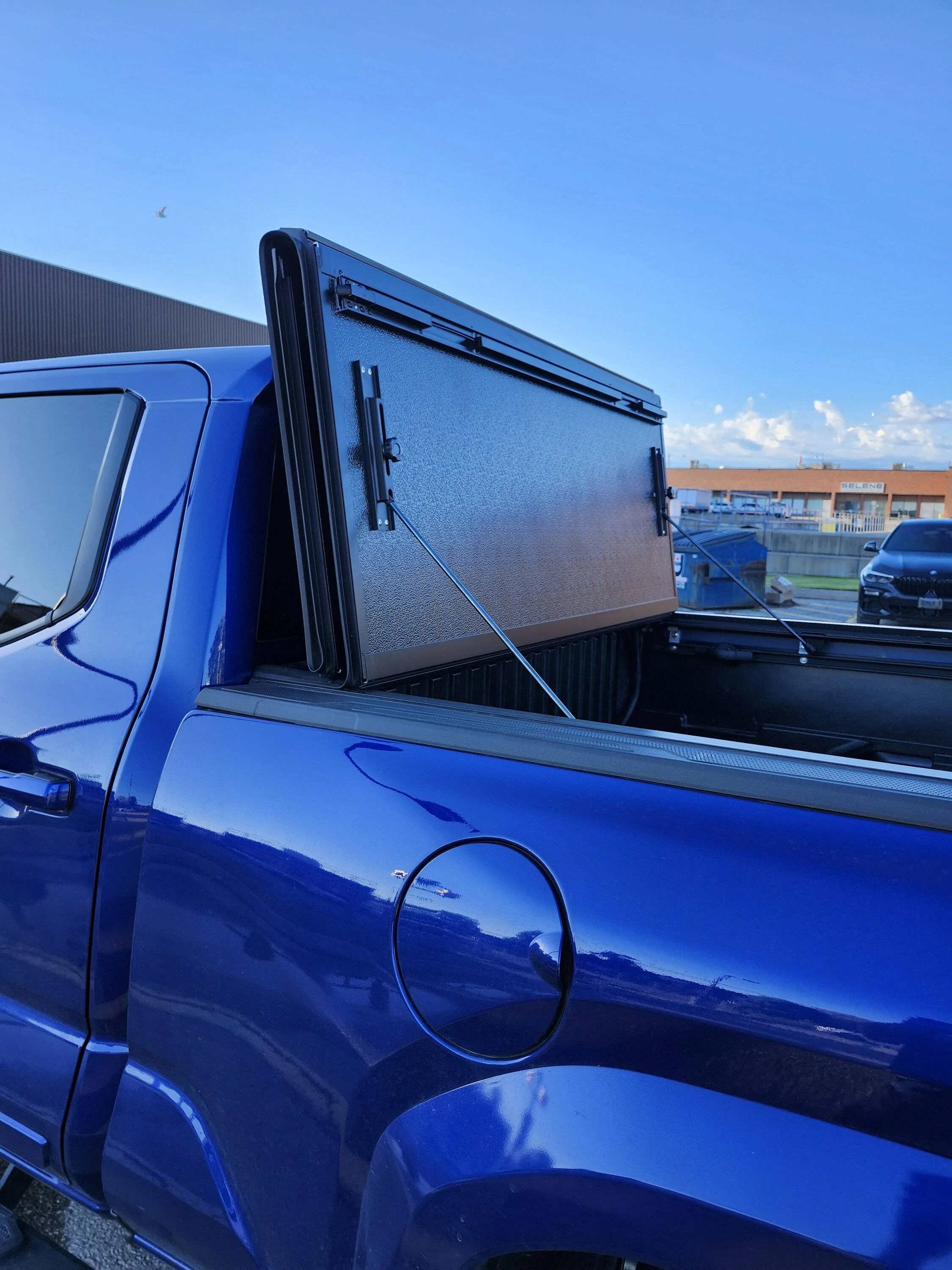

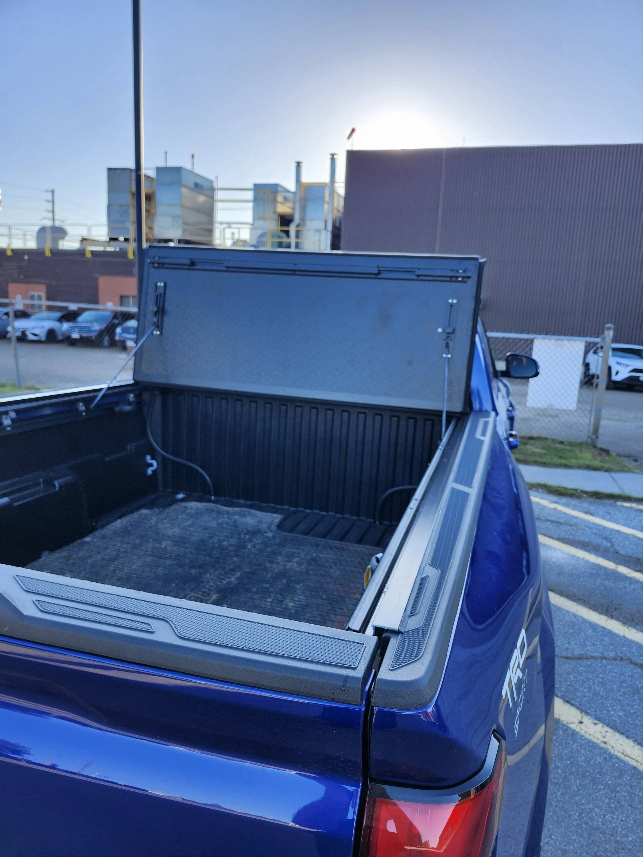

Couple pics of my Bison Hard flip cover. (679.00 Canadian.) Fits pretty good. Instructions not the best. Looks like it seals up good. Time will tell quality.

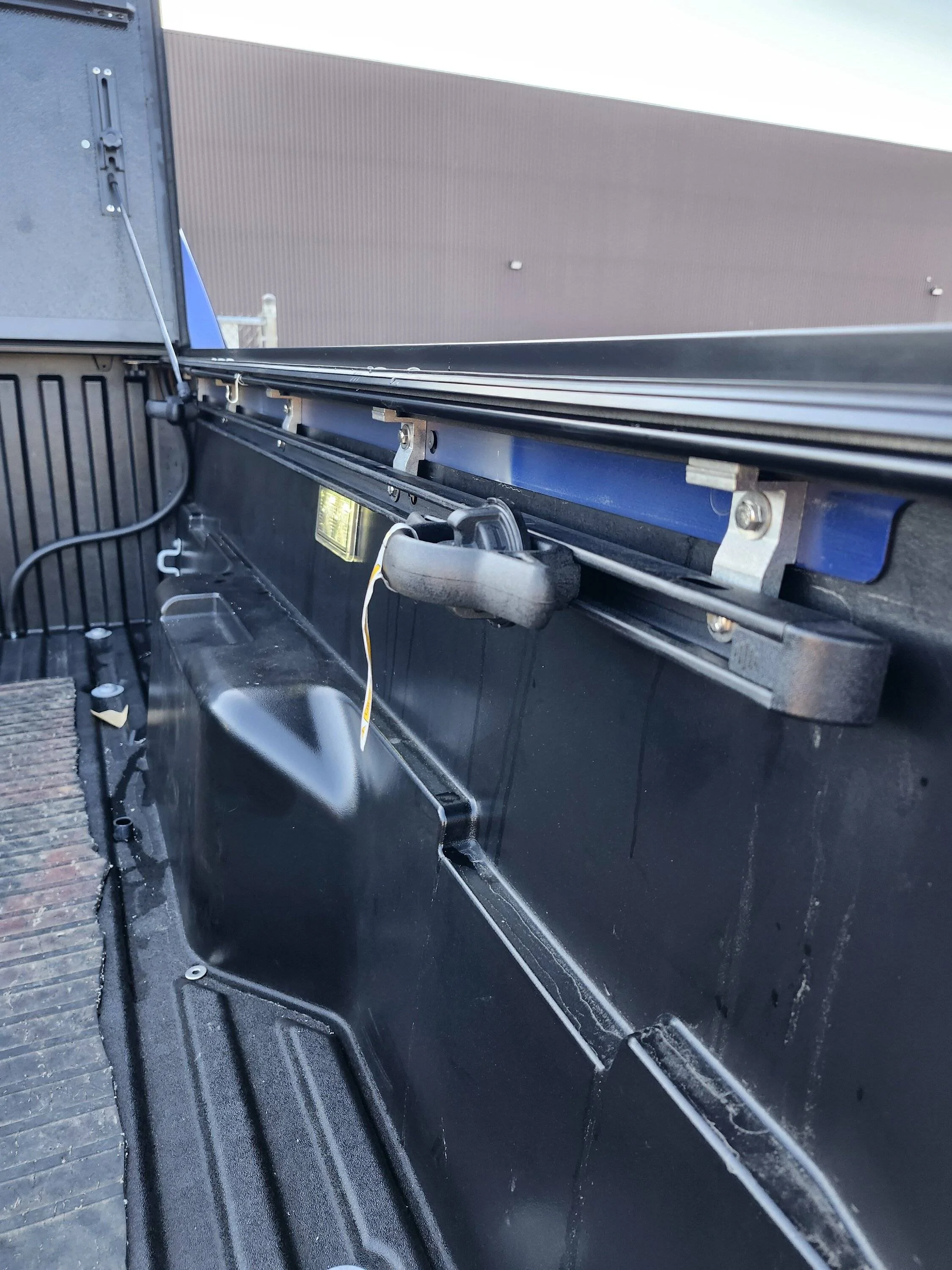

I guess you removed all four bed-cleats.
2024 Tacoma Bison Tonneau Cover (6 foot) installed 1718339235166
How you tie down without bed-cleats when you carry high and big stuffs?

Oh the bed cleats are there, the bed rail gets re attached to the new cover brackets and I can then use the bed cleats if nessesary. ( to be honest I've had a Tacoma for a least 5 years and have never used the bed cleat....I always used the d rings)

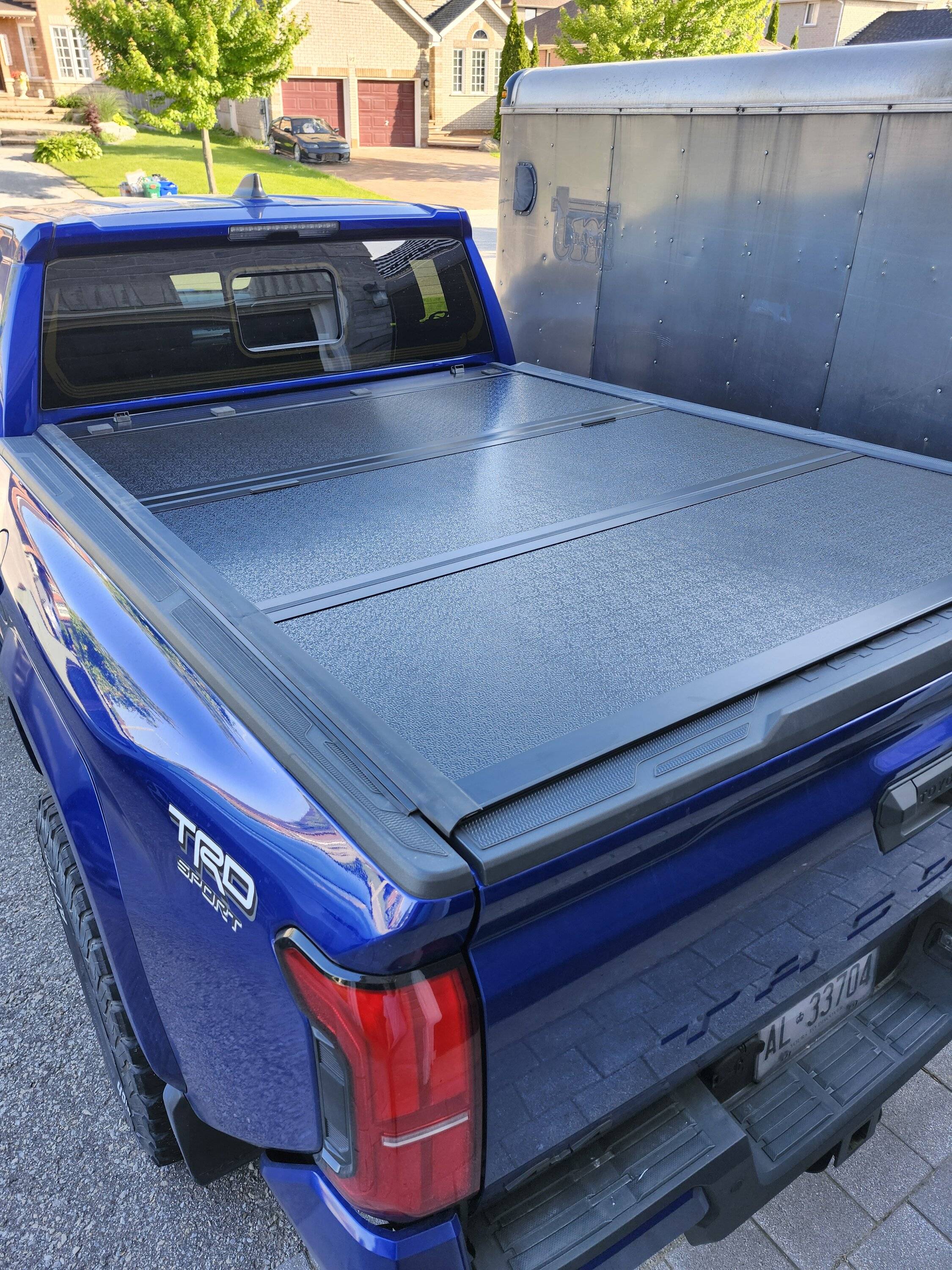

2024 Tacoma Bison Tonneau Cover (6 foot) installed 20240614_070021
2024 Tacoma Bison Tonneau Cover (6 foot) installed 20240614_070030
Installed it the same as you had it shown in the one pic of inside the box
Hey there, ya the side rails can be tricky. I lined up and started all the fasteners on the side rail and slowly put tension against the box side. The rubber lip seal on the top underside can be the issue. Once you have the lip against the box, carefully and slowly using a small flat screwdriver work the lip on to the top of the box by sliding the driver under the seal. You want that seal on top of the plastic bedside. There are some YouTube videos or if you are close to Bison they do free Installs. Let me know if I can help further. Cheers
