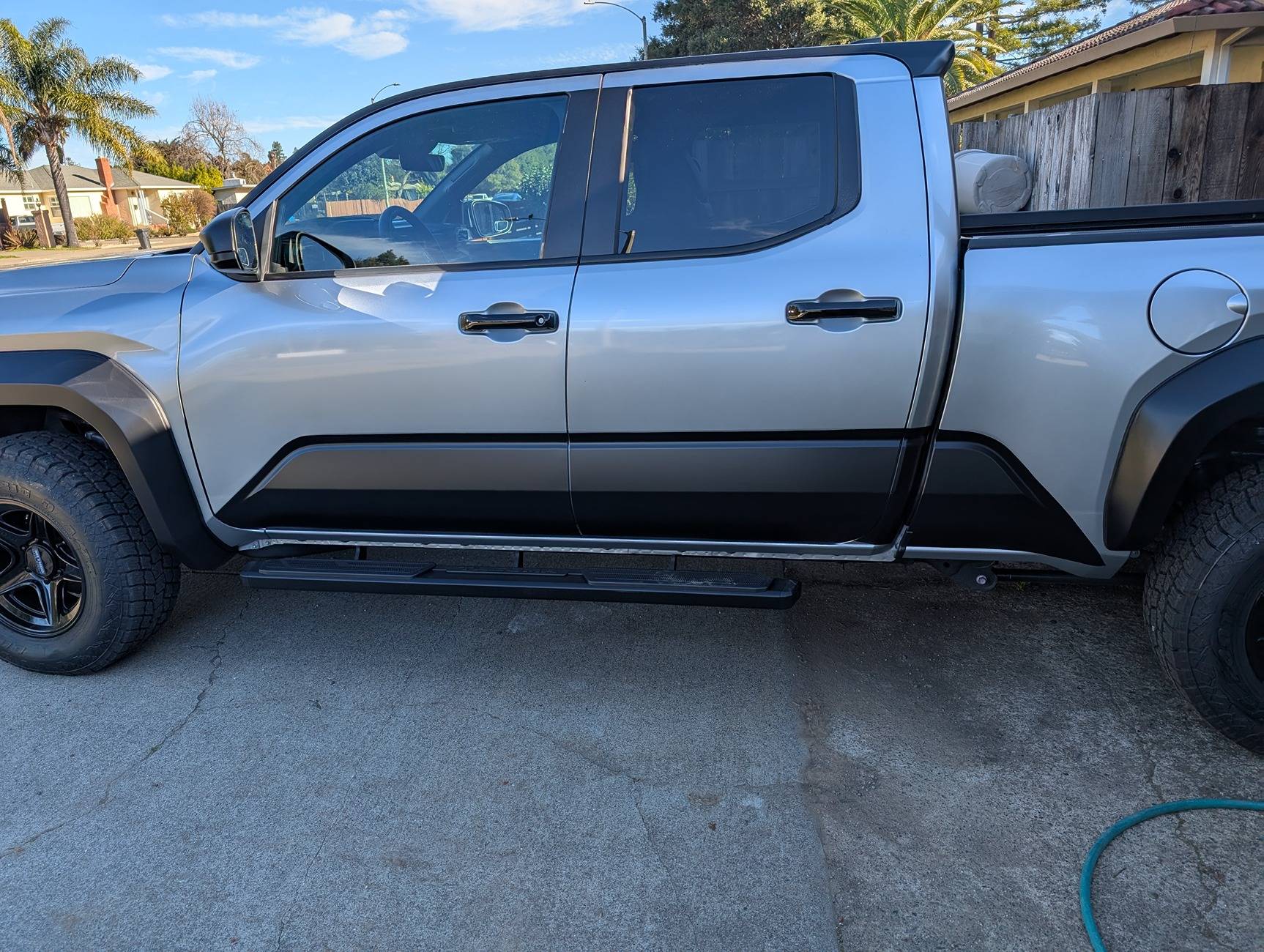

$55 r unpainted with a high gloss black color that exactly matches the color of all the stock exterior plastic but gloss not mat which as u can see looks bad a$$
Any color Tacoma would look great with black handles & mirrors
oem style u remove the stock ones with heat , stuck on with what looks like hot glue , pull the 3m strips off the new & stick on .covers the whole handle & is Not a cover it is a replacement as have to remove the stock cover
if I had not done the wrap I would have replaced the mirror covers as well and probably will anyway down the line as those r the same finish
wrap guy wanted $200 for the handles to b wrapped , the Rave $55 & they came 3 days after ordering. usa company too !

I've yet to find one that isn't a crappy looking vinyl sticker on a black or chrome overlay. Fully painted or bust
yeah the Rave handles look exactly like the stock ones in every way , even the packaging looked oem . I was very very happy with them & will get the mirror pieces as well. The handles r mostly steel under these covers a very stout looking assy

Assuming you have a limited so it just covers up the chrome?
No that's a RS5 the mirrors & door handles were painted celestial silver . It's a rwd long bed kinda rare bird . I dont need a 4 wheeler anymore , pavement princess 4 sure :cool:
