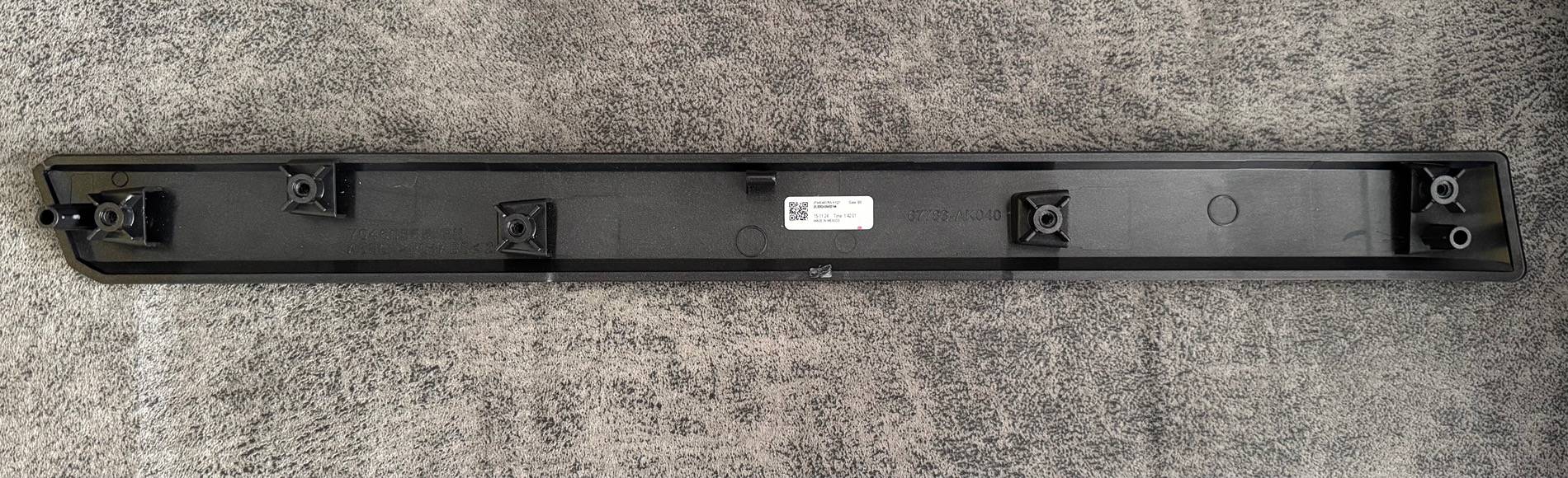

The doors, you slide them towards the font of the truck. I start at the edge of the door and just push towards the dash and they come off. They will break if you use the trim tool

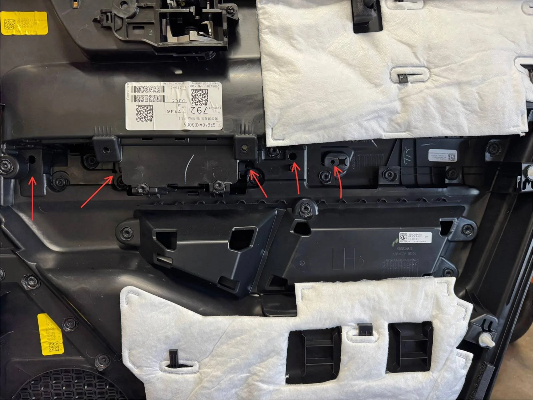

Front door trim seems to slide right off like you said and got those off easy, but I haven't been able to take off the back door trim. Any specific location to pry from on the back door trim?

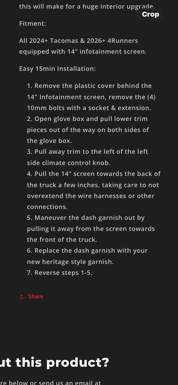

Taco Tunes 2024 Tacoma powered subwoofer install video on you tube has demonstration of 14” screen removal.

I'm definitely going to wrap mine. It's the bright blue color trim on mine. Trouble is getting the trim off. I have the two front doors figured out and the trim to the left of the steering wheel, but the back two doors and trim around the screen are giving me trouble.
