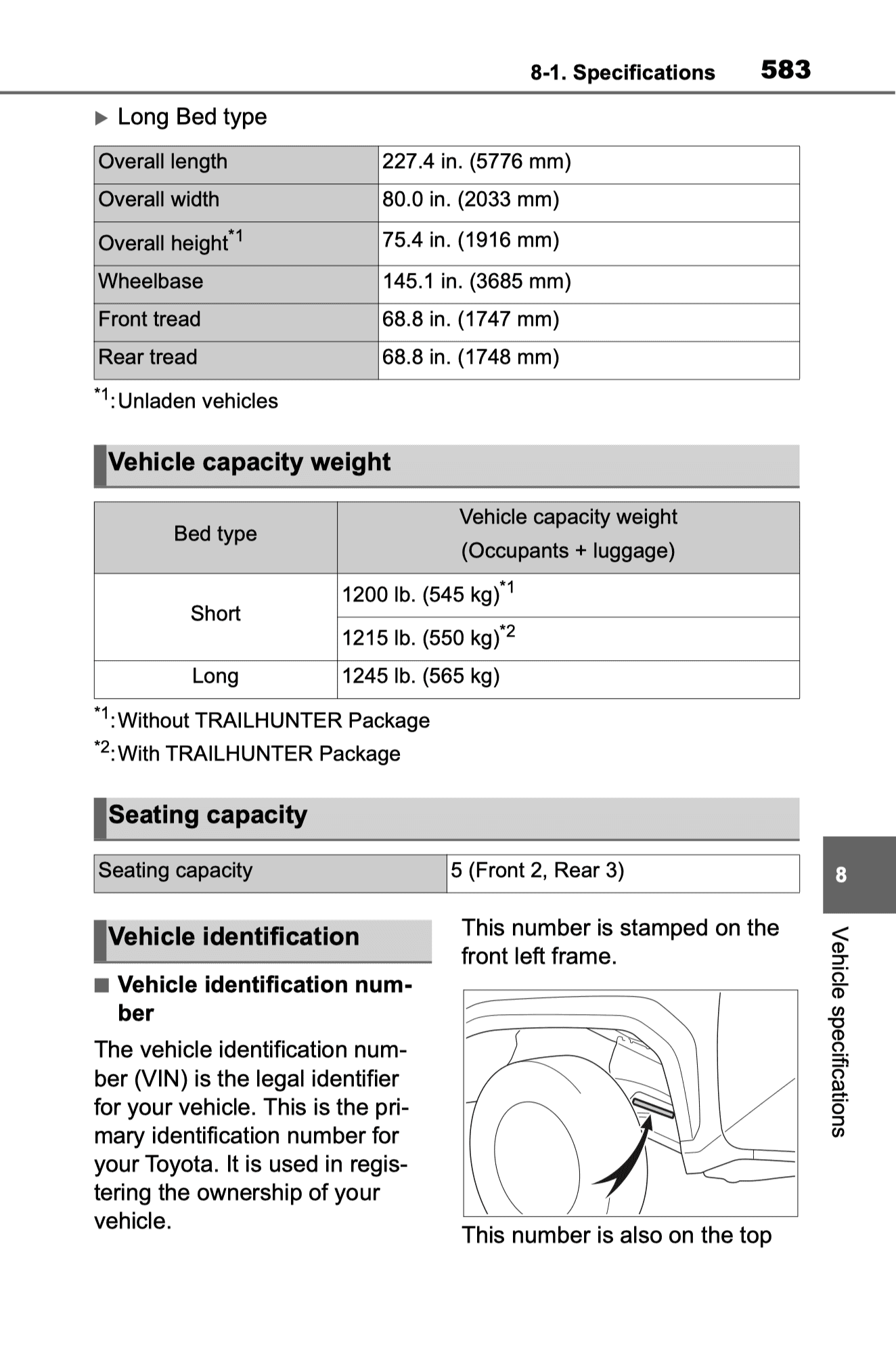

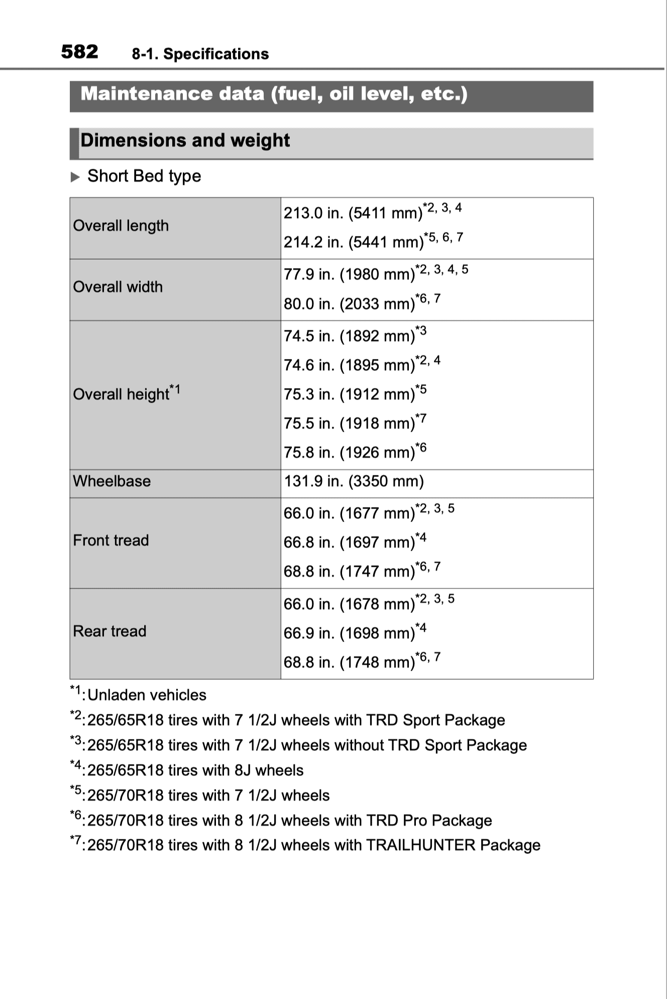

Figured i'd post interesting pages from the Hybrid manual for more visibility.
265/70R18 tires with 8 1/2J wheels with TRD Pro Package
  • Overall Length - 214.2 in. (5441 mm)
  • Overall Width - 80.0 in. (2033 mm) *
  • Overall Height - 75.8 in. (1926 mm)
  • Wheelbase - 131.9 in. (3350 mm)
  • Front Tread - 68.8 in. (1747 mm)
  • Rear Tread - 68.8 in. (1748 mm)
265/70R18 tires with 8 1/2J wheels with TRAILHUNTER Package
  • Overall Height - 75.5 in. (1918 mm)
  • Load Capacity Weight (Short Bed) - 1,215 LBS (550 KG) vs 1,200 LBS (non-Trailhunter short bed)

I’m now concerned officially. I’m getting a TRD Off-road hybrid and was under the impression payload would be the 1709lbs figure that has been discussed. Am I hearing that only Trailhunter and pro hybrids can take the 1709lbs payload. Me Confused.
No, the Trailhunter also can't take the 1709lbs. That was a preliminary figure. It is now 1215 or 1245 per above (depending on bed length). Pro will be 1200.
So looks like there really isn’t any significant payload differences with hybrid or all gas versions.
Shame on Toyota.
