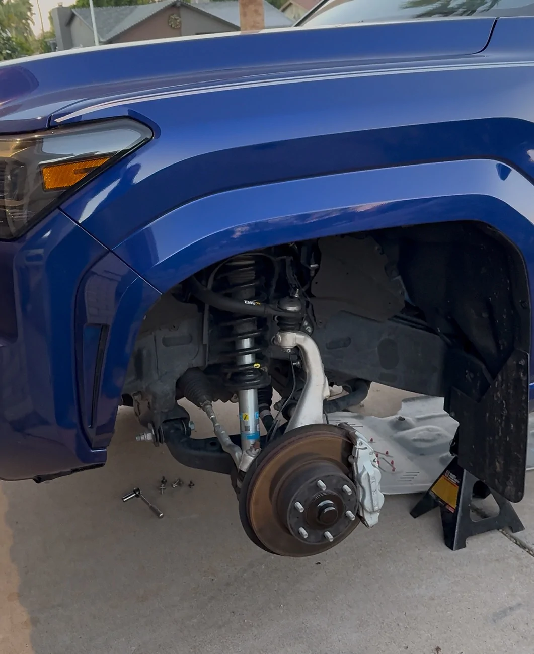

I know there are plenty of YouTube videoed on this, but here’s what to expect for the install of the ECGS diff carrier bushing on my 2024 SR5. If you aren’t familiar, all the 4wd Tacomas from second gen (something like that.. feel free to correct me) onward use an idler needle bearing to support the CV on the drivers side. When the truck isn’t in 4wd, the cv turns against this needle bearing and when the front is raised at all, to where the CVs are at any downward pitch, you will feel a vibration at street and highway speeds through the steering wheel due to the side loading on the not so tight tolerance between the shaft and bearing. Here’s the step by step of it.

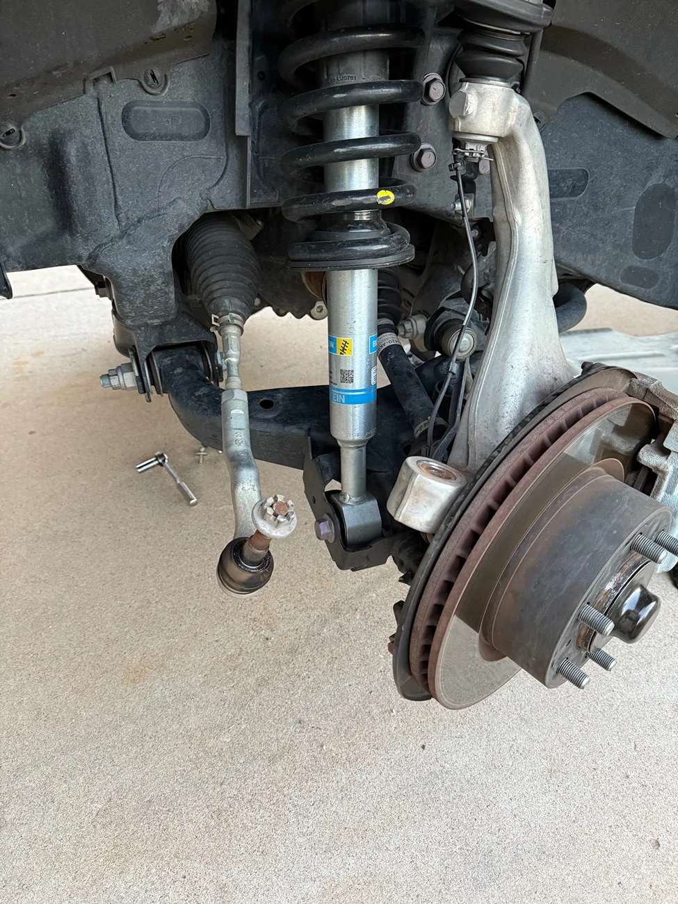

2024 Tacoma East Coast Gear Supply diff bushing DIY install (step by step how-to) IMG_1188
Separate tie rod end.
2024 Tacoma East Coast Gear Supply diff bushing DIY install (step by step how-to) IMG_1155

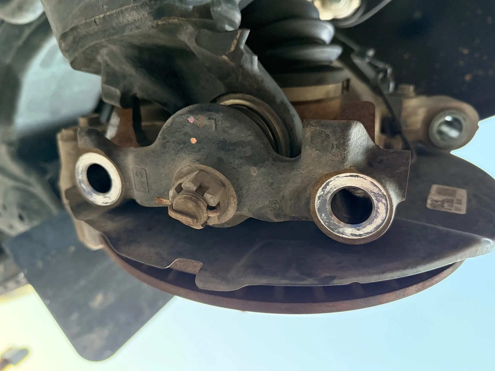

Remove lower mounting bolts holding lower ball joint assembly to spindle.

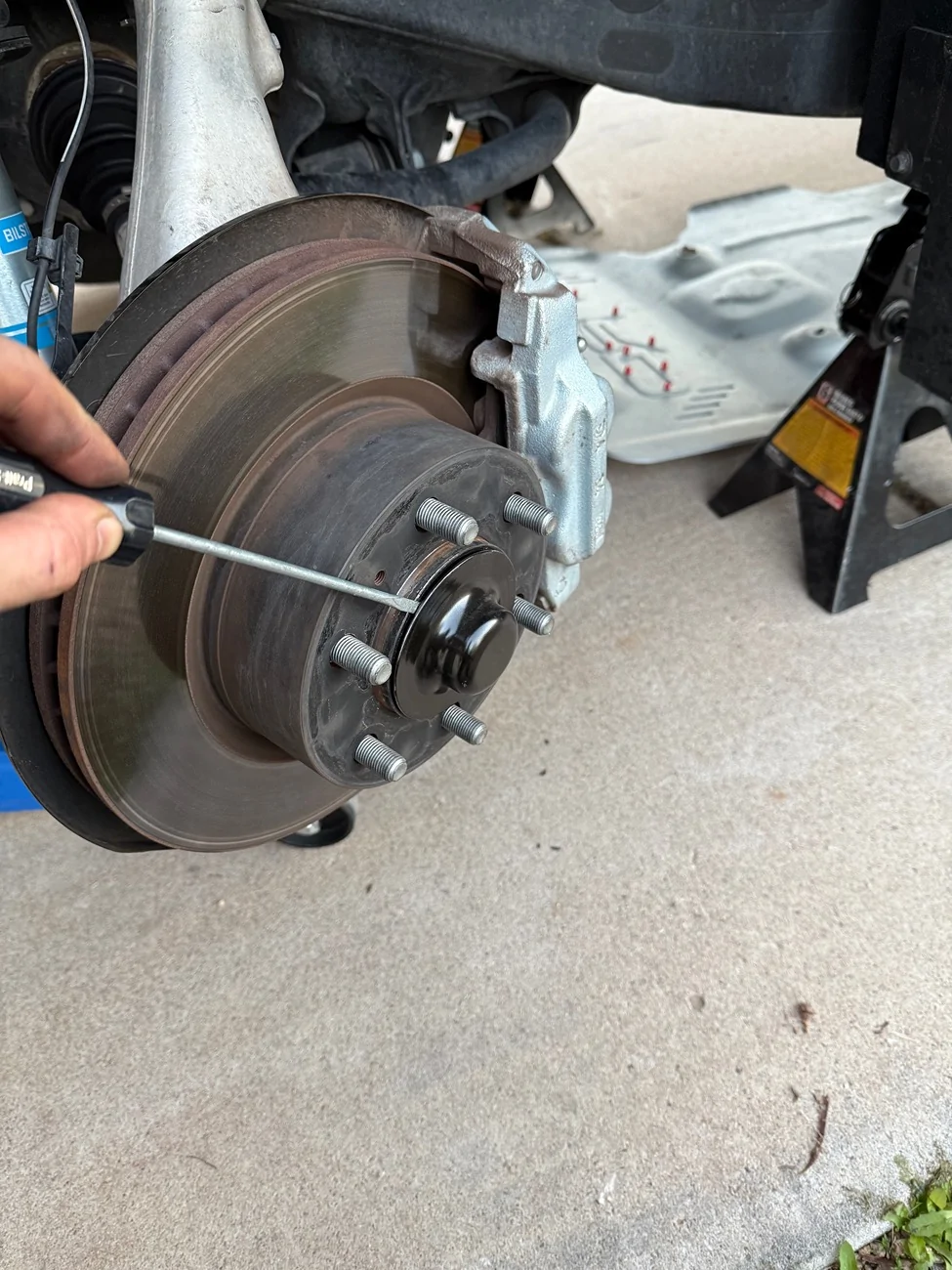

Remove dust cap from hub.

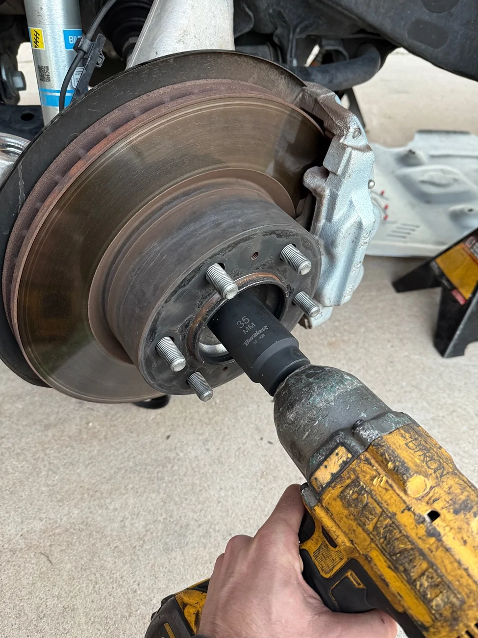

2024 Tacoma East Coast Gear Supply diff bushing DIY install (step by step how-to) IMG_1158

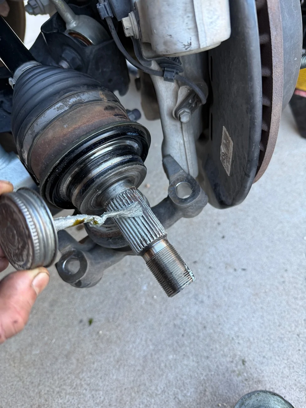

Remove CV nut using 35mm socket, then separate CV from spindle

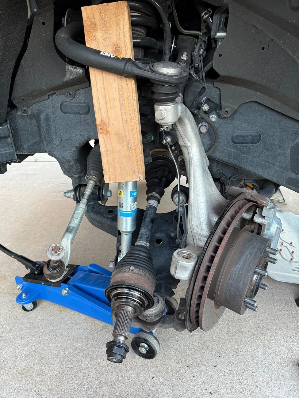

2024 Tacoma East Coast Gear Supply diff bushing DIY install (step by step how-to) IMG_1159
Prop or tie the spindle out of the way and be mindful of the brake lines/speed sensors wire.

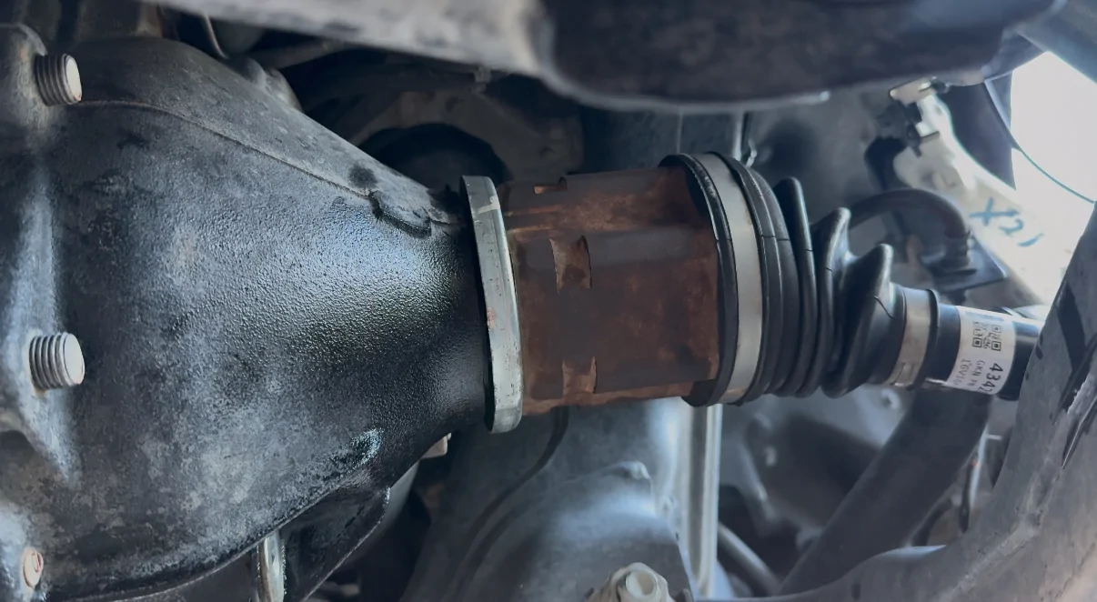

2024 Tacoma East Coast Gear Supply diff bushing DIY install (step by step how-to) IMG_1160

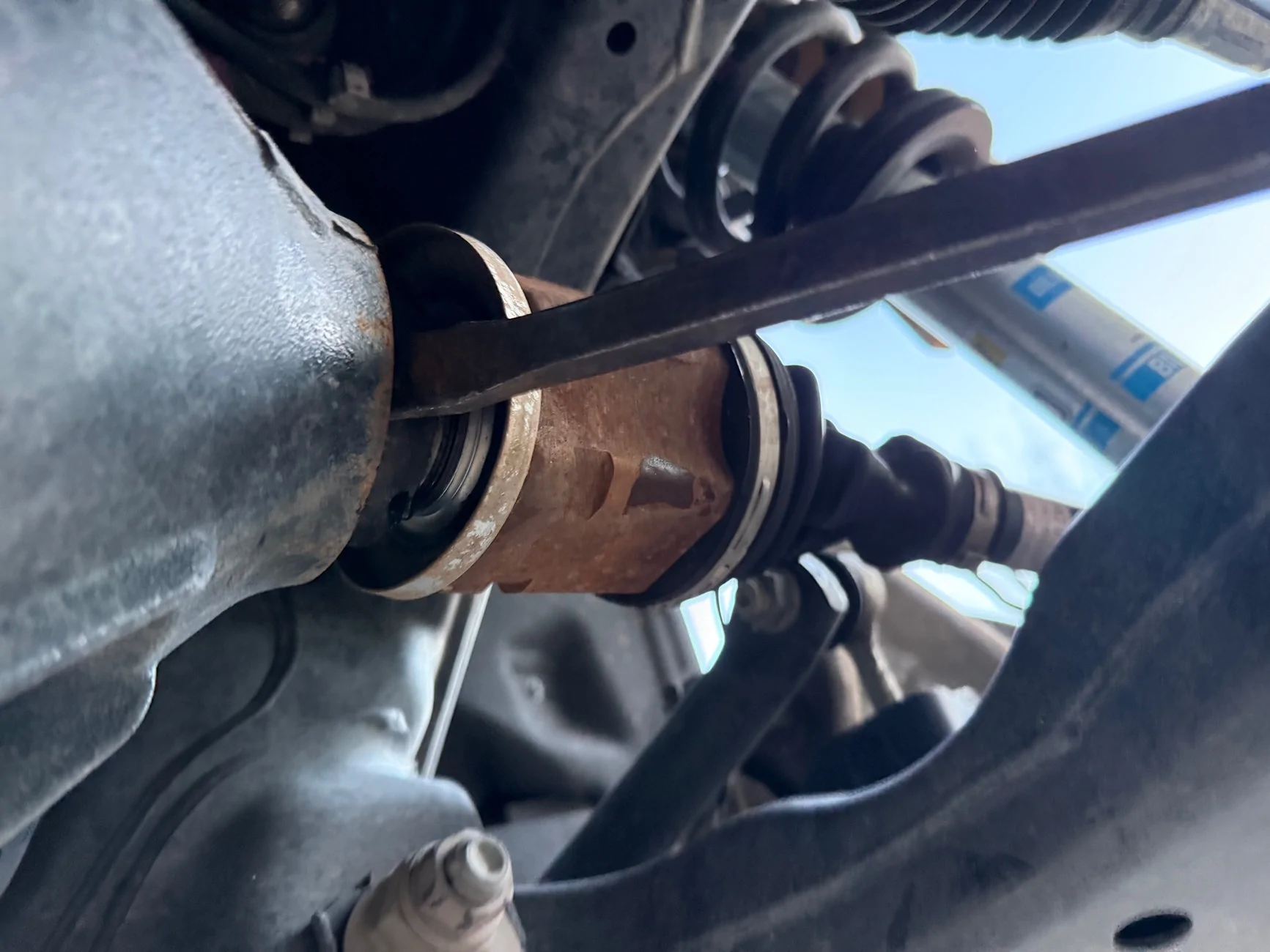

Pry the cv out, be careful of the dust shields but these can be straightened if bent.

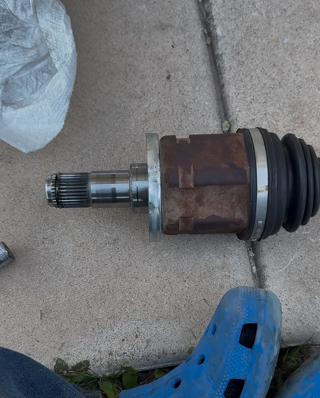

2024 Tacoma East Coast Gear Supply diff bushing DIY install (step by step how-to) IMG_1161

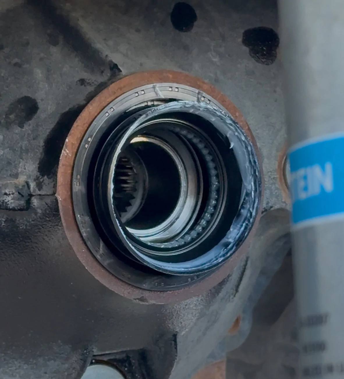

Despite the loud vibration, the shaft surface against the needle bearing is in great shape.

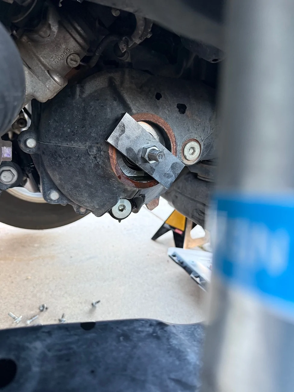

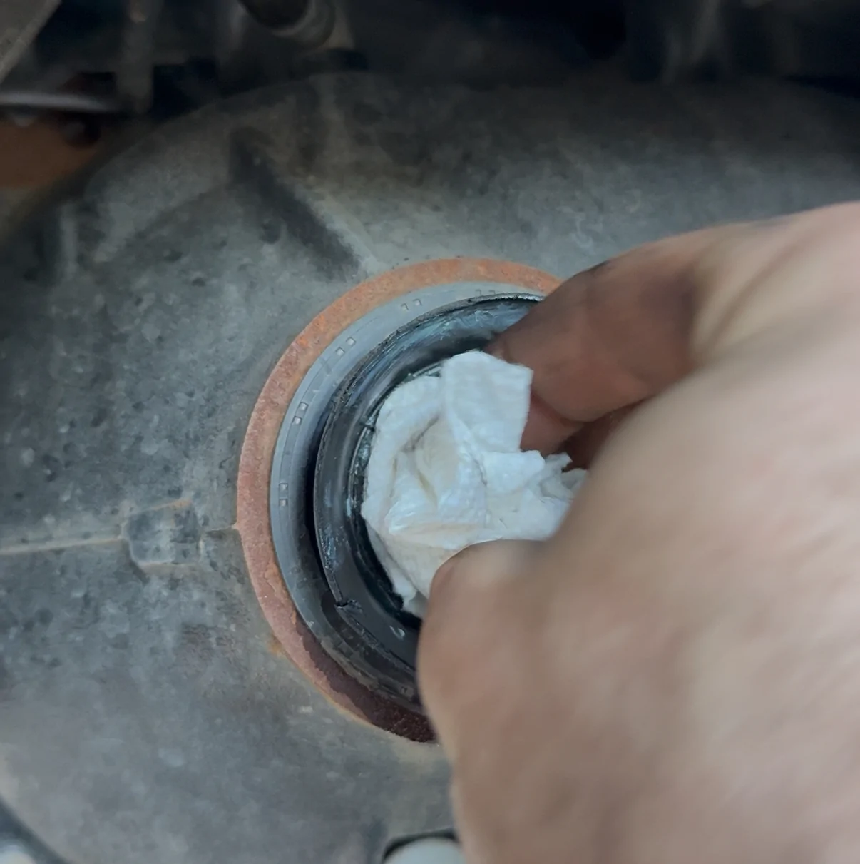

2024 Tacoma East Coast Gear Supply diff bushing DIY install (step by step how-to) IMG_1190
Insert paper towel or plastic bag into splines to prevent extracting tool from falling into diff.

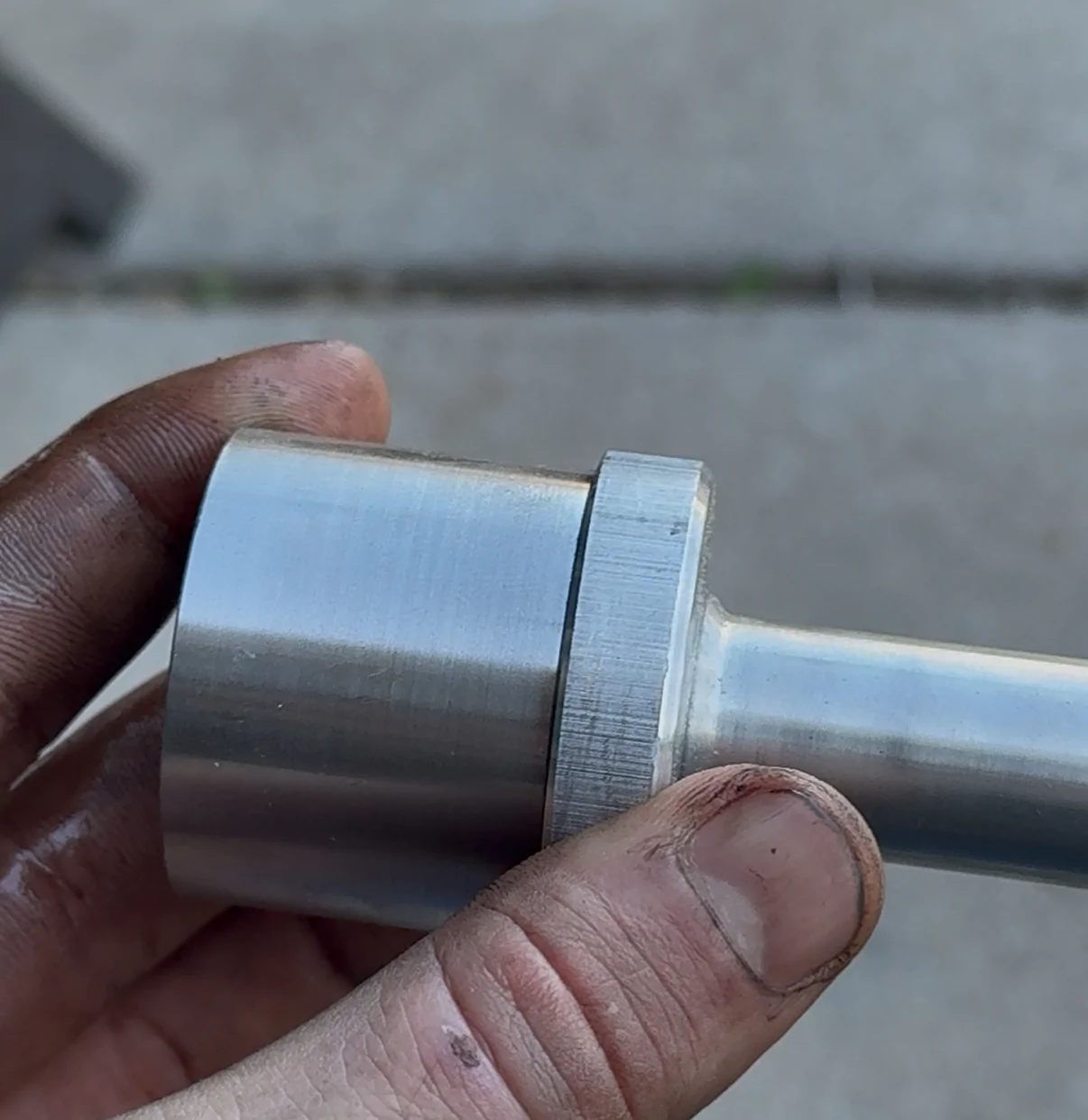

2024 Tacoma East Coast Gear Supply diff bushing DIY install (step by step how-to) IMG_1189

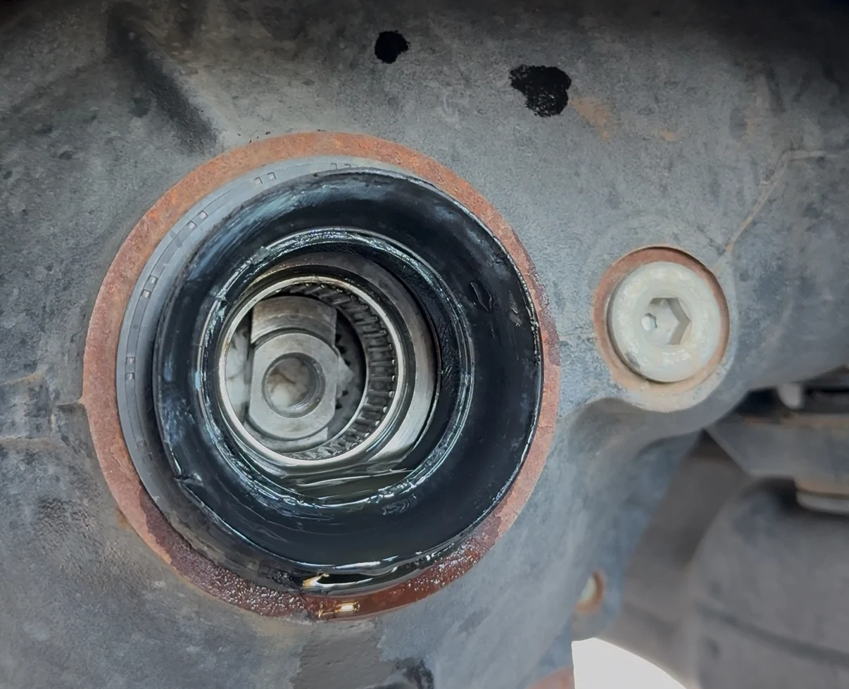

Set slotted nut from extractor tool in behind needle bearing(I had to slightly bevel the edge to get it in easily.
2024 Tacoma East Coast Gear Supply diff bushing DIY install (step by step how-to) IMG_1187
After popping the oil seal out, thread in the all-thread and plate making sure the slotted nut is seated only against the needle bearing and pull it out. You will run out of length and need to put supportive backing between the plate and the diff to get it all the way out.

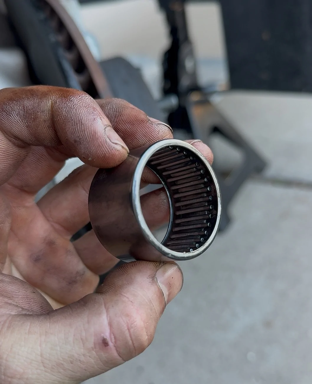

2024 Tacoma East Coast Gear Supply diff bushing DIY install (step by step how-to) IMG_1168
No damage found on my needle bearing thankfully despite the intensity of the vibration.

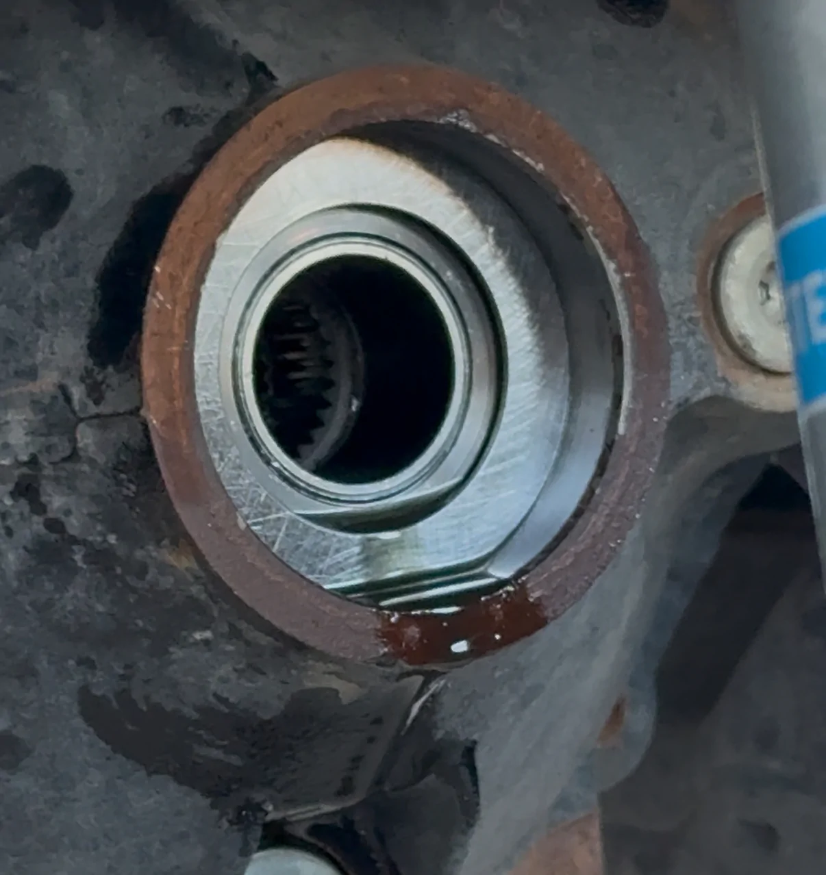

Using the driver, take your time lining up the bushing and pound it in. The driver will bottom out when it is flush.
2024 Tacoma East Coast Gear Supply diff bushing DIY install (step by step how-to) IMG_1192
The bushing should look like this when correctly seated.
