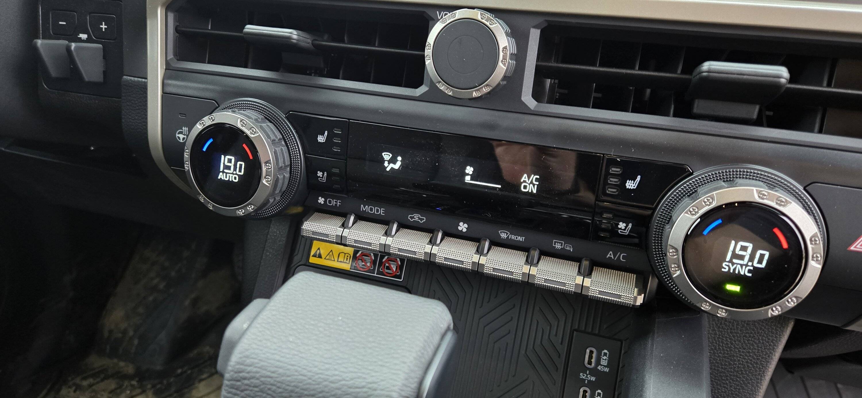

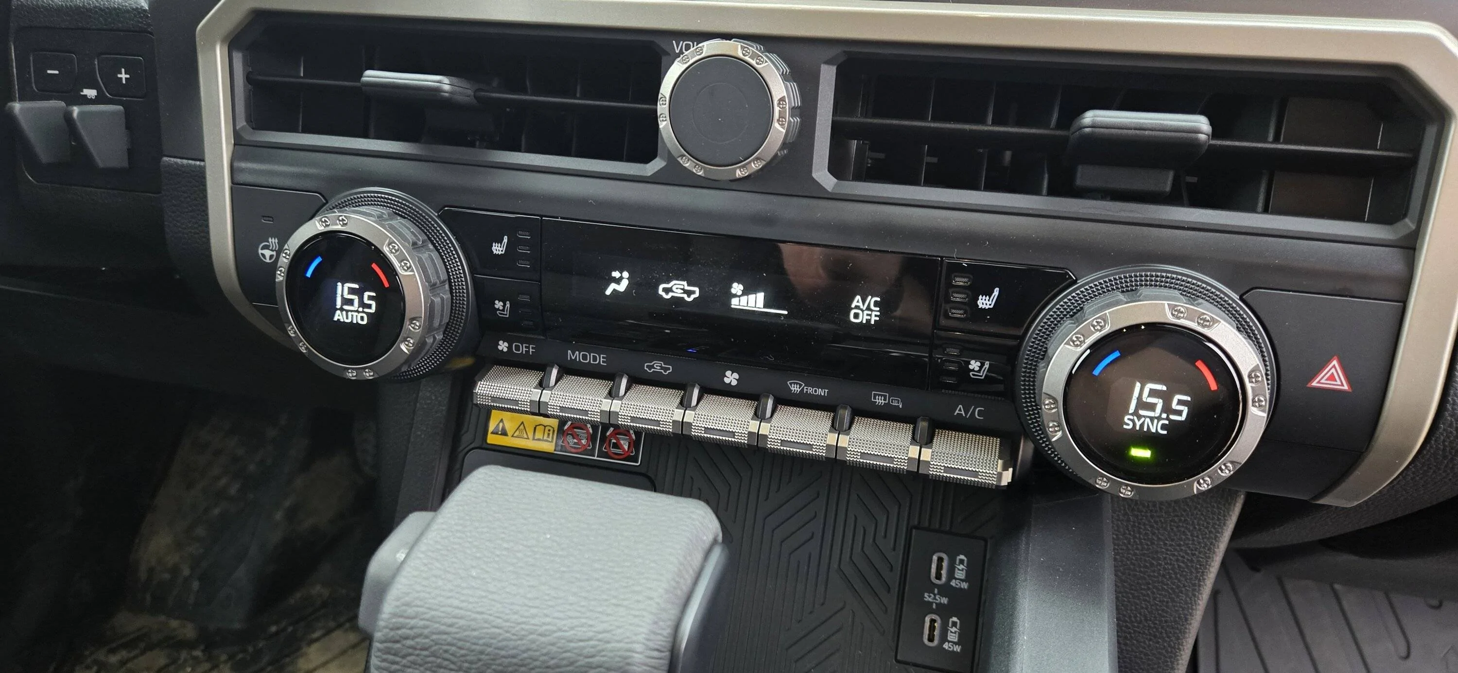

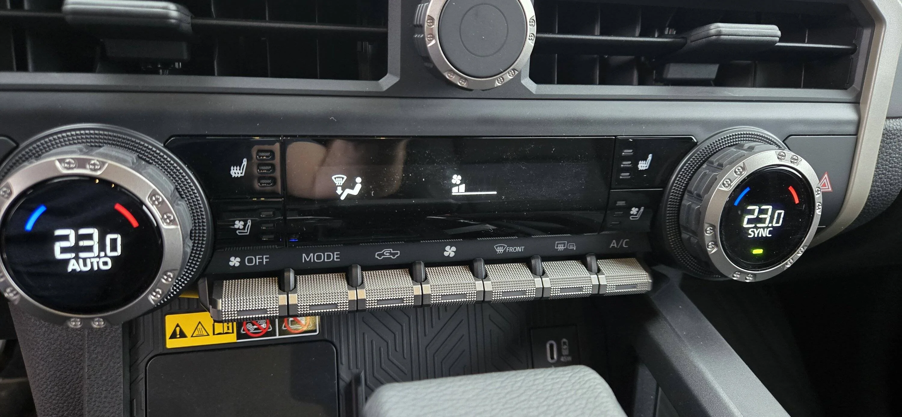

Just checked mine. Pump seems to only kick in when on defrost or AC ON. U guys notice if u start truck on right side is dosent say AC ON or OFF. Rad fan starts to cycle though right away in very short bursts.
