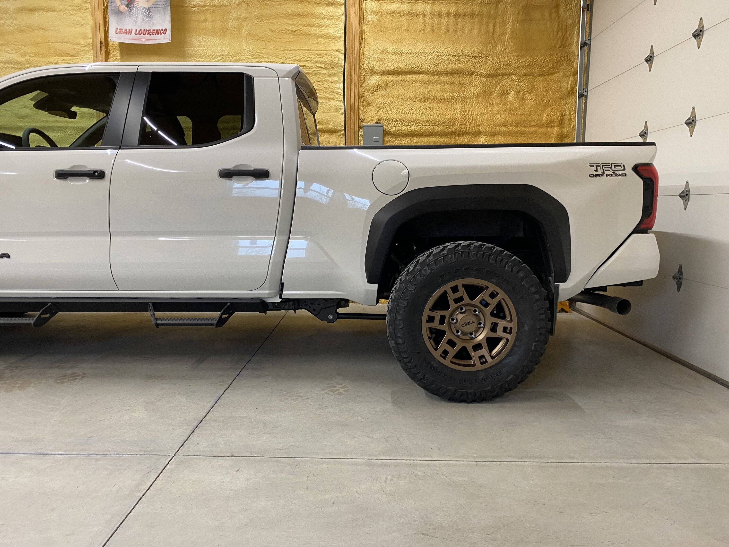

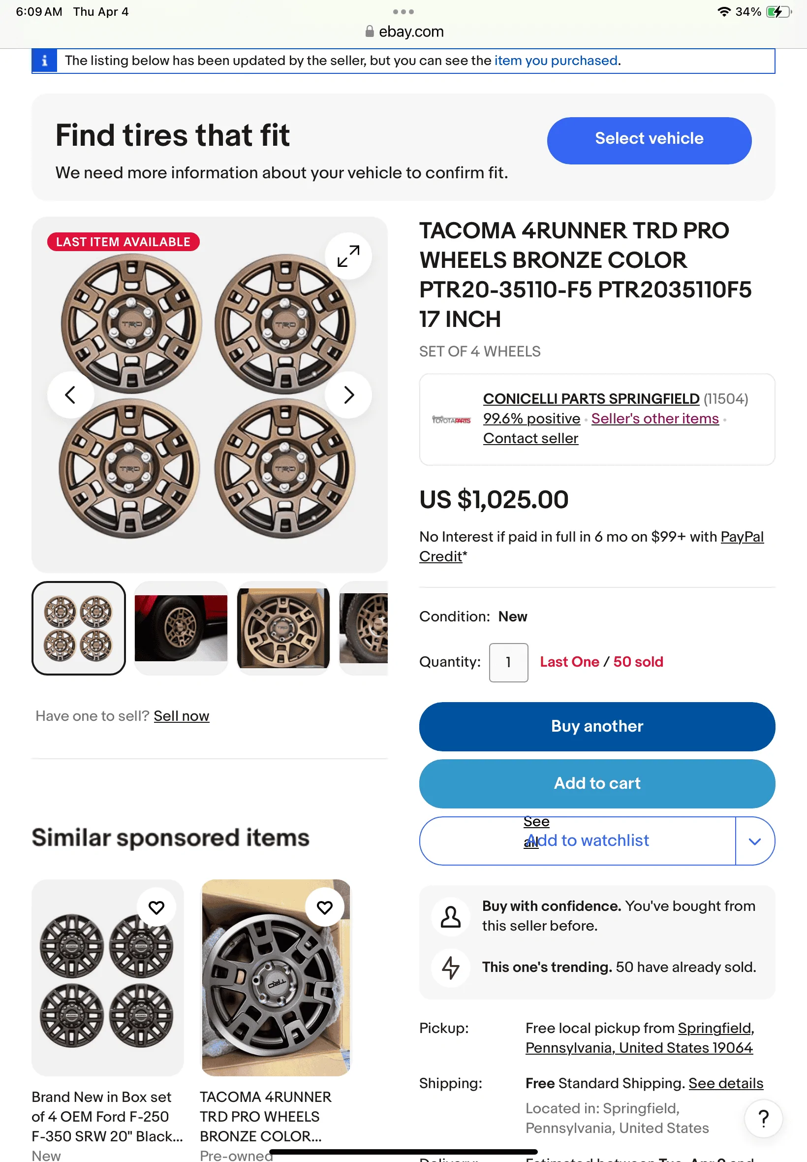

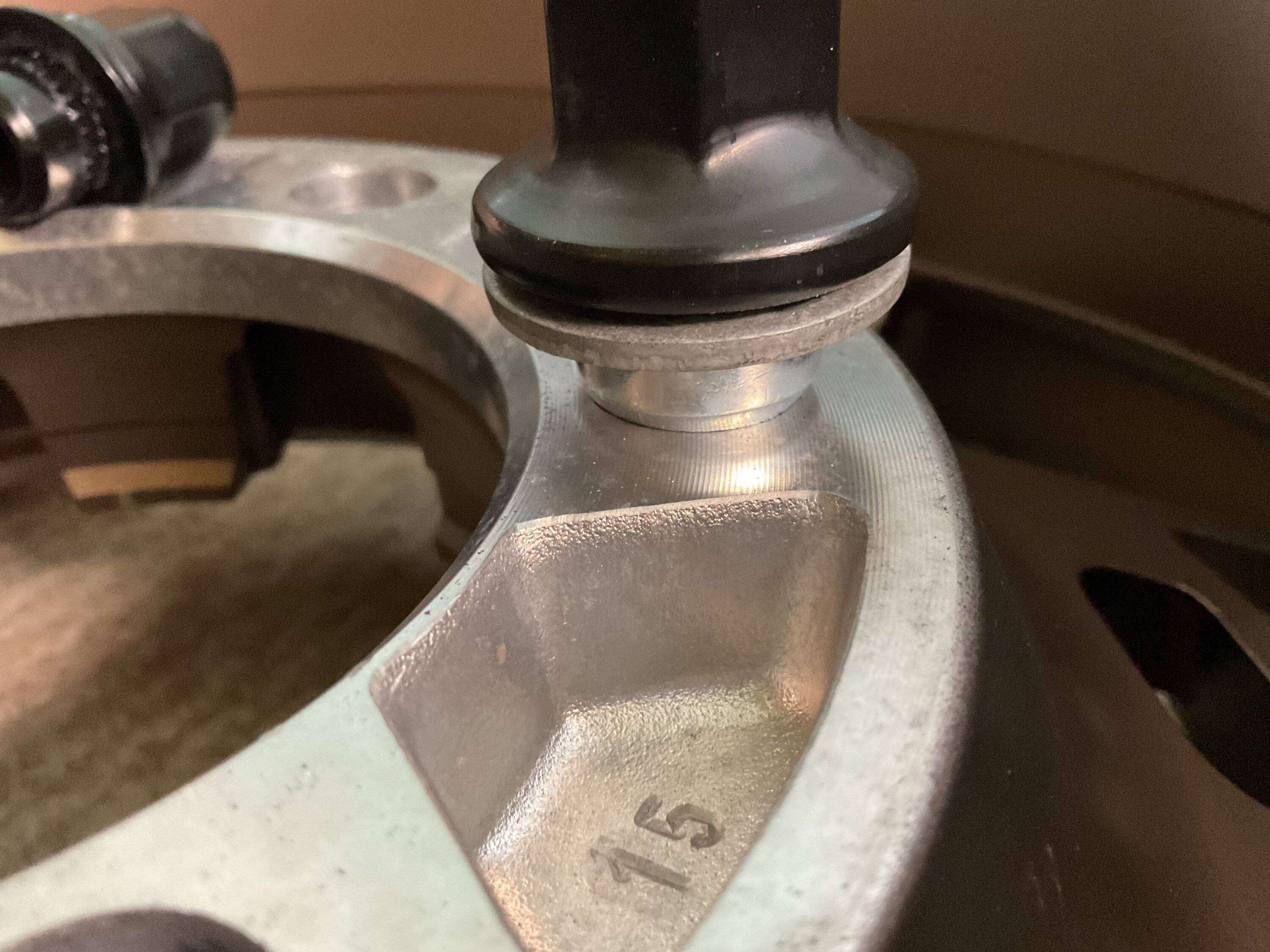

I bought my wheels on eBay from a Toyota dealer in Pennsylvania. No problem at all. They have all the colors if you search. I did one thing different than most. I went 255/75/17. Some refer to them as pizza cutters. They are narrow compared to what most are doing. But true 32 inches tall. I did this mainly because I want as little poke as I can with these wheels. These wheels offset is not ideal for the 4g in my opinion. I ordered the lug nut I showed in this thread a little ways back, but they showed up the wrong color (chrome). Black ones are shipped and I’m waiting for them to arrive to get them mounted on the truck. The picture of the wheel next to my truck is just sitting there not mounted so not accurate proportions. Hopefully I’ll have the lug nuts by the weekend and I’ll share my final report asap.
