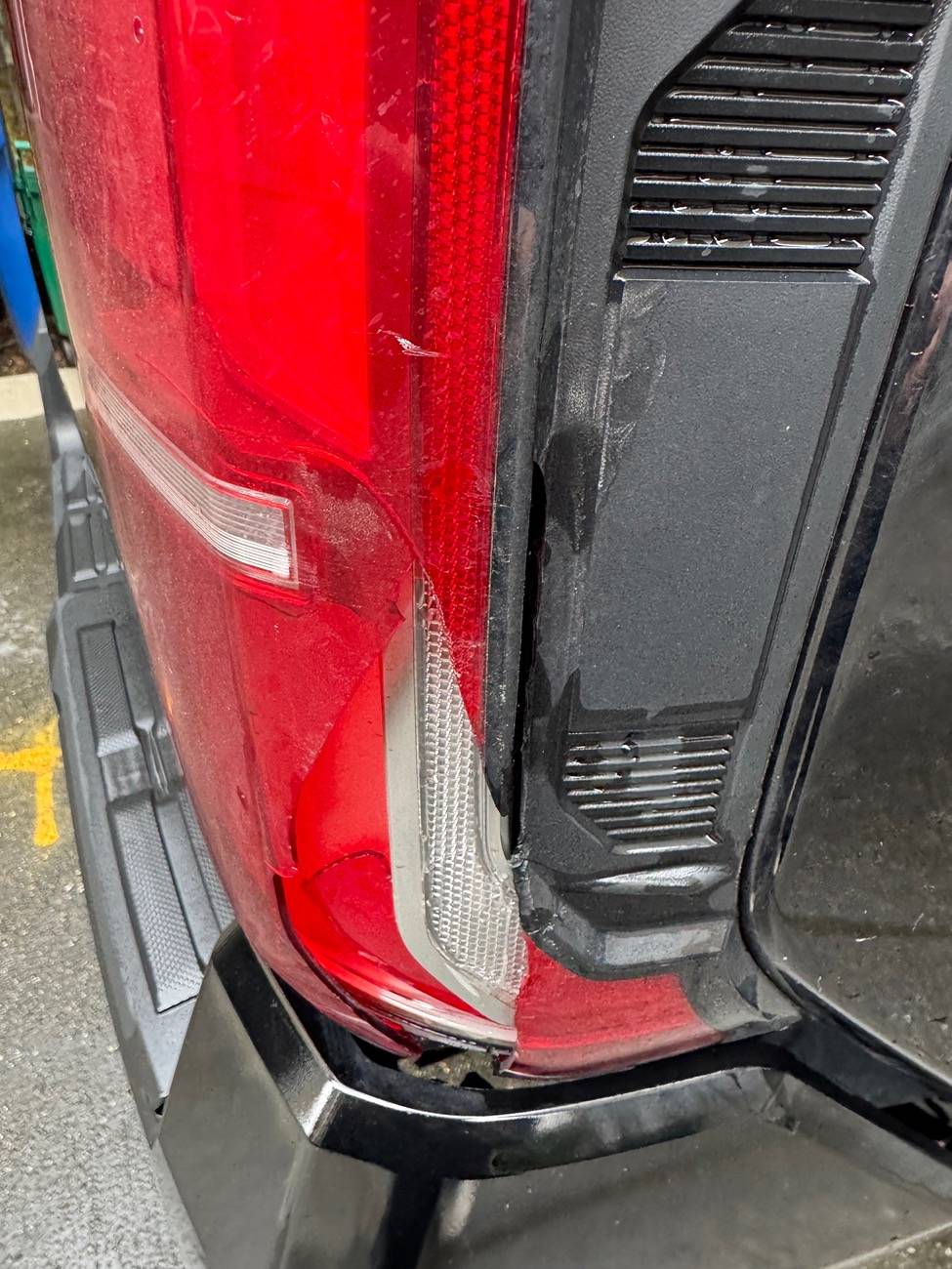

Walked up to my one month new 2024 TRD Sport with a parking hit and run.
Luckily the damage appears mostly contained to the taillight and just the bumper cap, I have ordered a replacement for both (bumper cap will be painted already)
So I need to fully remove the rear bumper to undo the bumper cap?

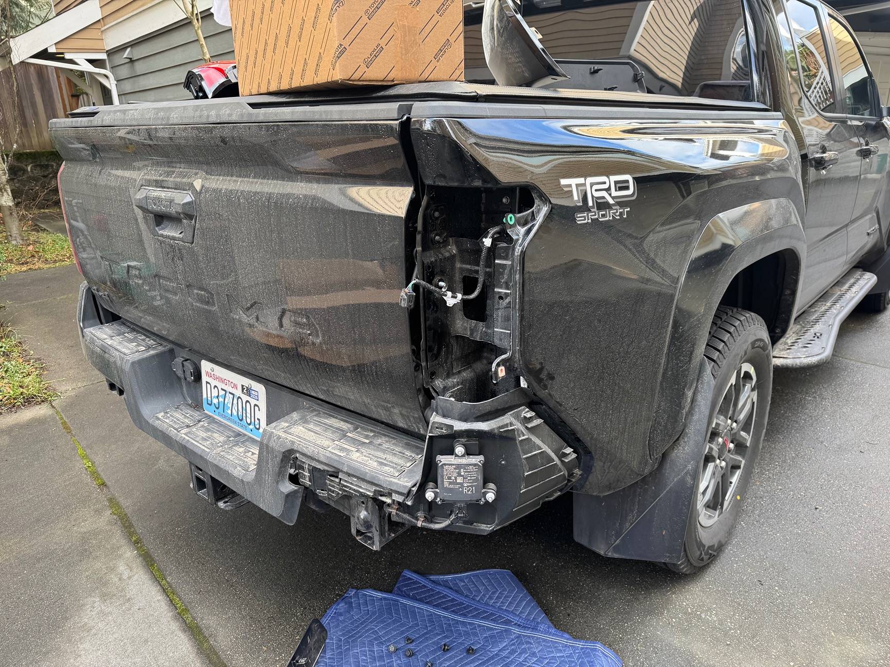

5 pins and 4 push in tabs tabs just did this gotta be very careful not to break the tabs .

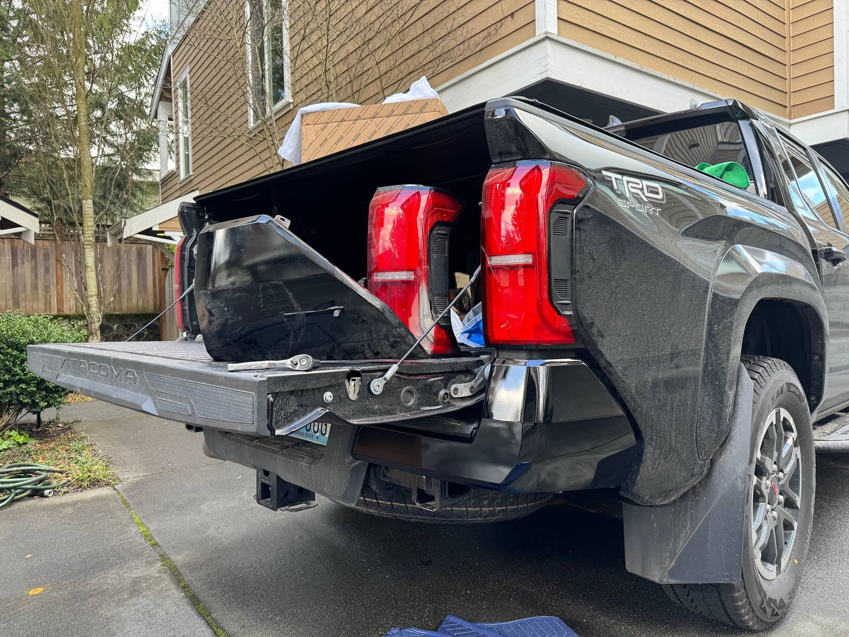

Self explanatory from underneath there's absolutely no videos on this that's why I say be careful I snapped the tabs that's why I needed to order a new one . Also make sure the plastic is not cold that's will make the tabs snap easier

Thanks! In my case, the one that is coming off is trashed anyway. Was snapping a new one on easier?
