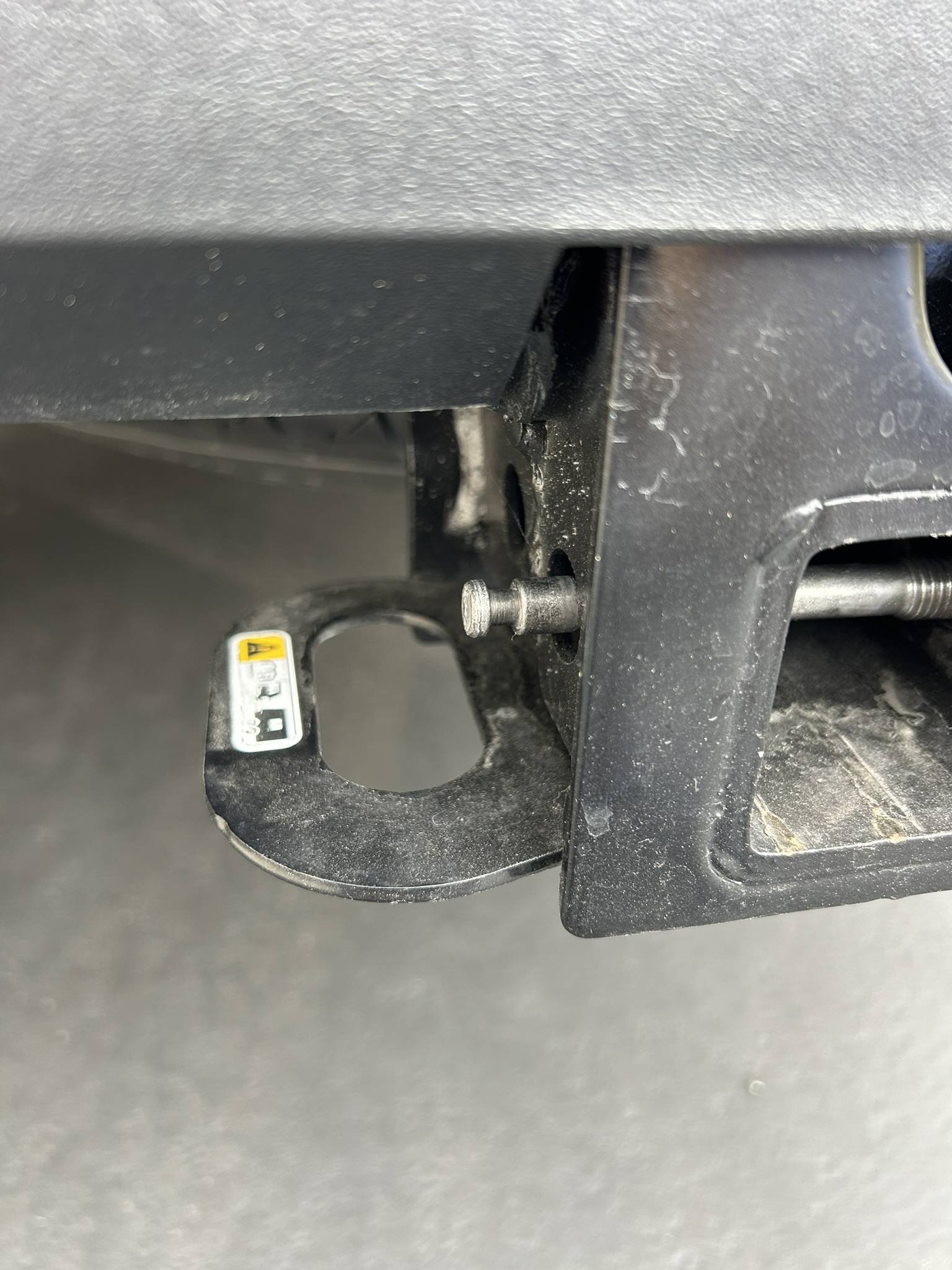

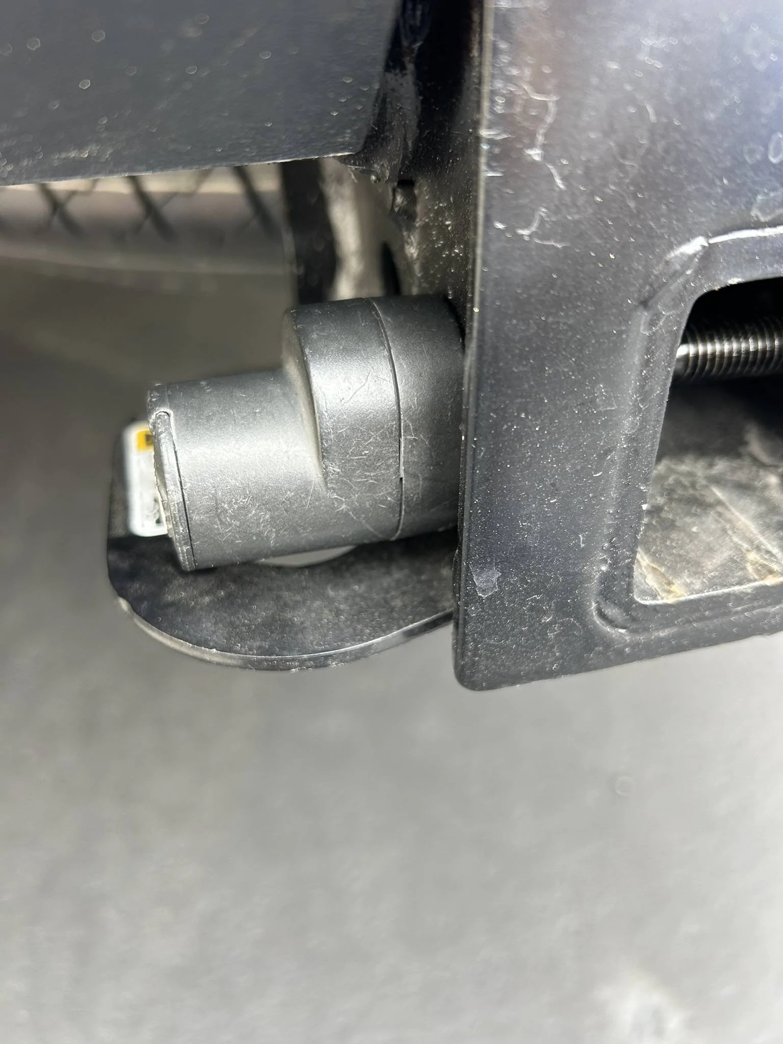

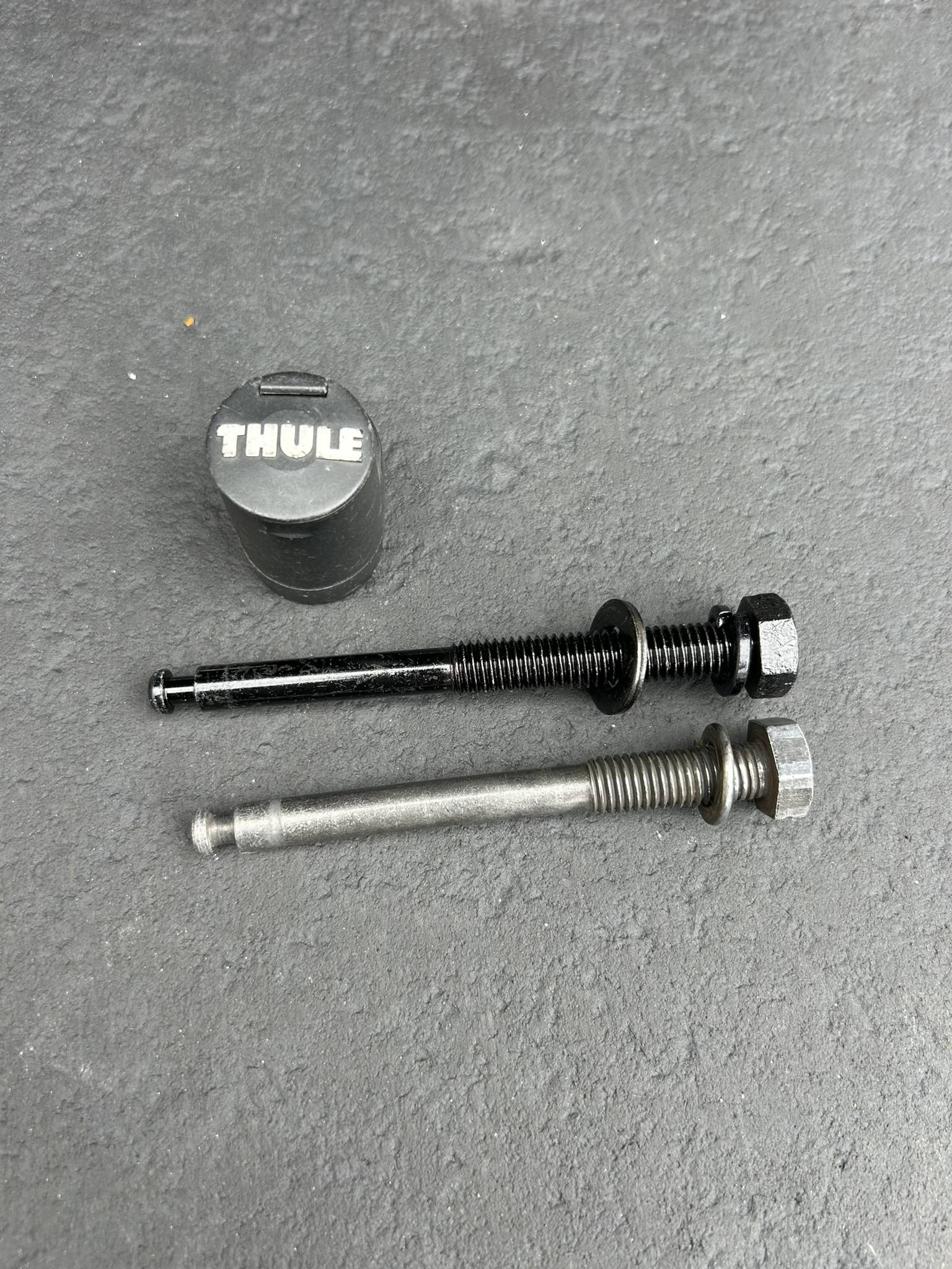

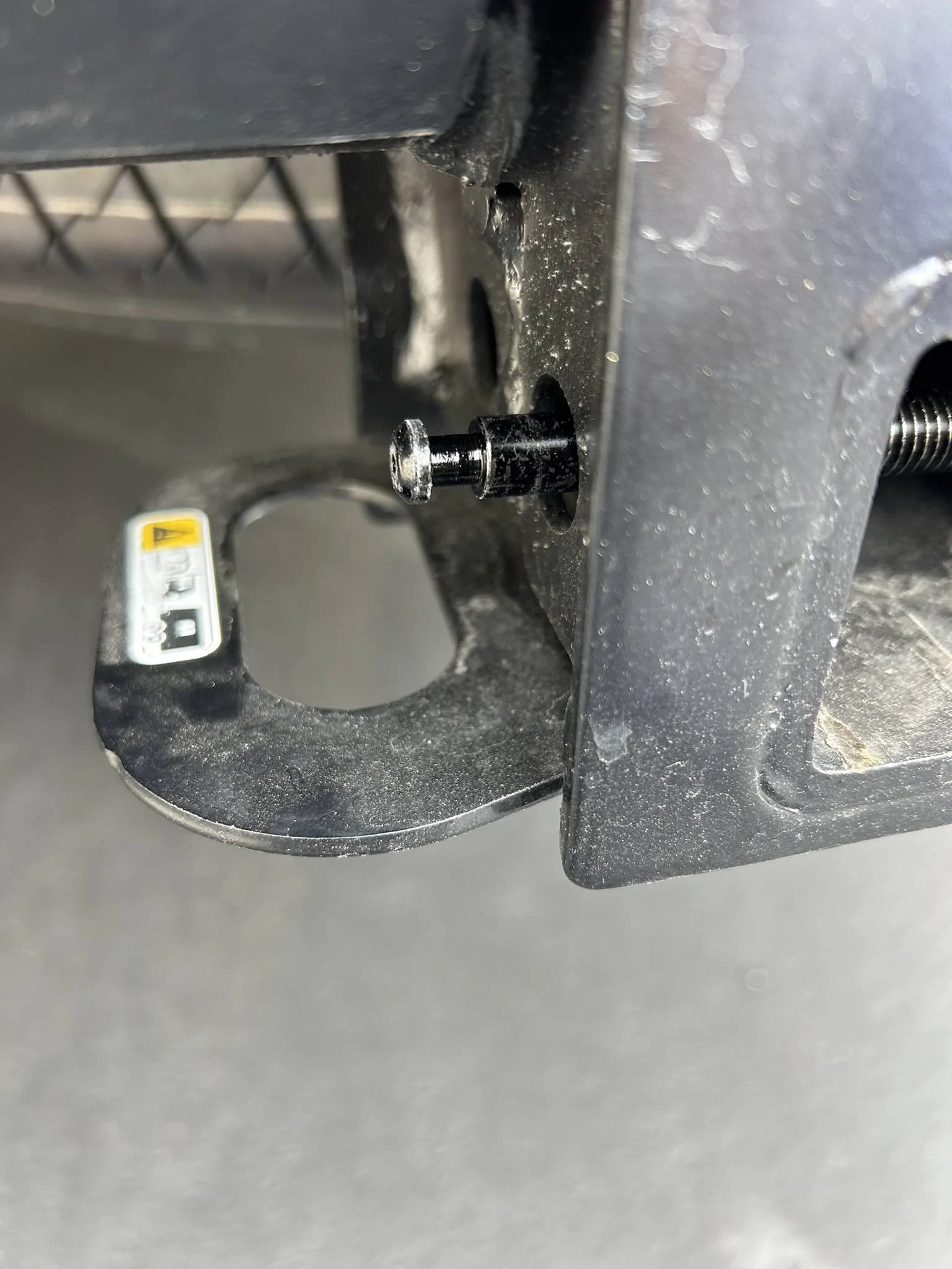

The Rocky Mounts extended hitch pin arrived today and it works. Not bad for $9.95 plus shipping and tax. It's about 3/8" longer than the Thule threaded hitch pin I had. And allows the Thule lock to attach.
https://rockymounts.com/products/xl-hitch-bolt.html
Side by side comparison
Thule hitch pin
2024 Tacoma OEM Hitch For Bike Carriers not working well? Thule hitch pin.JPEG
Rocky Mounts hitch pin
2024 Tacoma OEM Hitch For Bike Carriers not working well? Rocky Mounts hitch pin.JPEG
Rocky Mounts hitch pin with Thule lock
2024 Tacoma OEM Hitch For Bike Carriers not working well? Rocky Mounts with lock.JPEG
