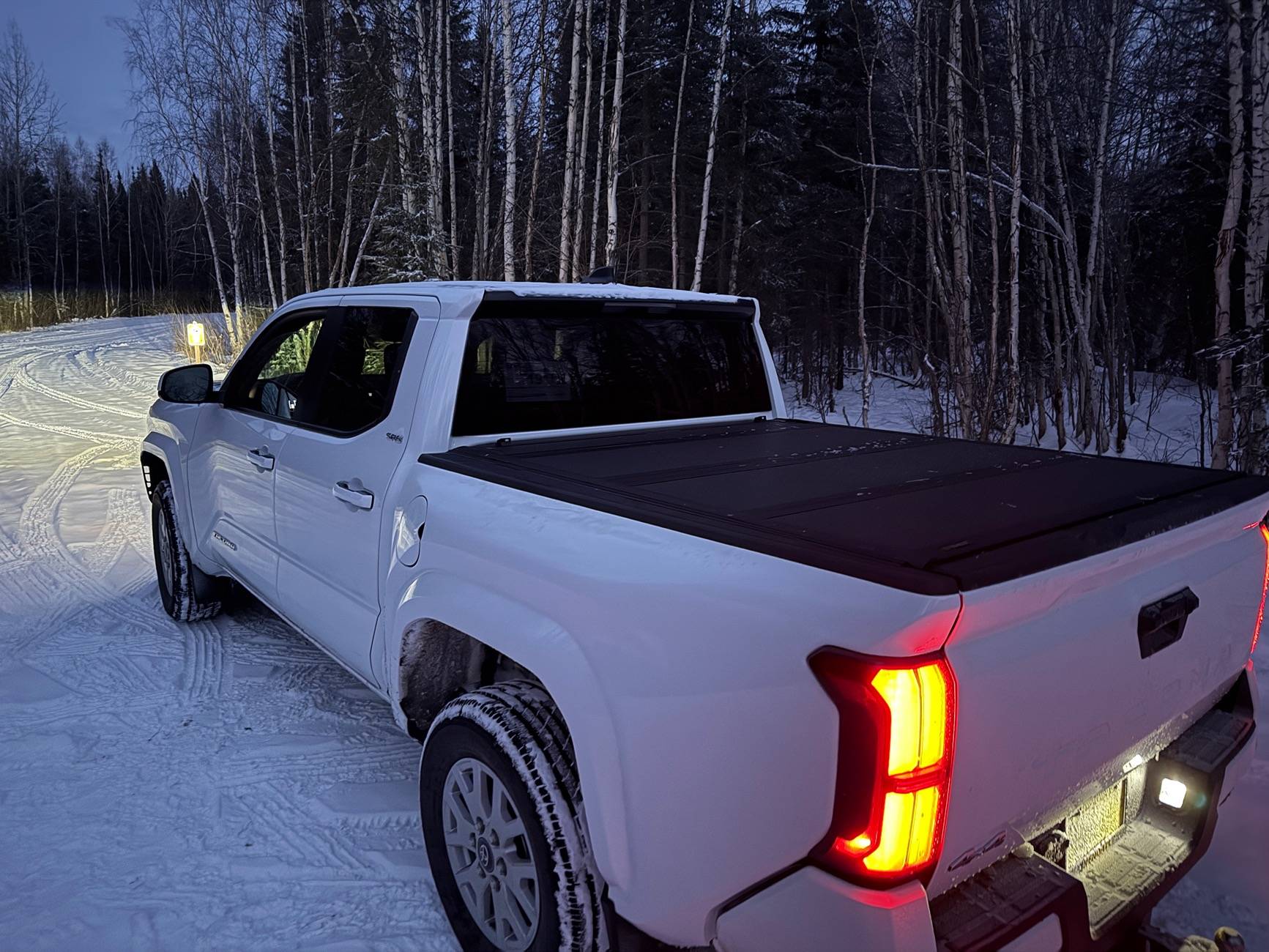

Does anyone know of any bed rail options that work with the OEM Trifold Tonneau?

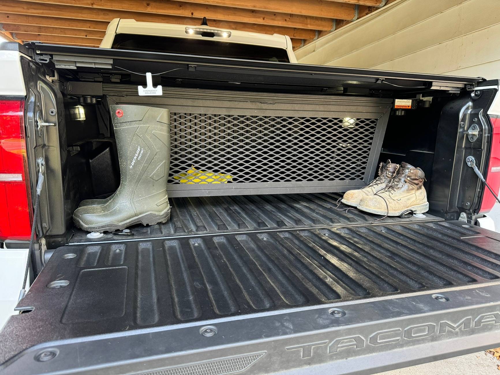

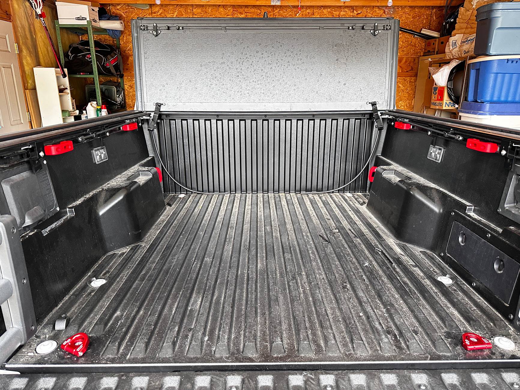

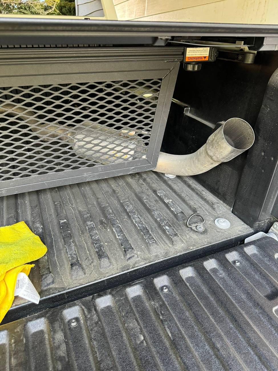

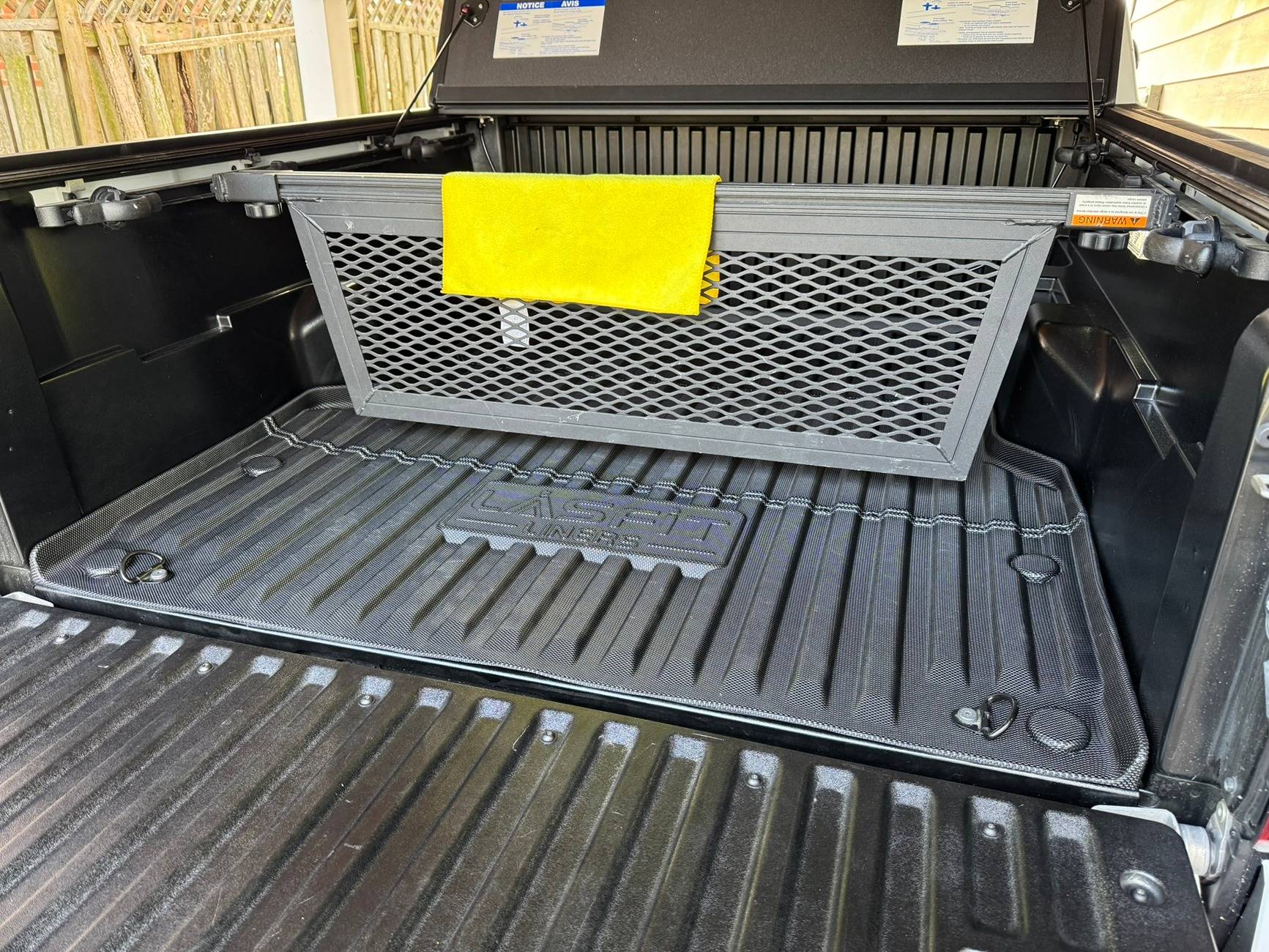

Hey, so I have the OEM bed cover and a bed divider that let's you orient the divider in several configurations. I don't know where the bed divider was originally purchased, unfortunately, since it was given to me by a friend when I had my 3rd gen tacoma. Once I put the tonneau cover on, I had to use a bandsaw to cut about an inch off of each side of the bed divider to make it fit as the bed rails wind up getting pushed in a little bit to accommodate for the bed cover's mounting brackets. Here's a couple pictures that I took a while ago:

The bed divider is nice for keeping stuff where I want it in the bed for easy access, plus if it's in the way, I can flip it up out of the way or remove it entirely fairly easily. It looks pretty similar to some of the other OEM bed dividers that I've seen posted on here, so I'm sure you can find them pretty easily. It also has T-post slots so I can mount stuff to the bed divider rail too if I want.

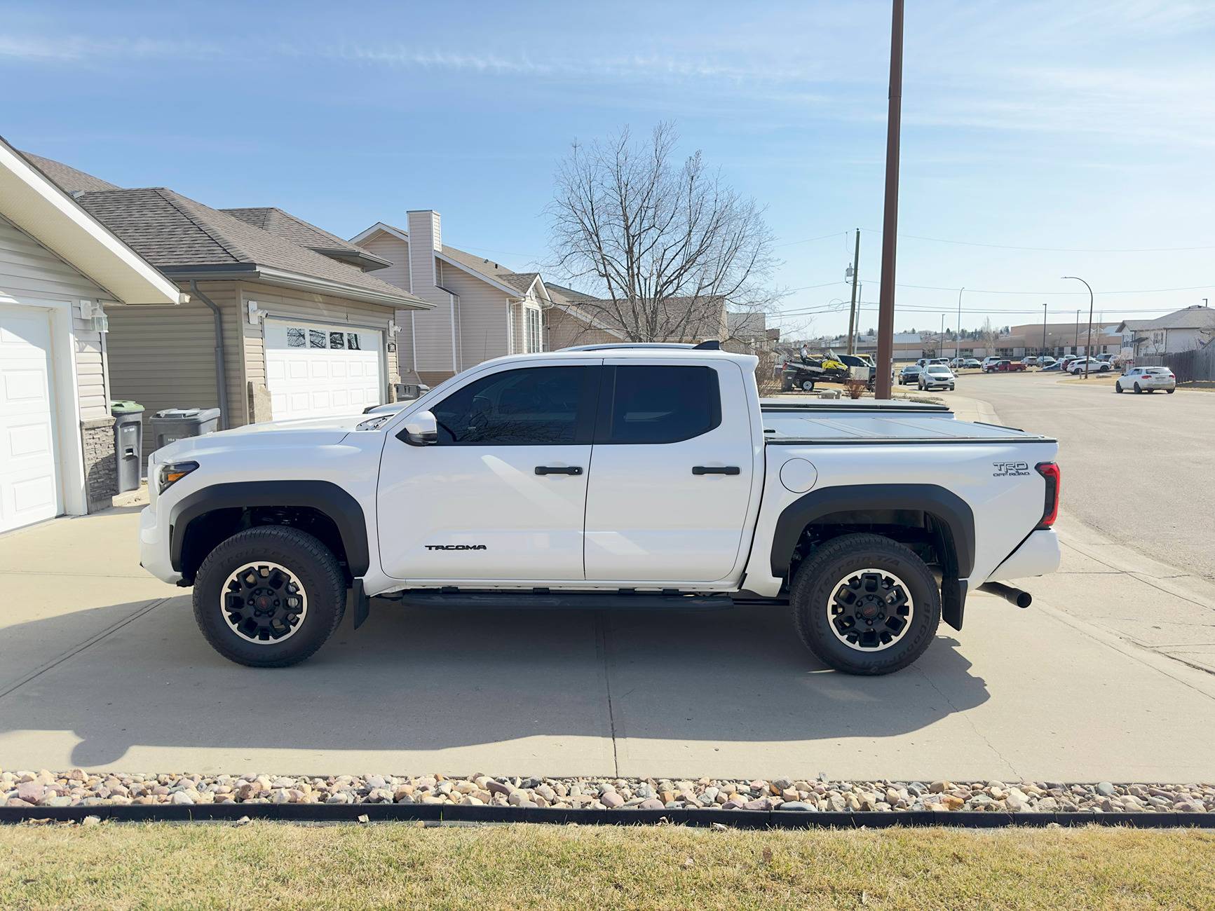

Does anyone have any suggestions for a box mounting rail system that can accommodate a trifold Tonneau cover?
I have been told by some of the Tonneau cover dealers that I will need to replace my existing trifold Tonneau cover with a Retrax Tonneau cover system to accommodate a rail system that could support a spare tire mount. Installing a Retrax Tonneau cover (2k-3k) is cost-promibitive.
The other challenge is finding a spare tire mounting system that does not impede the vision for the back window. I am currently looking at an Armordillo CR1 Chase Rack W/LED Shroud with an Armordillo CR1 tire mount. Any recommendations for a trifold Tonneau system that can accommodate spare tire mounting system would be appreciated.
