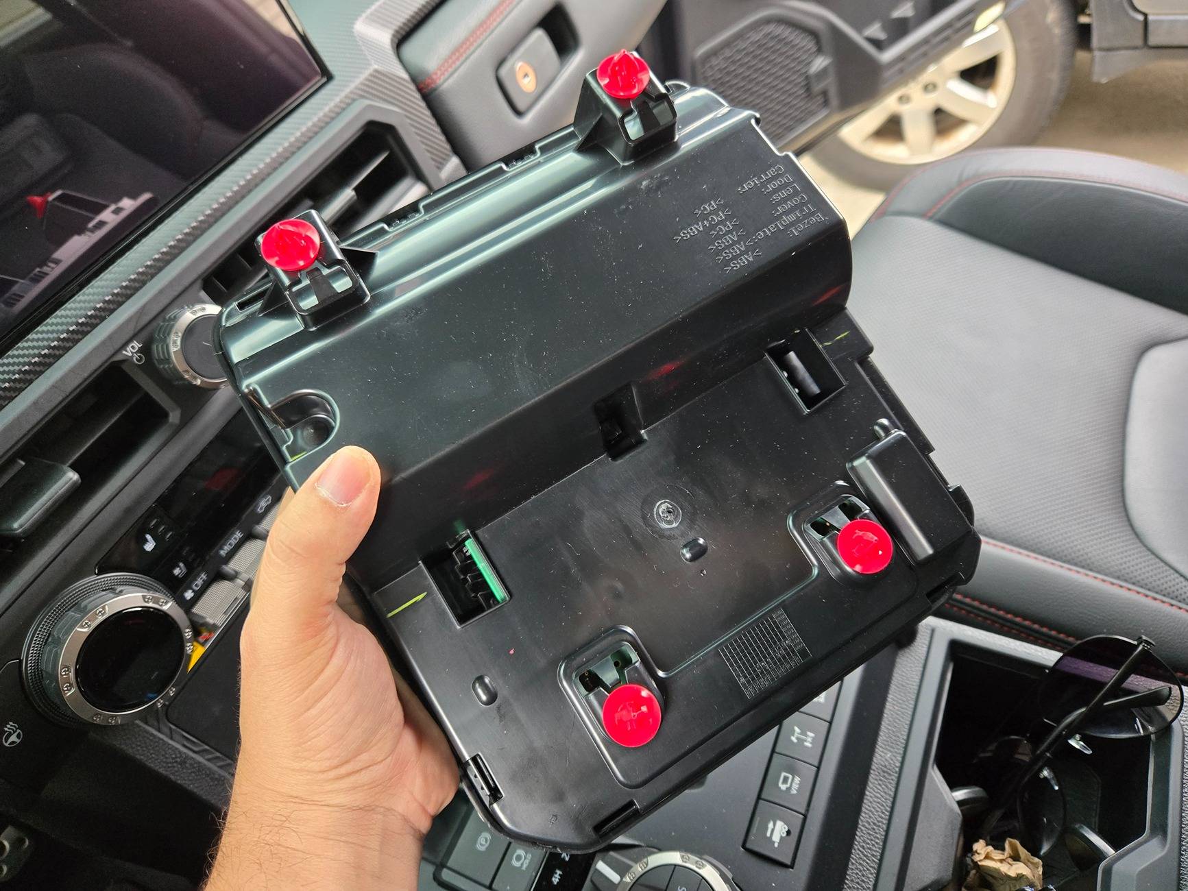

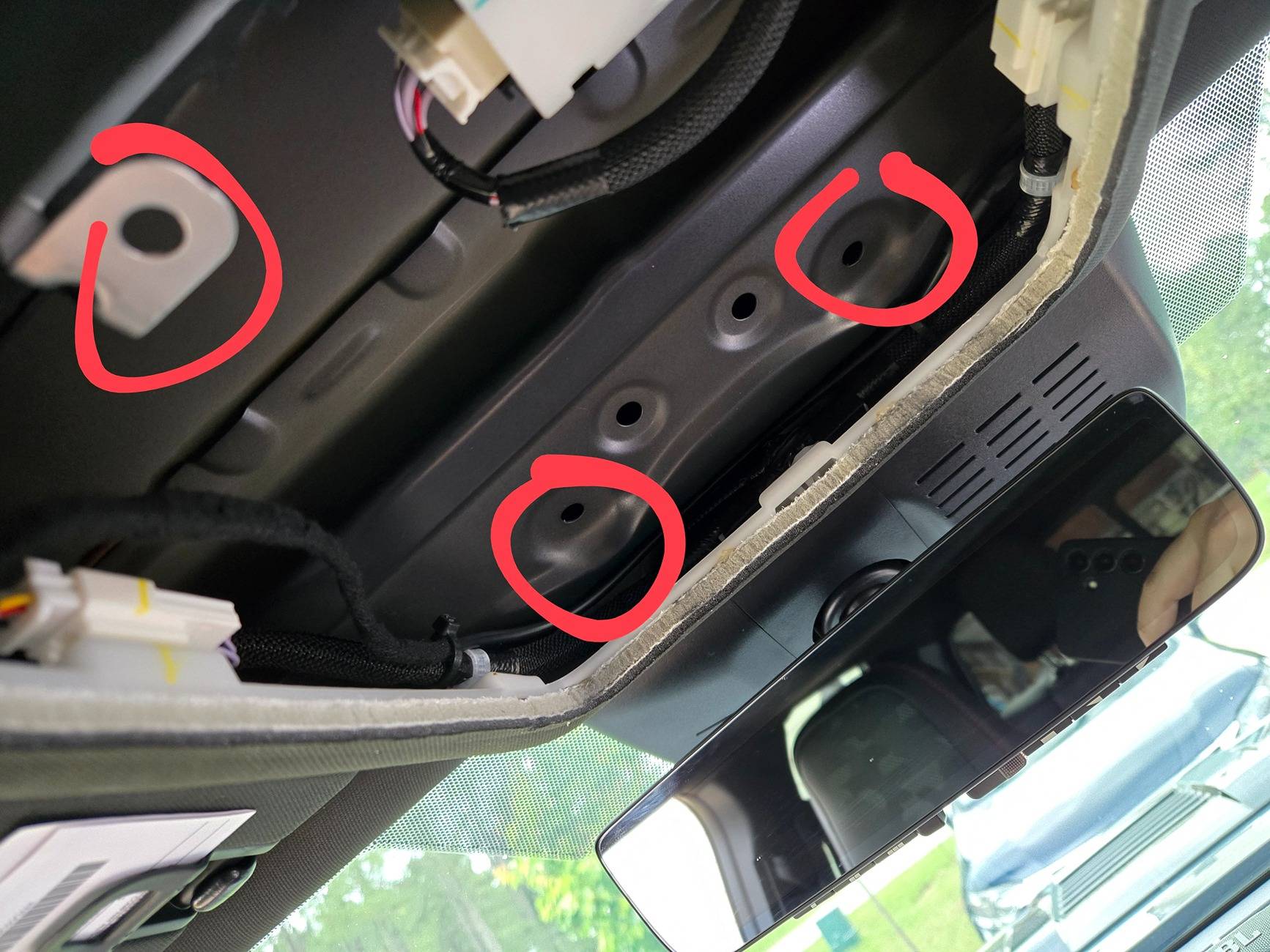

I just did this for dashcam install. There are four red clips. Initially was giving slow and even pressured but didnt budge.
What I did was Start from the front/closest to windshield, with both hands, give it a good yank down, then again at the rear. It literally sounds like it's breaking but it came out in one piece with all four red tabs completely intact.
