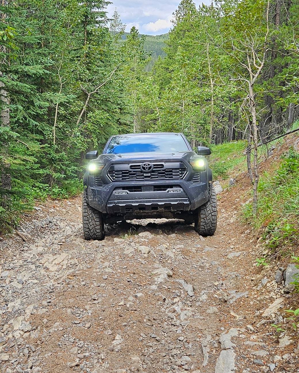

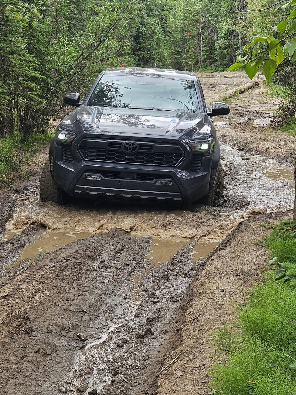

I have 5700+ km in my OR 6MT and have done some pretty gnarly off roading with it as well.
1. Rev hang, yeah it’s there, but I only notice it shifting 1-2 and 2-3. If you’re fine with slower shifts then it won’t bother you at all. It’s not a sports car.
2. iMT, I love it, but I’m lazy. I’m used to driving 18 speed manuals which are much less touchy on the throttle, so for the sake of smoother shifts I just use the iMT, that way I can downshift and brake at the same time.
3. Crawl control, I did some pretty steep trails with loose rock and mud and I didn’t wish I had crawl control at all. 1st gear is very low already and 1st gear 4LO is VERY low. I spun out once on a steep slope with loose rocks because I didn’t have the locker in and thought I might have to use the clutch cancel start feature. I held the brake while I let out the clutch, once I started to feel the clutch grab I let off the brake and gave it a touch of gas and it just walked away. I was VERY impressed with the crawl-ability. Going down the steep sections I barely had to touch the brakes, there was enough engine compression at around 2000-2500rpm to hold the truck back easily.
My only mods are wheels and tires. In stock form the Off Road model is a beast on the trails.
