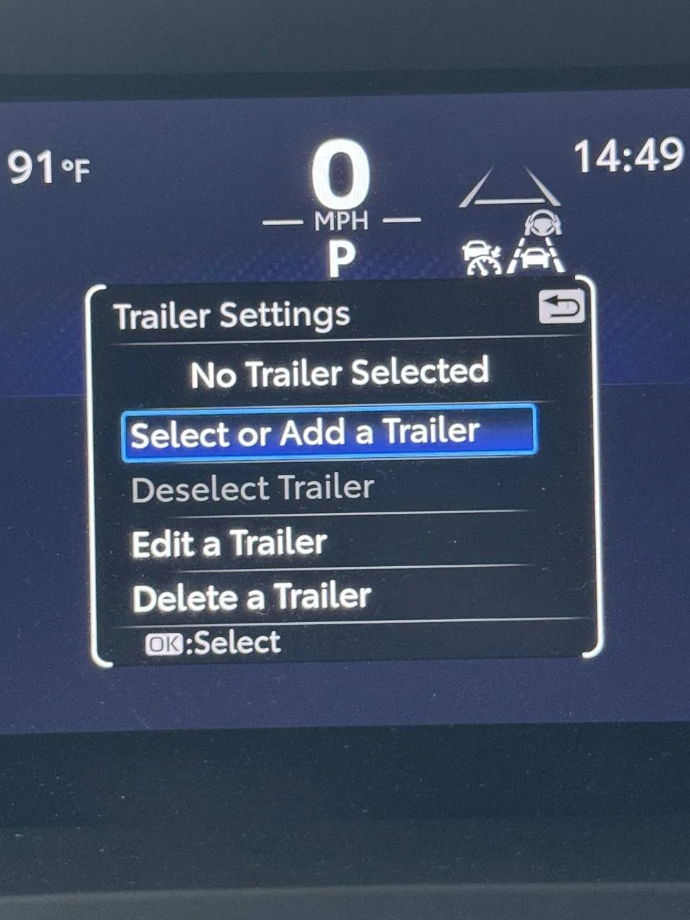

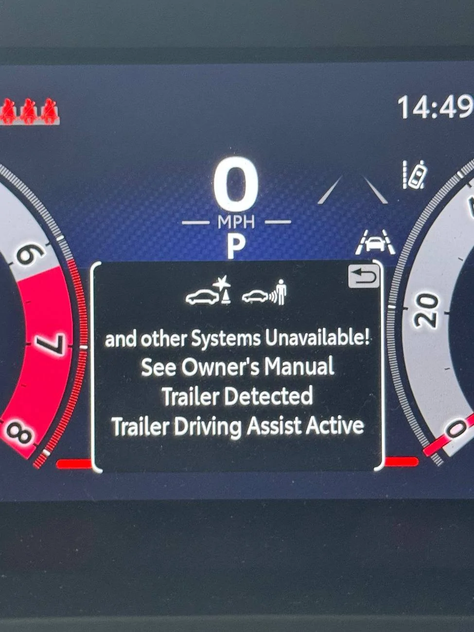

I towed my utility trailer for the first time yesterday ,and had zero problems setting up the trailer. Last night, I disconnected the trailer, but the truck still thinks a trailer is attached has has disabled some safety sensors.
I've tried manually deselecting the trailer, and it's still in trailer mode. How do I get it out of that mode?

Did you disconnect with the engine off? If so, you should have received a message asking if you'd disconnected, and of course, you need to select YES.
Rehitch and go through that sequence.

I originally disconnected with the truck running, and never got the disconnected question. I reconnected to the trailer, drive about 400 feet, and it finally asked if a trailer was connected. I answered NO and it went back to normal, even though a trailer was connected.
