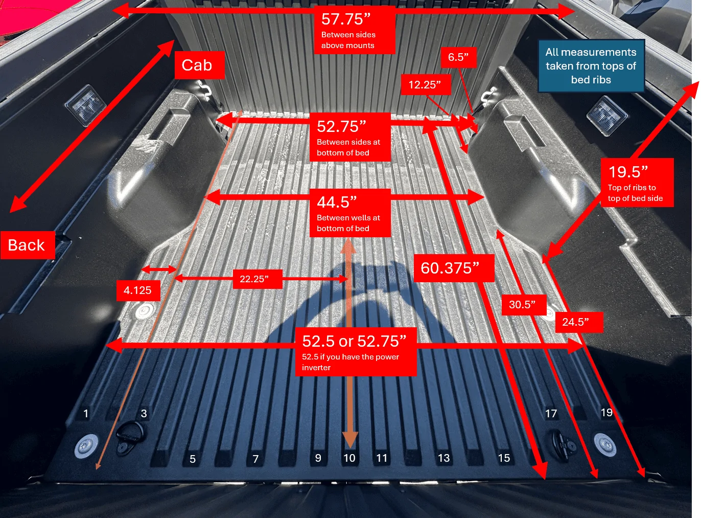

Anybody know the TH short bed diagonal dimensions? Trying to figure out if my 182cm ski’s will fit (since they won’t if loaded straight). I guess I could do the math on the published length and width but I cant do math.

~80" or ~203cm laying them on the floor of the bed diagonally. Maybe a touch more if you have the spray in bed liner coming. Your sticks will fit but individually stacked or X patterned for the quiver. I went 6' bed, have skis & surfbaords longer gear, want that extra foot for stealth camping as well 🤙🏽
TH same bed slightly narrower around the compressor port, and the spray liner designed to give you more overall volume
