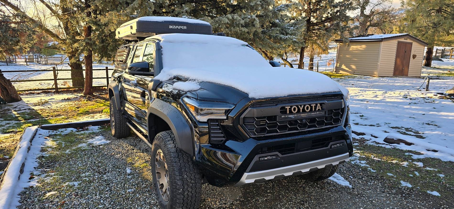

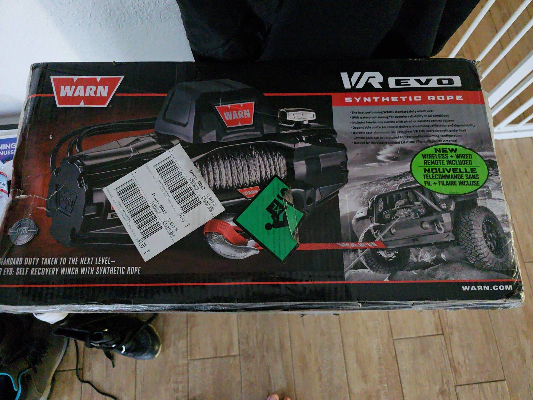

Hi everyone, I'm fairly new here. I just purchased a Warn EVO 12s and CBI Covert bumper for my Trailhunter but I have no clue how to run the power cables all the way back to the battery that's under the back seat. I have seen a few threads here where people have a winch wired up to a battery under the hood, like on the off-road models, but nobody has posted picture with an explanation as to how they ran the wires on a Trailhunter (at least I haven't found a thread on it yet).
Can someone point me to a thread (if it exists) with pictures and an explanation of how I can wire this up please? I'm ready to get the party started lol. Thanks in advance for any help or links!! ?

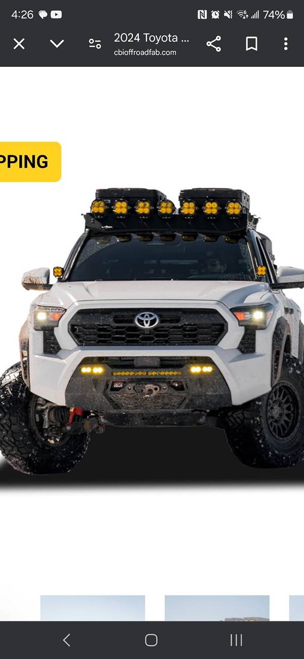

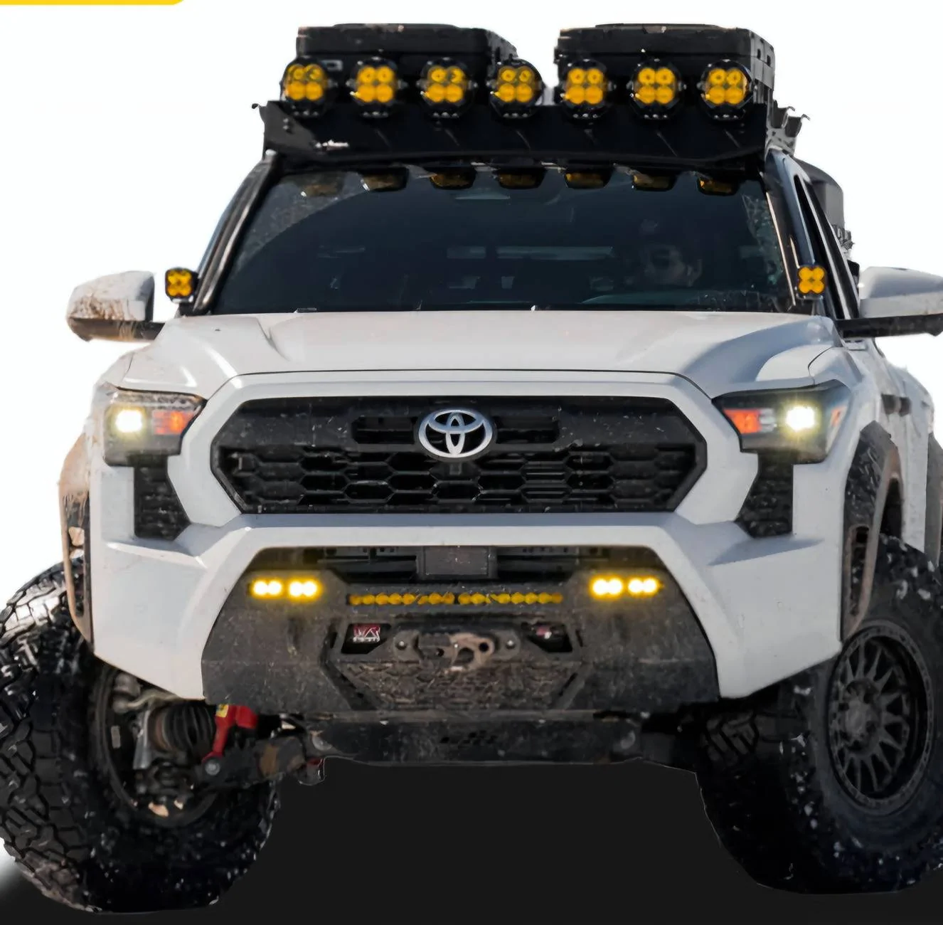

This is the CBI bumper I ordered:
