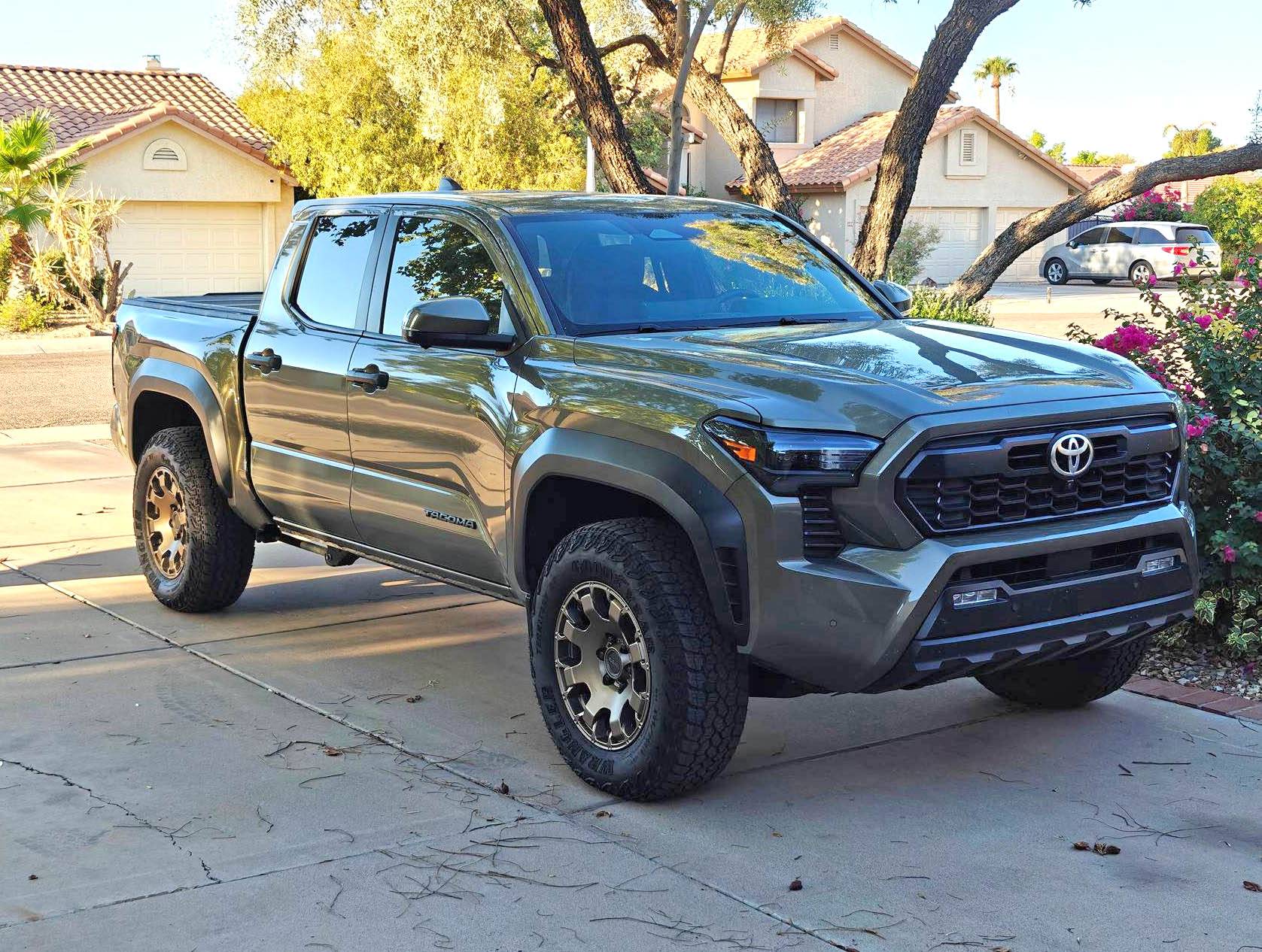

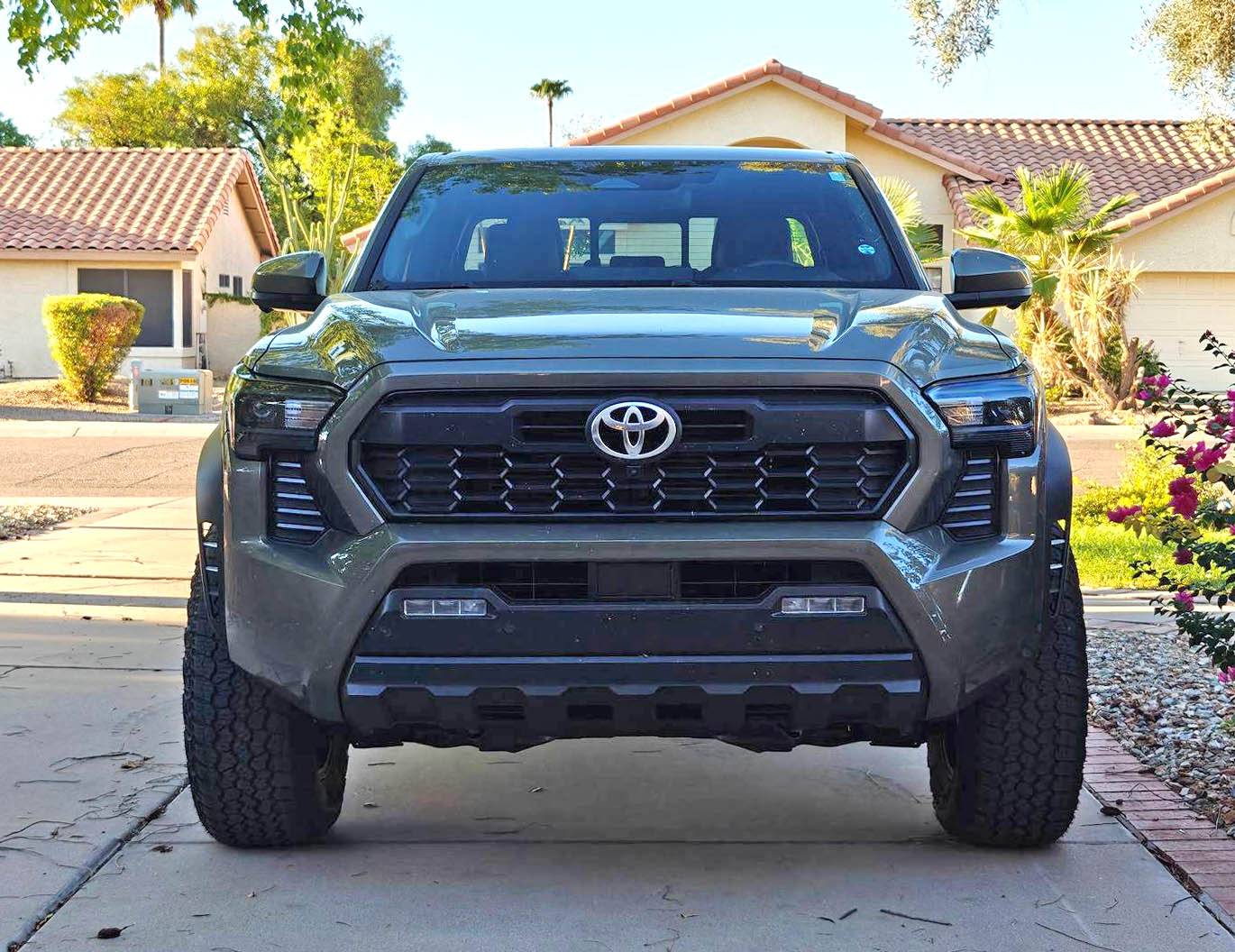

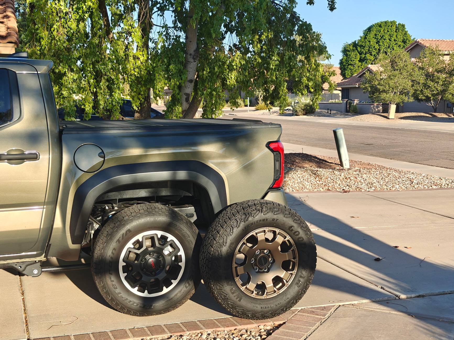

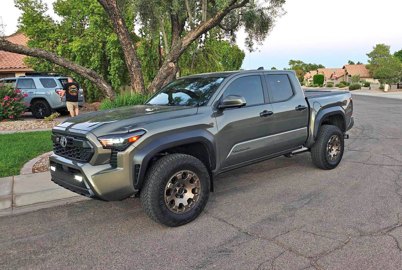

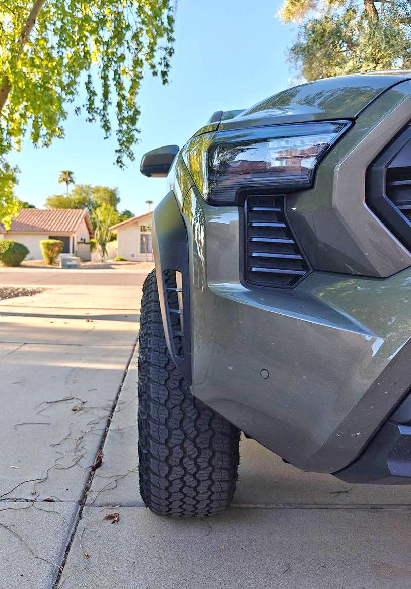

Trailhunter Wheels (265/70R18) installed on Stock 2024 TRD Off-Road
I fell in love with this color/rim combo on the debut of the 2024 Tacoma unveiling but just couldn't bring myself to pay the excessive pricetag on the limited trailhunter trim. Last weekend I was able to score a set of these and they fit on with stock suspension, no modifications needed.
Since there doesn't seem to be any correct information that I've been able to find online regarding the Wheel, the Wheel is an 18 x 8.5 with a 25 offset.

@jmasters Zero problems at all! I've got about 1400 miles on them so far, some highway and also some primitive dirt roads as well! I've had zero rubbing. What type of pictures are you looking for? The wheel in full articulation?
@Kdbradley85 I am happy to report zero problems at all. Yes, you should be able to transfer your TPMS sensors into the new tires. Congrats! I love these rims.

@Everbeers mpg difference is negligible with stock TRD pro/trail hunter tires. I have about 3000 miles on them now and don't notice a difference from the first 7000.
My only gripe and word of warning is the added tire poke and more aggressive tread has done a real number on my back panel in front of my rear wheels and behind my rear doors... 40 miles of dirt roads last weekend and the damage is real. Need to come up with a solution before I repair the damage, otherwise it will just keep happening.

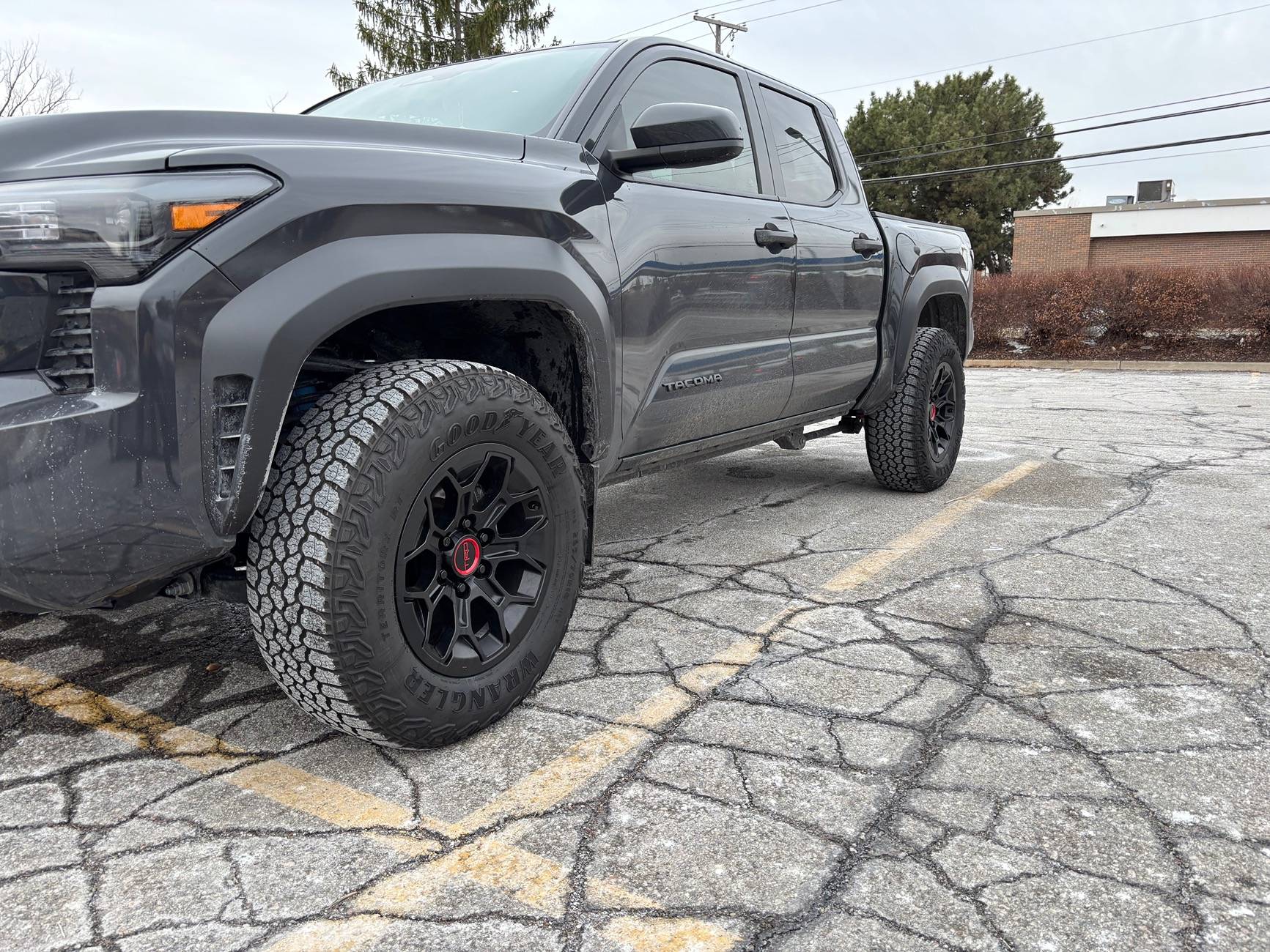

@SonoranSurvivalist Thanks for the heads up , got my TRD pro wheels installed today. Never hit dirt roads… just sand dunes and crappy Michigan weather.

@SonoranSurvivalist I was considering mud flaps to help mitigate some of the rock chip damage, but I also have some rock sliders which have done pretty well so far at keeping the rear fenders protected. I’m hoping the added poke isn’t too much, but rough country and NYTOP both make some wider fender flares if they’re sticking out too far. The stock OR tires are really bad at picking up gravel, so switching to a more aggressive tire like the KO3s should help too I think (my theory is the rocks will be ejected easier at lower speeds since there’s larger gaps in the tread). It’s pretty crazy how hard these wheels are to find. You got very lucky my friend!
@Everbeers those TRD Pro wheels look awesome on your truck! Nicely done 👏
