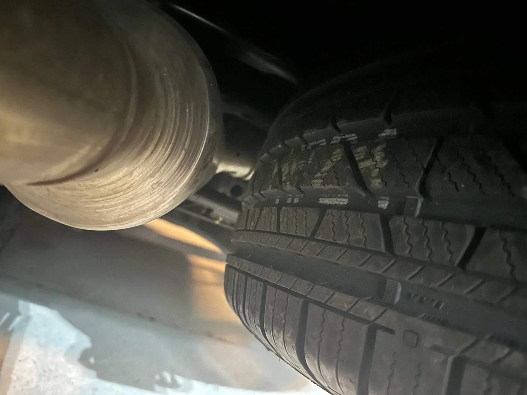

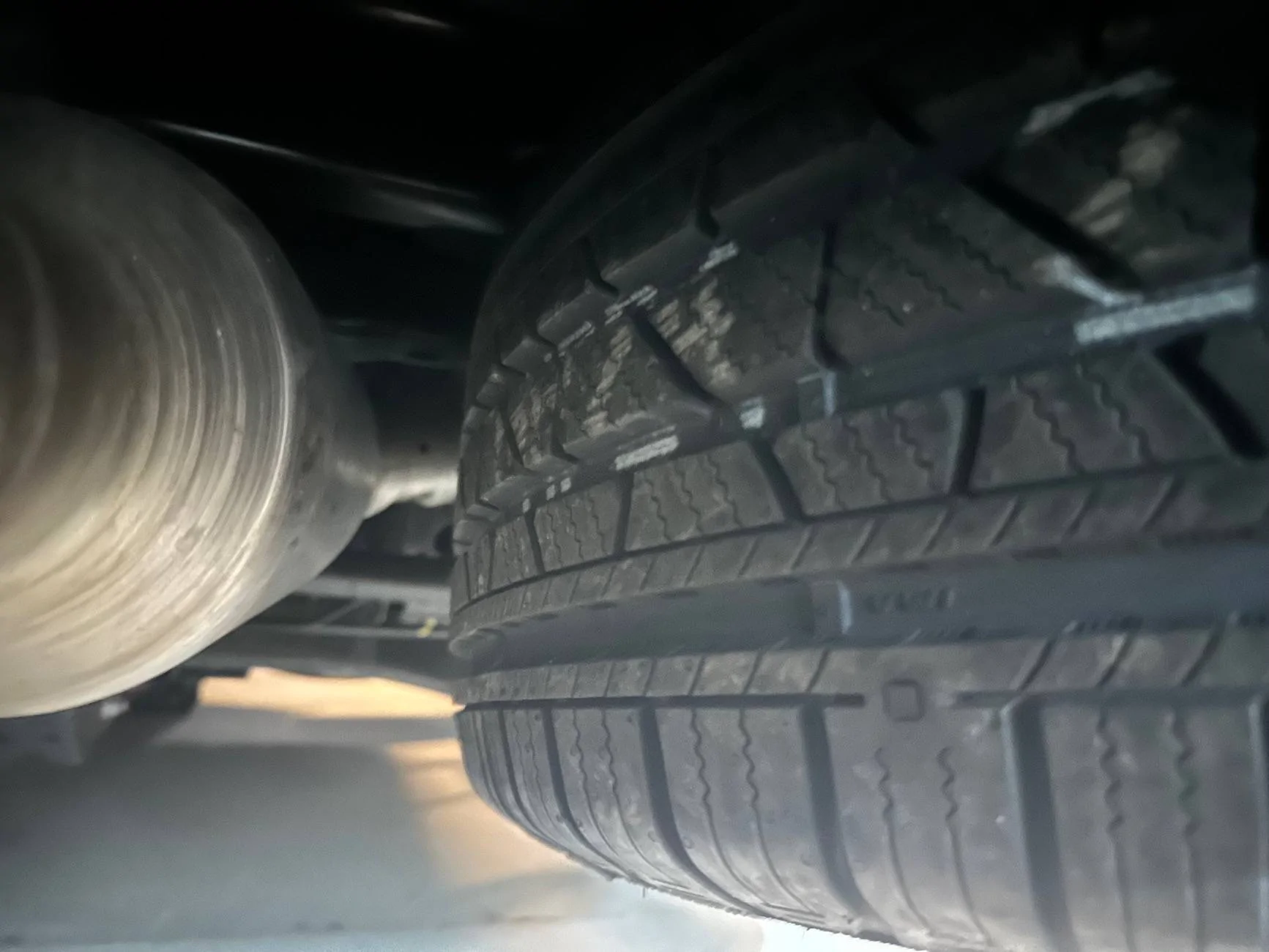

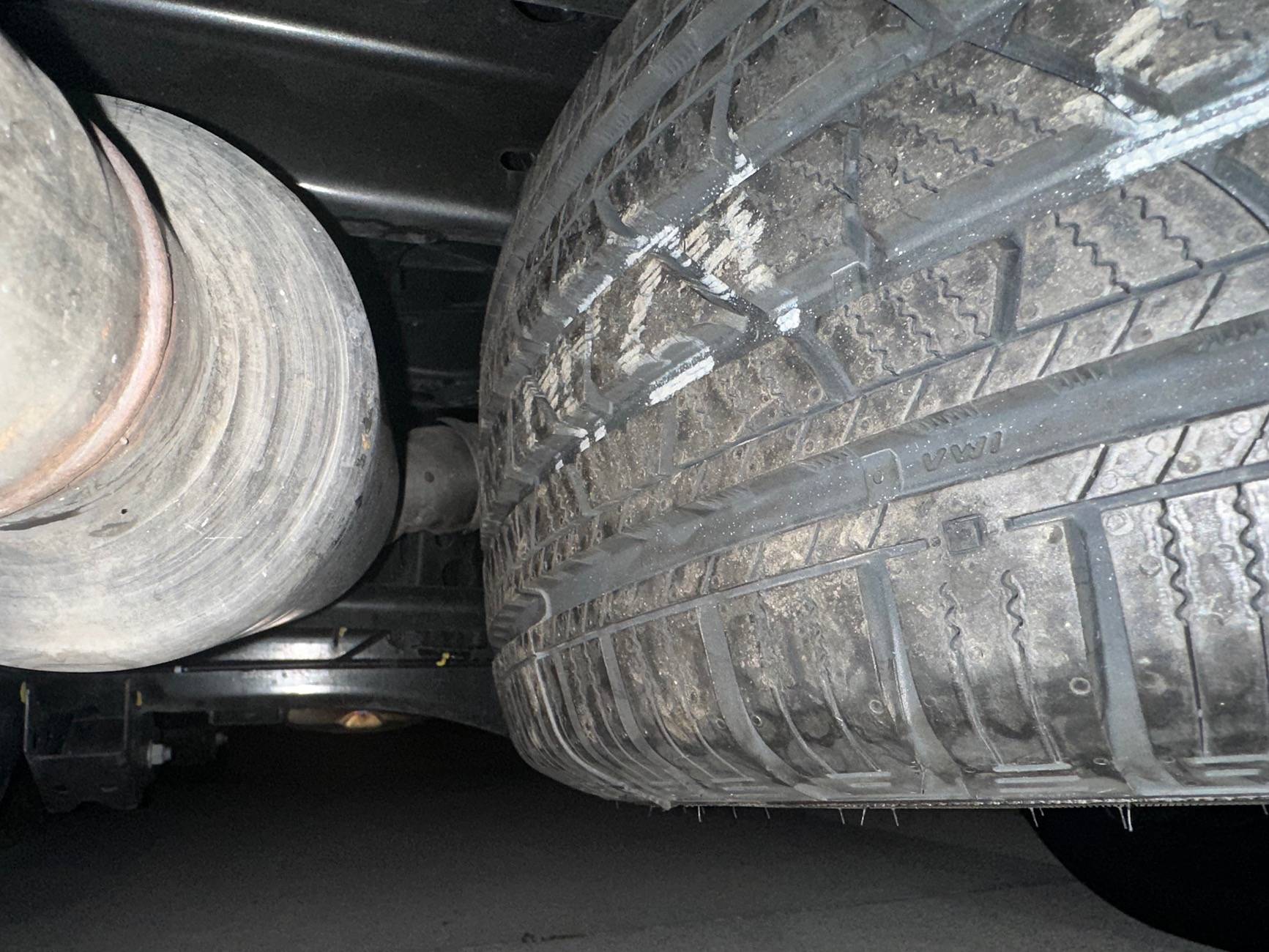

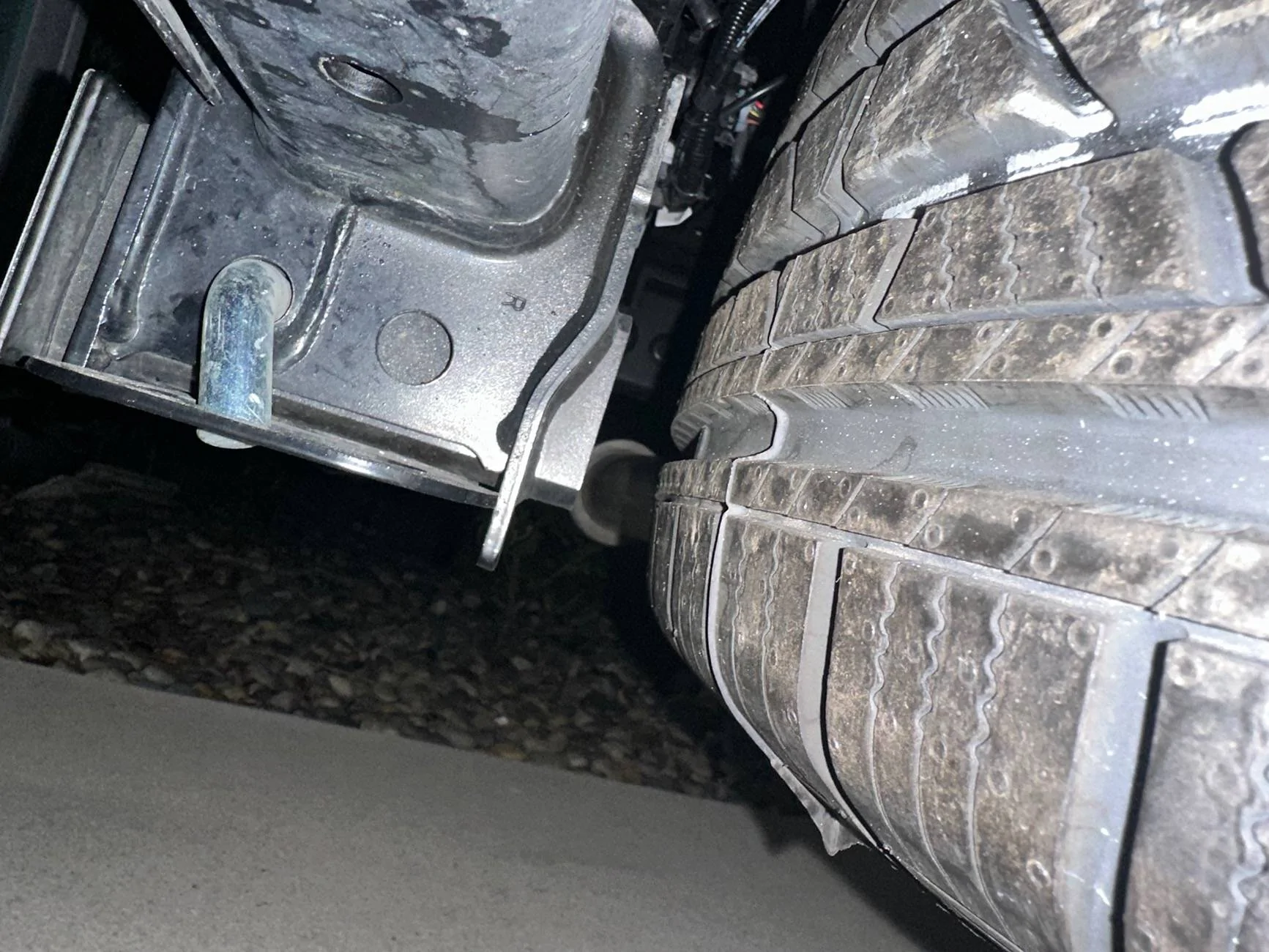

Pictures ?Update, finally got around to finishing this. Found a stock TRD Sport 18 inch wheel on ebay for $175 including shipping that was in perfect condition. Added a stock size 265 65/R18 tire, I got a new Cooper Discoverer SRX blem that looked close to the stock Michelins tread mounted and balanced for $140. This setup was close in weight to the donut spare so weight is not a problem, and it fit in the spare location easily. About the same amount of tire shows below the bumper as did with the spare donut so loss of clearance not a concern either. Project worked out perfectly and highly recommended if you want a full size spare.
