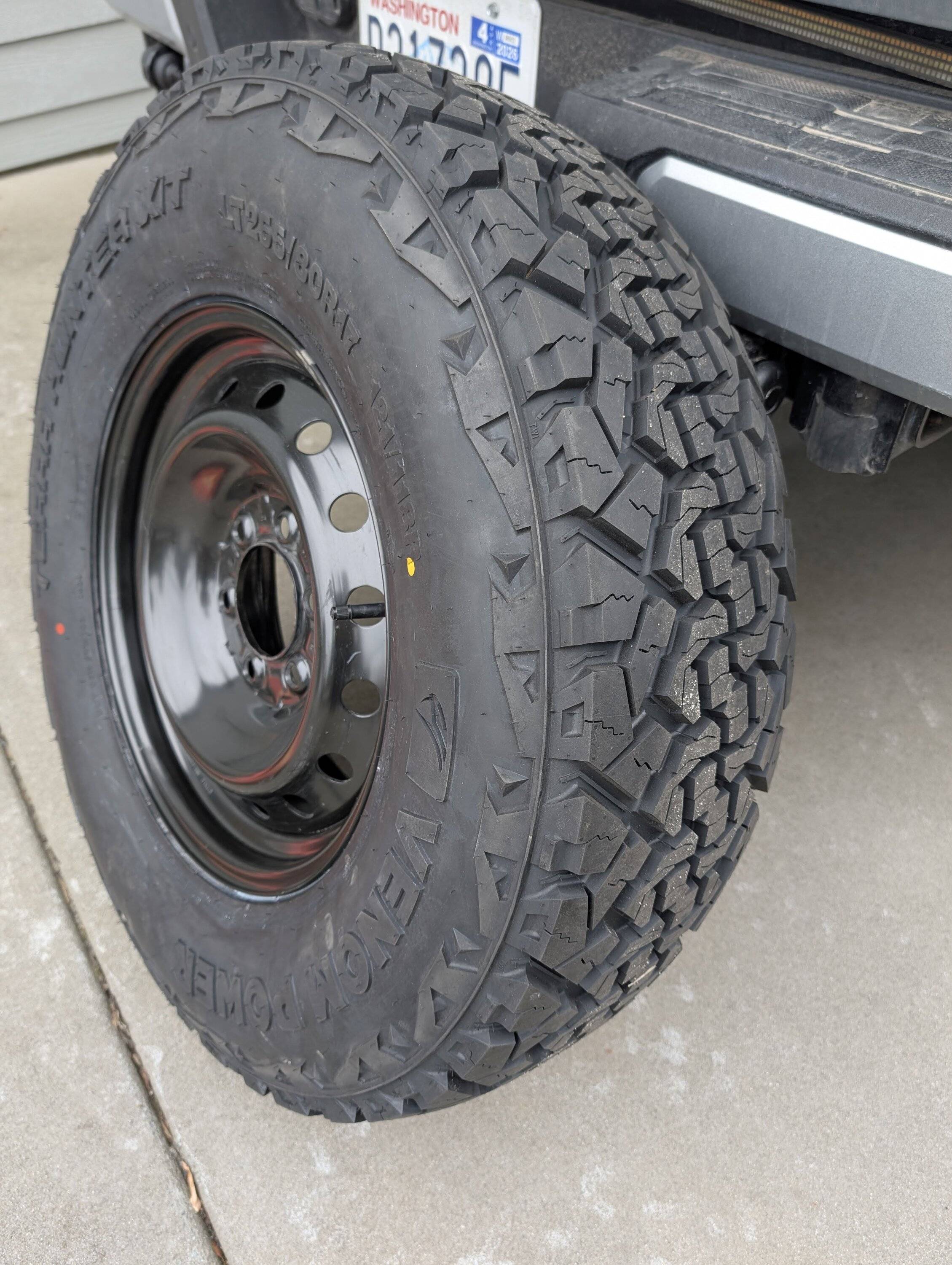

Spare Tire Replacement/Upgrade

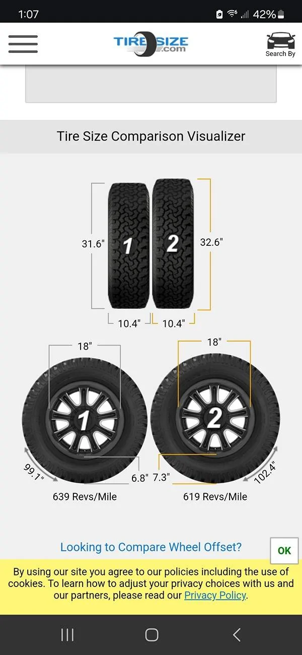

I've been looking at spares as well. I'm on 285/70s like you.
I found that 255/75 are closer in size (smaller about 11mm) and MUCH cheaper.

Interesting. According to the tire comparison site the 285/70r17 is 32.71" and the 255/75r17 is 32.06", or .65" (2%) smaller. The 255/80r17 I bought is 33.06" or .35" (1.1%) larger.
Honestly, you could very well be right. I'm sure individual tires can vary by manufacturer regardless what the "standard" specs are, and it could be that my little tire comparison tool isn't accurate as well (or maybe I'm just missing something). Regardless, if you're satisfied with your choice then that's all that matters and the fact the 255/75 is cheaper is certainly compelling.

I was using willtheyfit.com. Yeah as you say there are subtle differences in tires based on tread and the like.

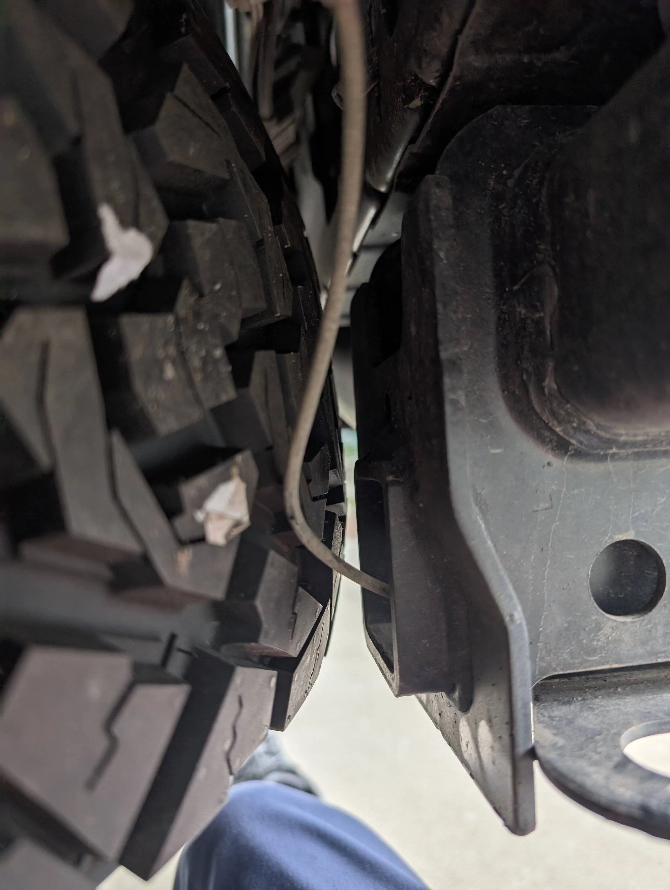

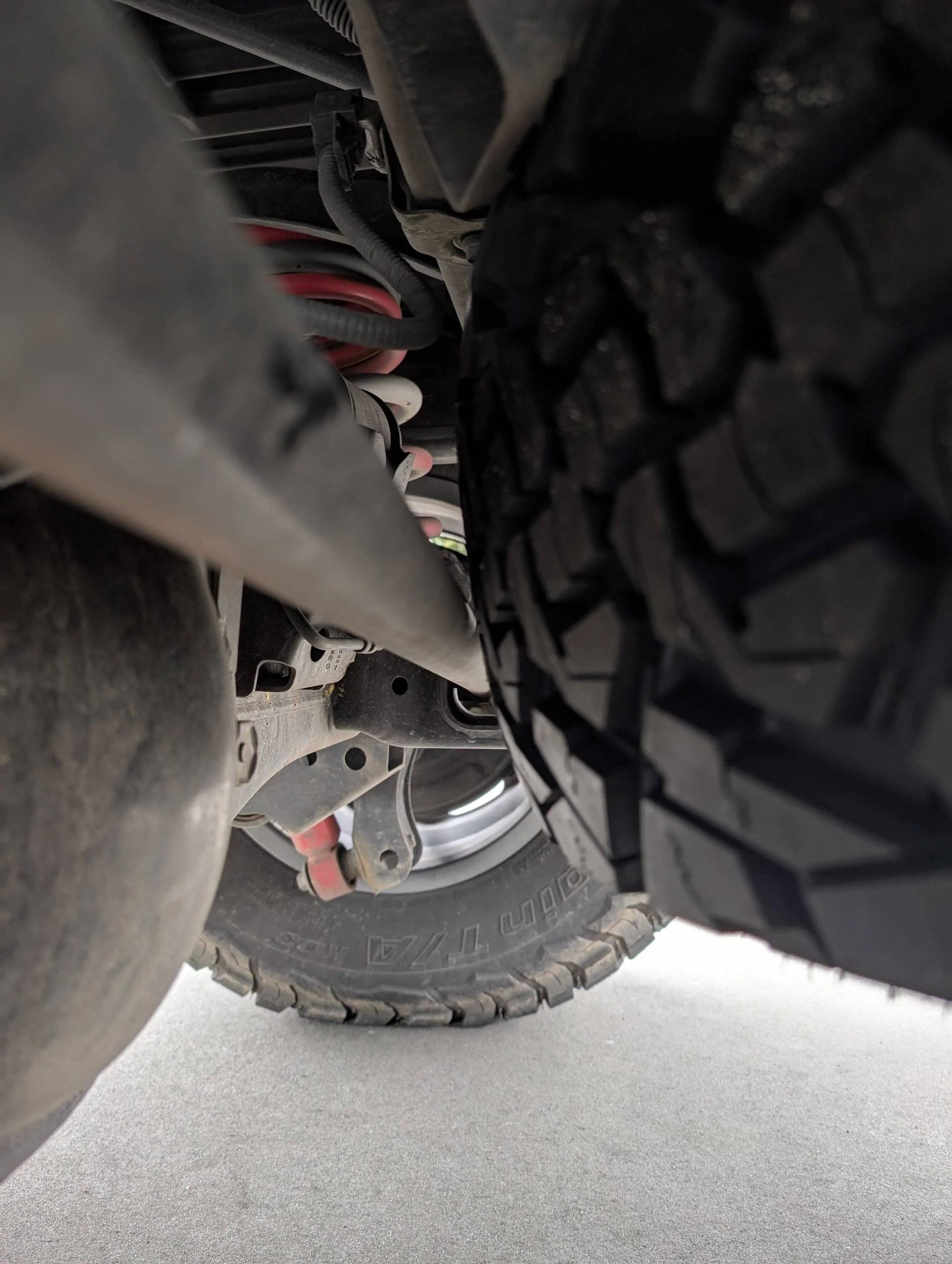

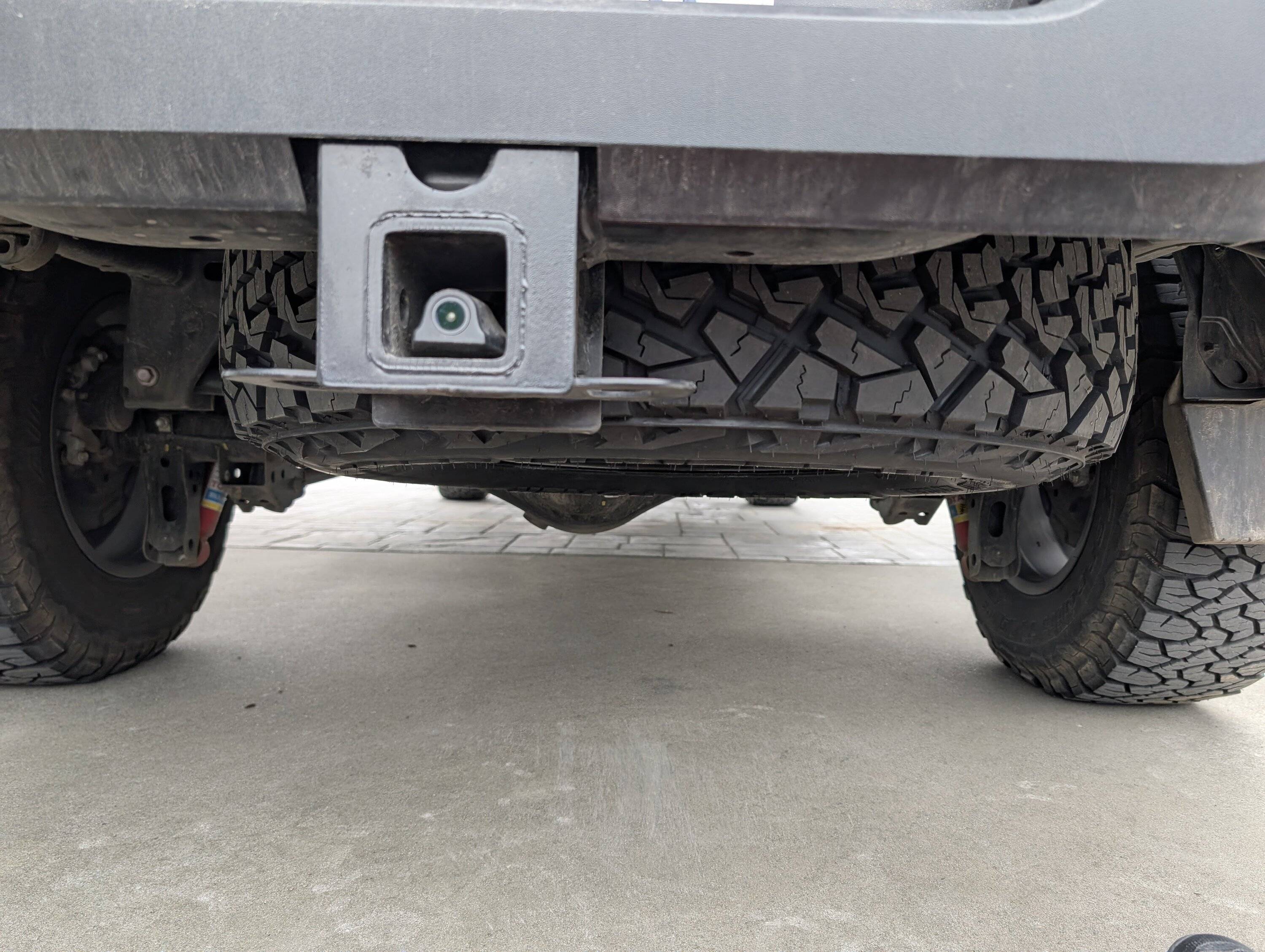

I’m going to try and put in a 255/75 R17
I have 275/65 R18 summers and 255/70 R18 winters. All 32.1” diameter.
Seems like that will be perfect for a spare and will fit under the truck, no problem.
