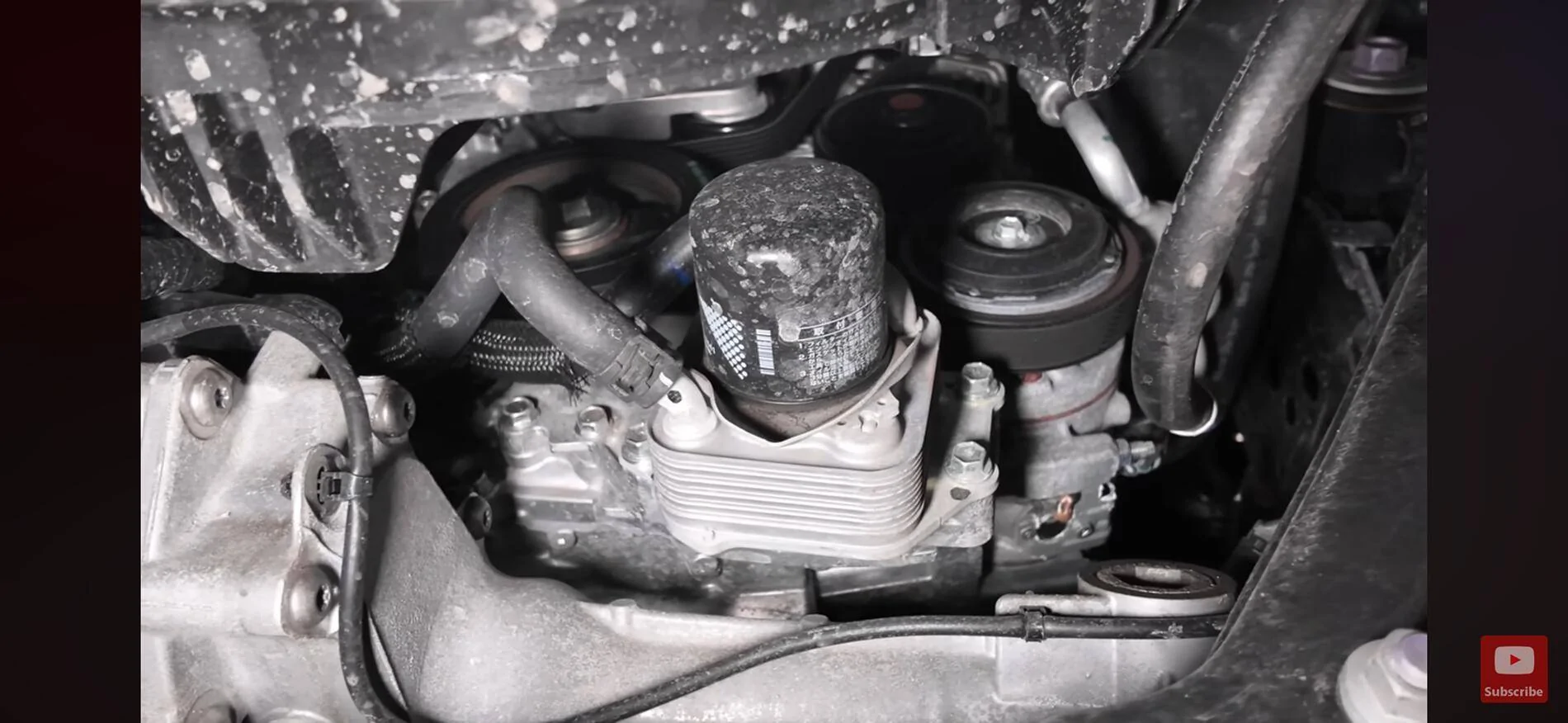

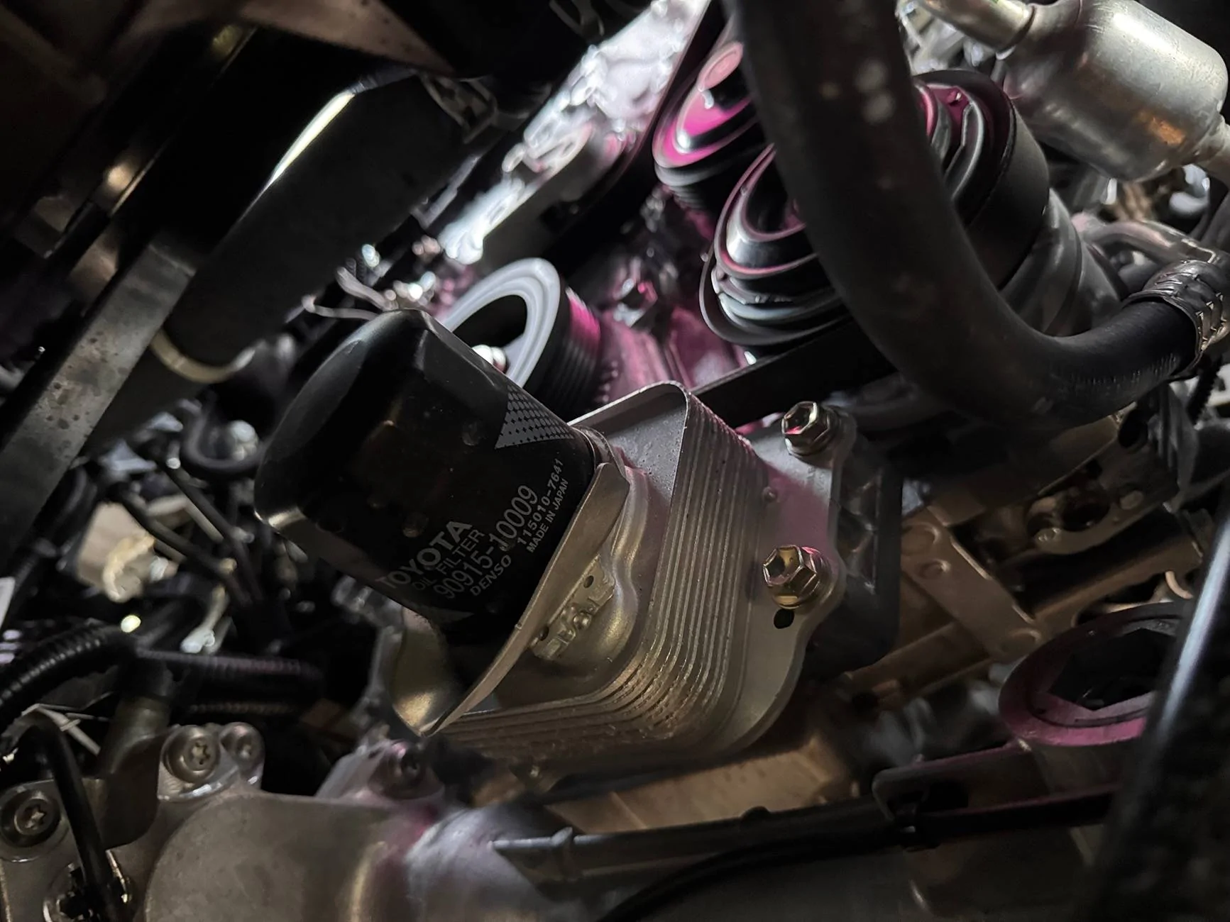

Just checked the oil filter, it is below and directly in front of the engine, looks to be mounted on an oil to water cooler, cooler looks to be directly plumbed to engine block coolant (no external hoses). Have no idea what the SR5+ oil cooler looks like. As already stated, I don't like the factory oil to hot water "coolers" and will probably go to a nice aftermarket oil to air cooler in front of the of the radiator.

SR has a spacer that looks like an oil cooler, the SR5+ has a tinker toy oil to water heat exchanger.

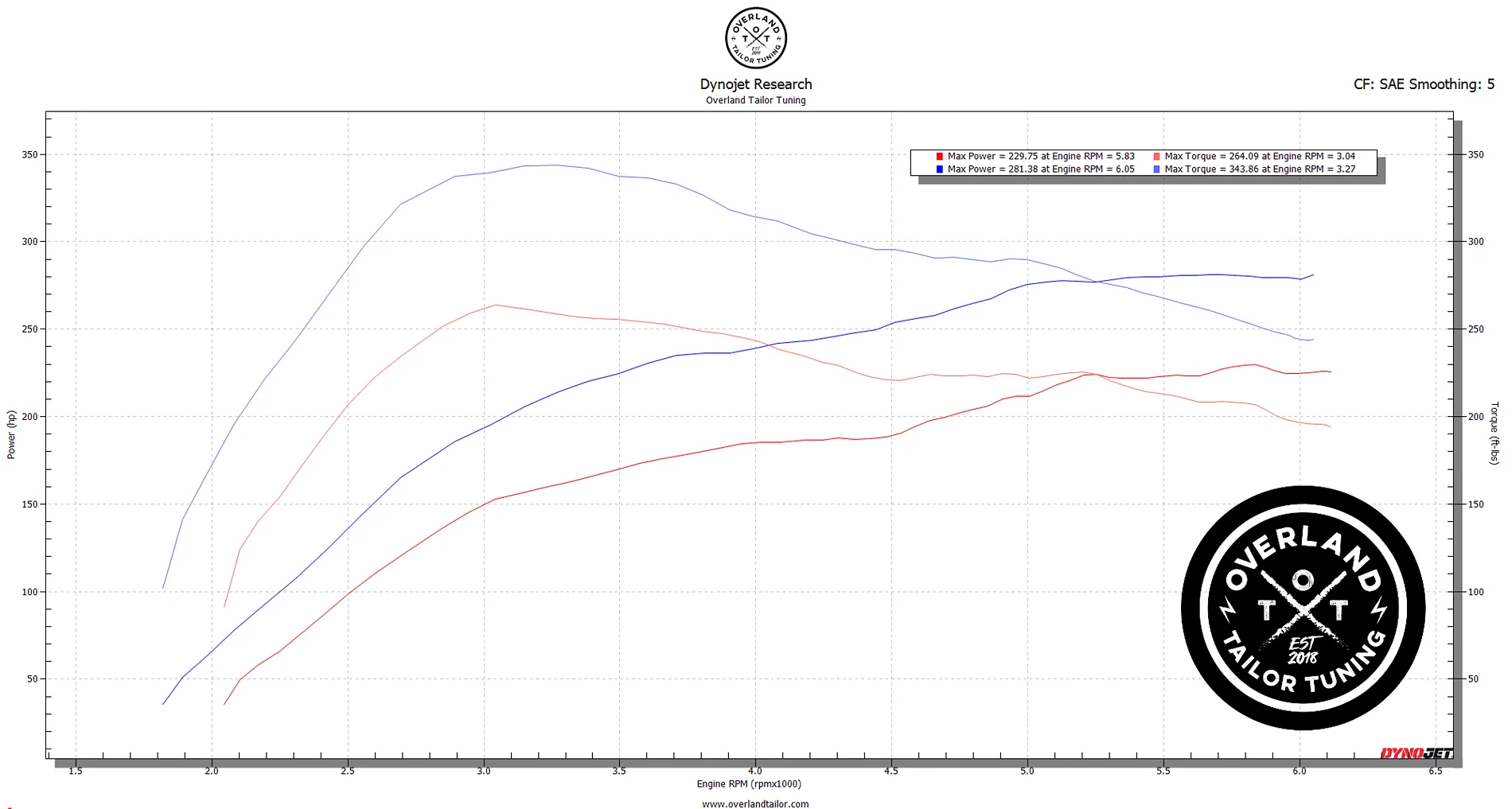

Had an SR on the dyno today, thought I'd share the results. The SR makes some 'JAM'!
*Note* This is on the native SR Calibration.
And Toyota marketed these as 228hp crank? huh :cwl: don't show this to too many ppl

Is this an SR with automatic transmission?
