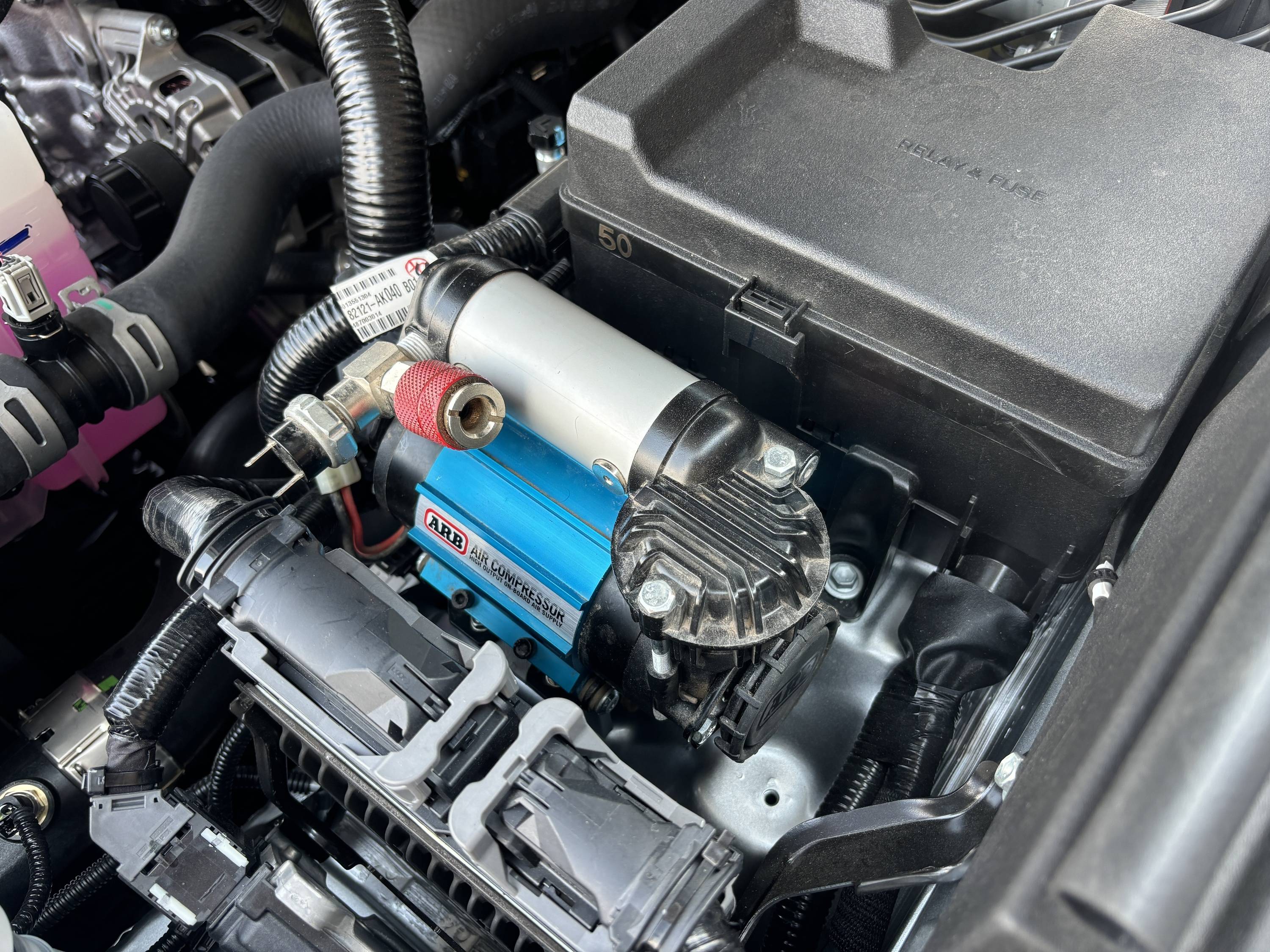

I've never seen an onboard vehicle 120-volt compressor.
I mounted my single ARB compressor under my hood.
