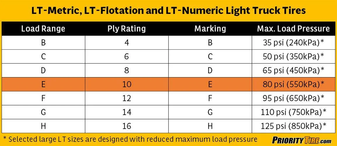

I have an off road trip coming up in a week, and I'm trying to find out the ply rating for my stock tires.
They are the BF Goodrich All Terrain tires - 265/70 R17
I've looked up all of the various ratings that are marked on the side walls, but I can't figure it out. Does anyone have an idea of the ply rating for these tires?

4 ply. I traded mine in for 10 ply tires.
