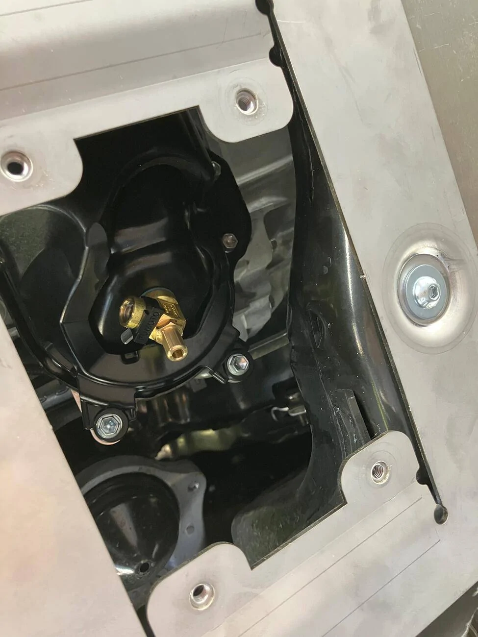

Here's how the 103 looks:
I assume that's the F103N with the long nipple. I bought the F103SX with the short nipple and that was a mistake. I wasn't aware there is a hose kit that is available so I'm going to buy that and hopefully that will make it easier to use but knowing what I know now the F103N would have been the better choice. The valve is completely protected under the truck so there's no good reason to have the short nipple. The long nipple would make it so much easier to put a hose on without a special kit.
Either way, everyone is correct, the F103** model is what you want, the variation is your preference.
Correct on F103N. FWIW, you don’t need to purchase a special hose kit—— 1/2”od - 3/8”id tubing from any store will work along with small hose clamp.

Yeah, the problem with the short nipple is that I can't get a hose to stay on it and it's too short for a hose clamp to grip it.

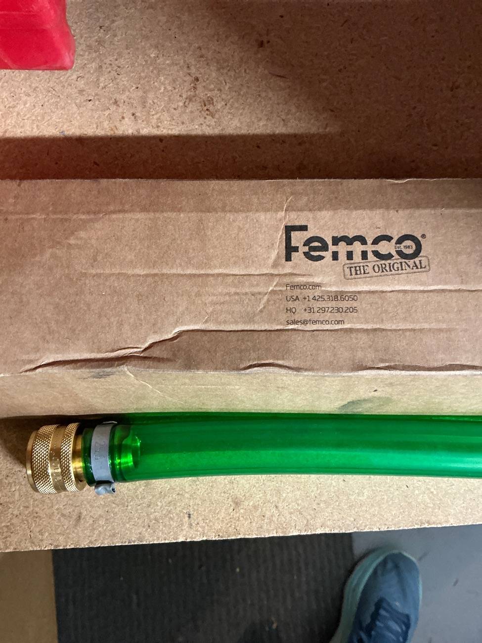

I would check out the Femco drain plug . I think they are much better. I have it on my jeep and it works great with no mess. The plug has a normally closed valve that opens when you screw on the drain hose. I emailed them and this is what they said I would need see note below. They respond back and will answer any of your questions. Attached is what I use on my JL
2024 Tacoma Which fumato oil drain valve? image
Hello Ted,
The Toyota Tacoma would take any of our plugs with an M12x1.25-T9 thread pitch. Residual oil is not an issue when utilizing a Femco drain plug. We recommend draining the oil at engine temperature to fully flush out all waste particulates. This is easier as Femco’s system prevents burns.
Best regards,
https://www.femco.com/compact-sb-7090010151-m12-x-1-25-t9/
