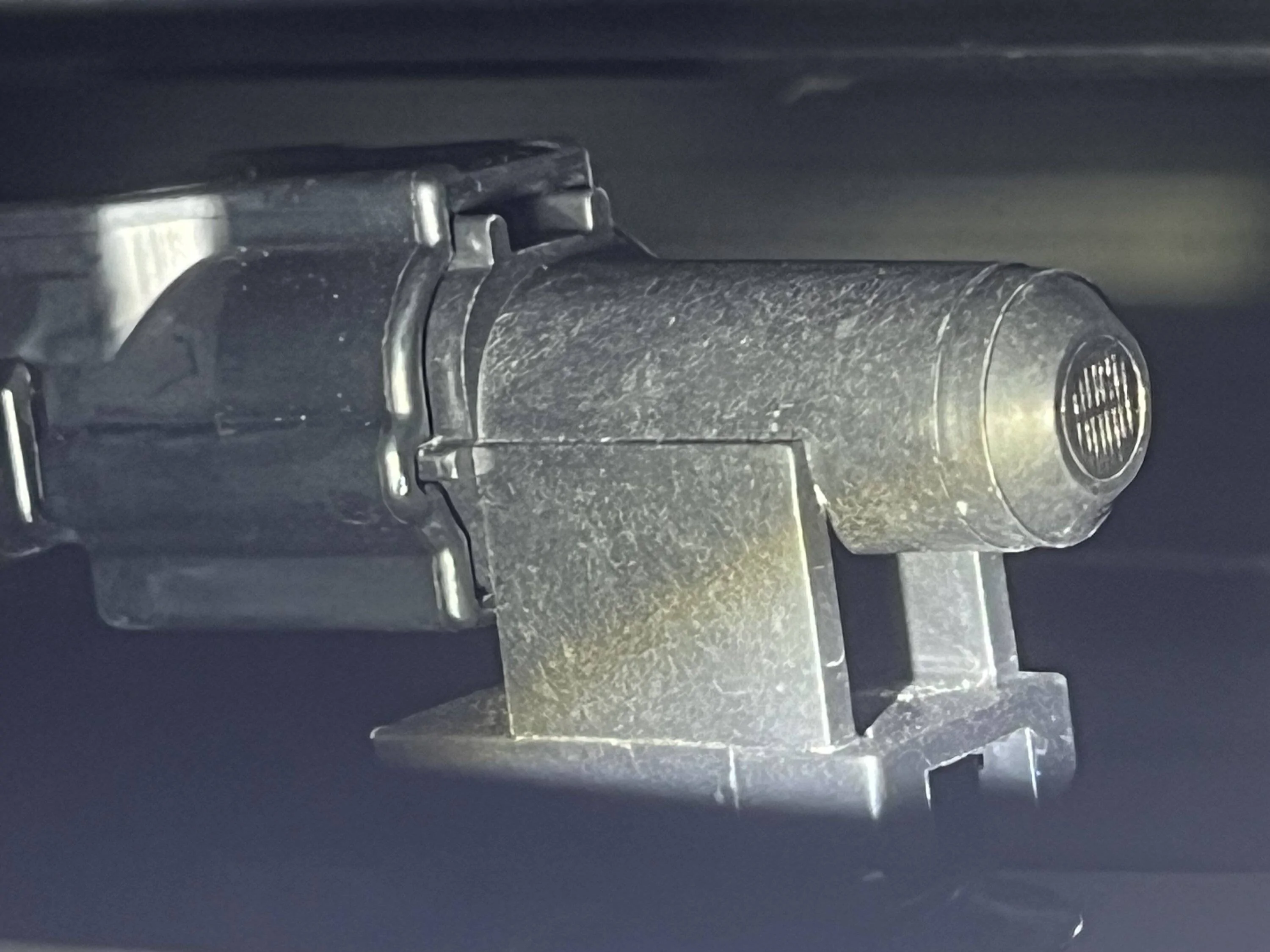

Mine so far has lasted little longer. Also found the sensor from a video posted. Made sure was clipped in all the way
Is it this sensor and can you provide us with the link to the video?
