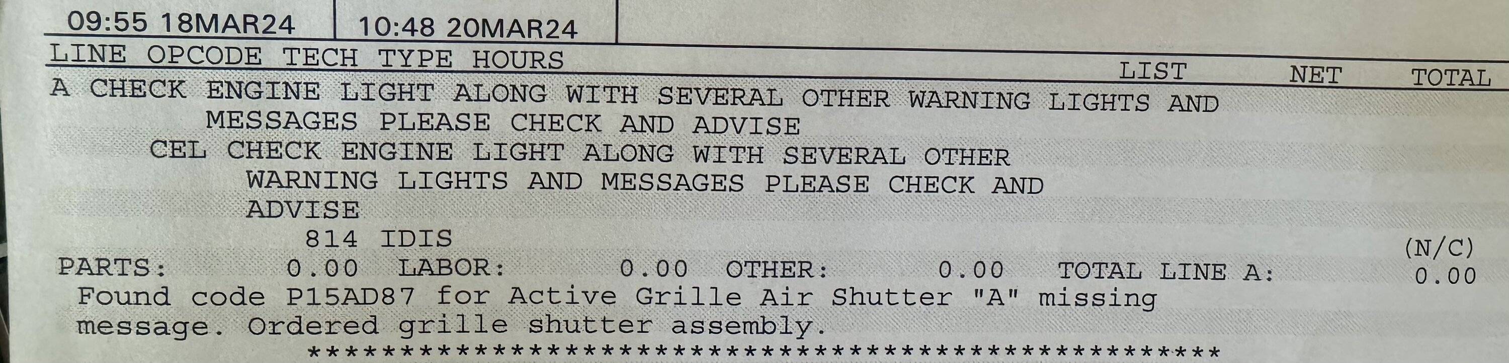

4k miles: Grille shutter, Drive start control, check engine light, system malfunction

I think you’re gonna need a new shutter assembly. Mine has been on order for 2 weeks and counting. I'm told there are none available currently. I had a rental for 3 days while they did diags. When they told me the part was on order and could be weeks I turned the rental in and have been driving mine. Not gonna let it sit on their lot for weeks and get beat to shit with door dings and possible hail.
Probably so. That's ridiculous there's such a large lead time on new parts that are obviously in stock, or they wouldn't be building new trucks.
My engine light hasn't come on yet, about 4 car washes deep so crossing my fingers it stays that way either for good, or until they hopefully issue a recall.

I had the same issue, same errors. Took it to the dealer and the guy that checked me in said someone else came in with the same problem a few days before. I still had to sit around for 4 hours while they confirmed it though. The service manager said it'd take 3-5 days to get the part and they had to take pictures to send to Toyota because some parts "require Toyota approval" to order. Seems odd and sketchy. My shutters are open and they said it's fine to drive in that condition.

Has anyone had this issue with the grill shutters fixed by toyota and if so what is the fix and did it work? Seems like I have seen this issue reported enough but have not seen a clear resolution on it.

I spoke with my dealership today. The dealership called corporate multiple times this week. This is a nation wide issue with the new tacomas and the front grille shutter assembly parts are on backorder. They have no ETA. The dealership said the 2022 Tundra had the same problem when it was first released and it is an easy fix. I called toyota corporate today. They were very sympathetic and also noted that something similar happened with the new Tundras. I asked if I can return my loaner corolla and get reimbursement for a rental truck. They said they will look into providing me reimbursement as well as fast tracking any necessary parts as I have been waiting almost 3 weeks. Both phone calls took less than 5 minutes. I'll keep this thread updated.
