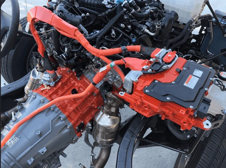

My point of view, if they're willing to put this in the Lexus NX/RX, the Toyota highlander & Grand Highlander, the flagship Crown crossover turbo hybrid AND the Tacoma... and possibly (most likely) the 4runner too we're most likely looking at a very good motor choice. Looking at the design of the T24A-FTS, its a twin vvt-i timing chain motor, with the oil pump driven by chain too and going back with the spin on oil filter.. I think this is a winning combination that will easily get 250,000 miles with maintenance.
My only worries lay with the initial production and working out any potential bugs, oh and I also don't want a hybrid because I think the electric motor mated to the transmission is a bit overly complicated for my taste when thinking about owning this truck for 25 years.

Toyota is all in on Hybrid systems. I own 3 with zero problems. One is a 15 year old Prius I bought used and has 150k battery is still good. After market new Li/ion would be $1800 diy and out perform a factory pricey replacement.
My only concern is the new system is the MGR uses a clutch pack vs the planetary gear eCVT, so it will wear out at some point? So far zero reports of this happening in the Tundra and I’m quite sure Toyota over engineered it for a long life. And using the same MGR that’s in the Tundra that is far heavier it will certainly last longer in the Tacoma. All Toyota 2020 and later Hybrid systems have an 8yr 150k warranty. The extra power without the extra stress on the engine will extend engine life as well as less engine run time, electric pumps, ac, etc will also help reliability and efficiency. My opinion, Short and long term the hybrid will be equally or more reliable.
