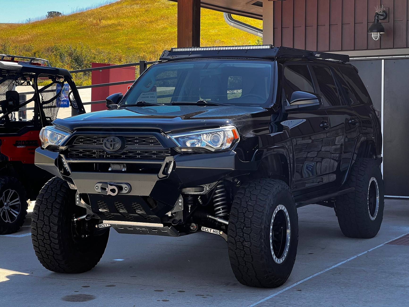

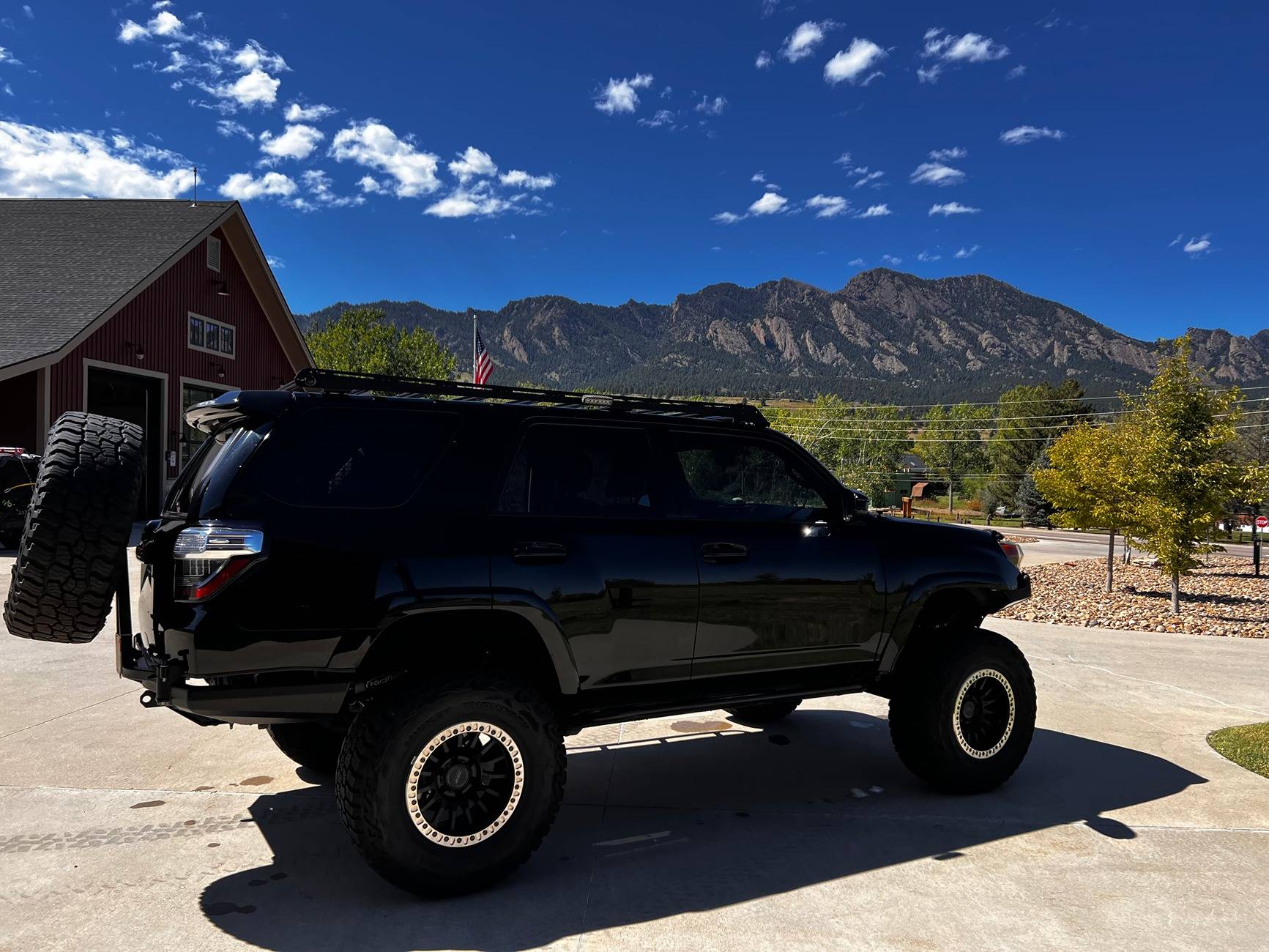

Do you have any pictures of the 4runner build? Always been a huge fan of modded 4runners

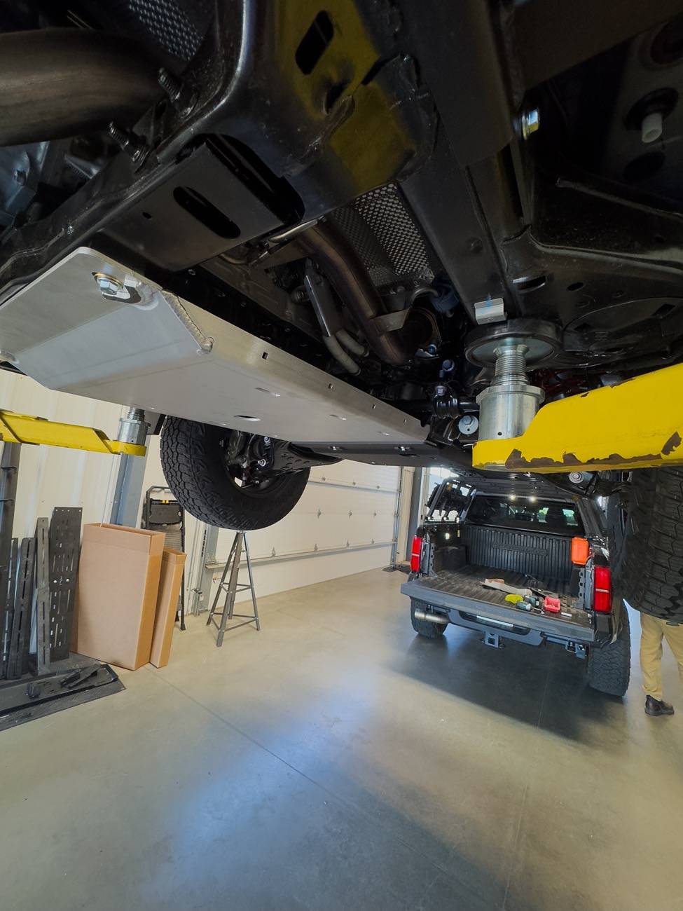

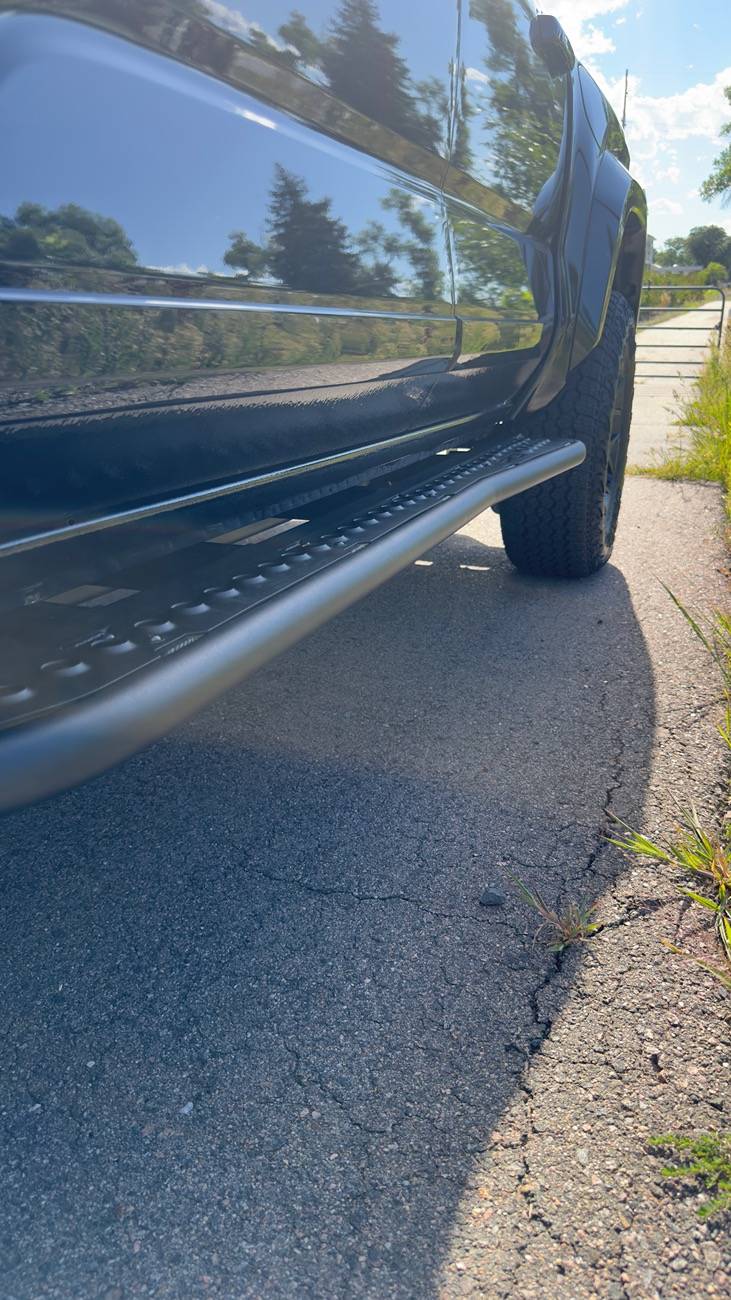

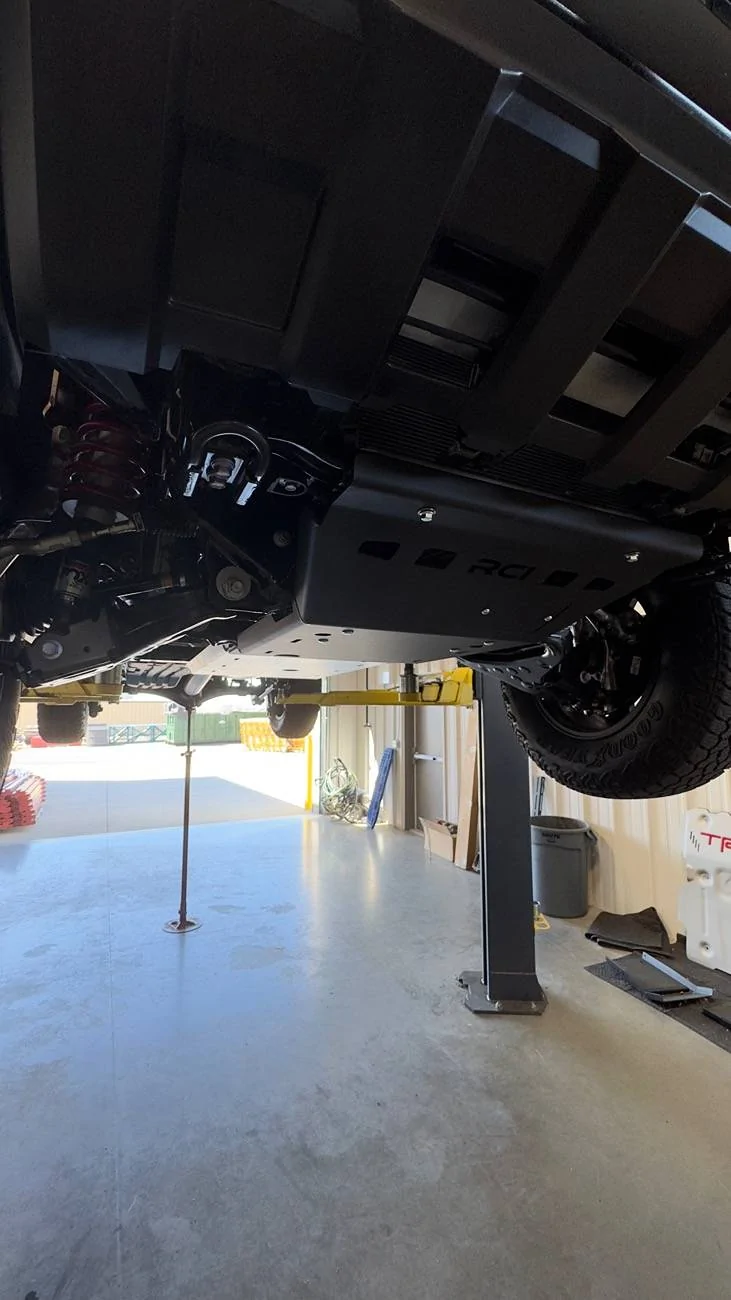

I have been working with RCI on test fitment and prototyping for their armor for the pro/hybrid model. Their work is top notch they do every aspect from design to fabrication to powedercoating in house. I love to support local company’s that are building American made products.
Here are a couple sneak peaks. full production armor on the way soon!
