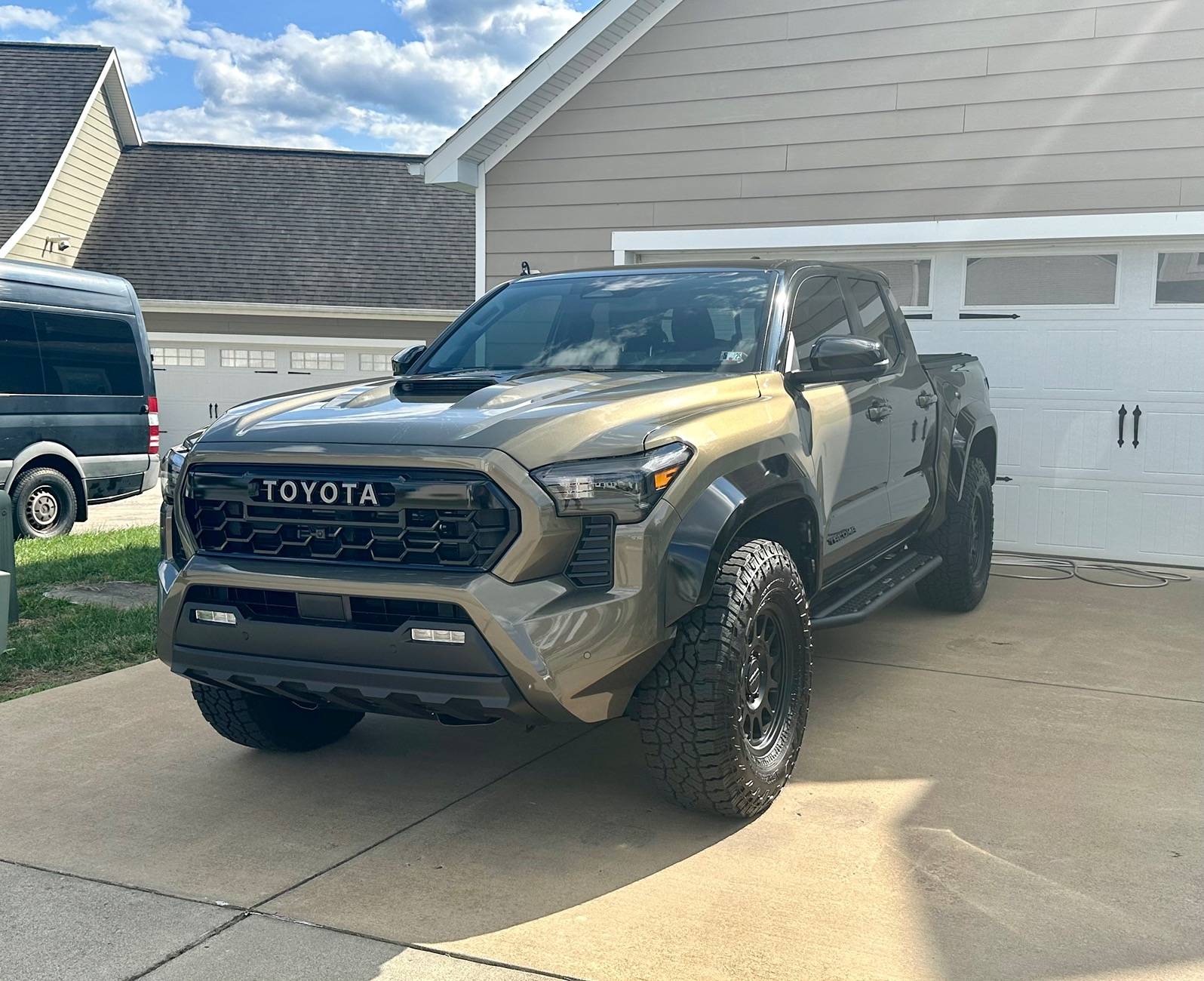

Awesome build up. I have been really struggling with the big chin on the OR bumper and deciding between PRO style or doing a viper cut so thank you for posting the pics. Something to note is that offset really plays a part in fitment. I have the exact same tires with a 0 offset rim and had to trim the back of my front fenders, get an alignment to push caster positive and now cut into the front felt liners. Thats with mine lifted. I have 2 sets of uninstalled 1" Spidertrax spacers so message me if your interested in a deal on those.

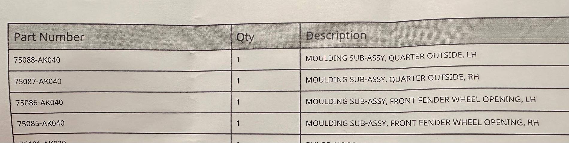

@TRD_Patty do you happen to have the part numbers for the PRO fender flares? I'm thinking I might get the polished and have them wrapped since I can't find the matt ones. Also, did you ever get the wheel well liner for the TRD PRO/TH front bumper cover?

yes here you go.
still haven’t gotten around to getting the liner, right now the stock one is just tucked forward, it’s fine for the time being.
