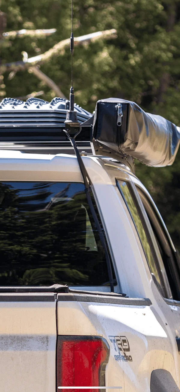

I ran the coax out my cab to my prinsu rack for radio antennas out one of the grommets under the back seat, then up the cab between the bed. Used some wire loom and adhesive zip tie holders to hold the wire bundle to the window.
2024 Tacoma Adding a Prinsu roof rack with lights- where to power from? IMG_1750
