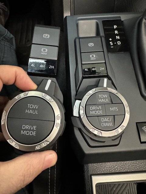

Just installed mine and it was a no go for me. Can’t even get the button for Mts to light up. I didn’t disconnect the battery so I will try disconnecting for a bit then reconnect and see if anything changes.

I got mine the other day and installed it. I have the TRD Sport and it would not work the MTS or crawl control. I also tried disconnecting battery. Too bad! I'll keep it and hope someone will figure out how to get it to work.

I was never able to get it to work. Tossed it on a shelf in the garage for future remedies.

I still stand by my original opinion that Toyota isn't going to simply allow a <$200 part to allow access to the MTS abilities. More than likely you need the panel + some sort of module (if the capability are only those two parts).

There'd be two steps to this if one brings the information together. First, changing the dial as OP did. Second, connecting to the truck via TIS software and updating the computer to activate the MTS setup itself.
Per that post software can be had for <$20 for a week's access on the European version, or $70 for the US version (can't remember if that's for a week or month). But you also need a $$$ supported ODB connector cable.
So I suspect if you really wanted to do this, you're in it for about $800 + time (dial, connector, software rental). Each person would have to decide if the feature is worth it to go after.

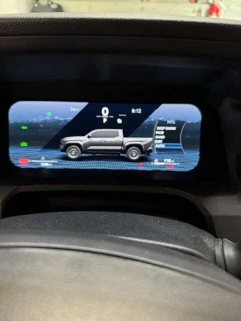

All - Nope not my eBay store, not trying to scam anyone - all I can tell you is that it did work for me. I corrected that the crawl didnt work - but MTS did
I was just kidding, I don't actually think it is your store although that would be a slick move.. I believe it worked for you, I am just bummed it didn't work for me. Oh well it was worth the money to give it a shot and maybe someone will figure it out sometime how to make it work for me too.
Either way I appreciate you being the first to test it out and sharing with the forum.
