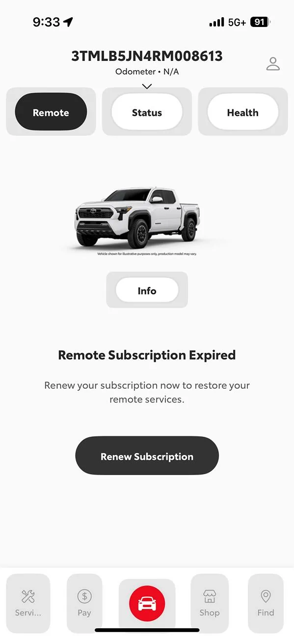

Looks like it’s because of the Toyota App subscription expiring…jerks

Be prepared y’all. They expire around six months after vehicle purchase

I bought my truck in mid May. And it’s expired
That’s when I purchased mine and it says expires May 15, 2025.
And even if it does expire…. I don’t think it was reset all your factory settings.

Six months, one year. That’s not really the issue here. When it’s up your truck will revert back to how it was delivered at the dealership
I don't think that's the case, I think something else happened. Also as others have said it's should be one year, mine is up in April.

I guess we won’t know for sure until yours expires.
It happened immediately after mine expired.

My app is one year. All my settings were reset as well but I still have active sub. My software update. It’s never happened before. We’ll see

This happened to me as well, trial was about to expire and i went in preemptively to cancel and turn off all the tracking stuff. Next day i went in my truck and everything reset even had to re add my phone
