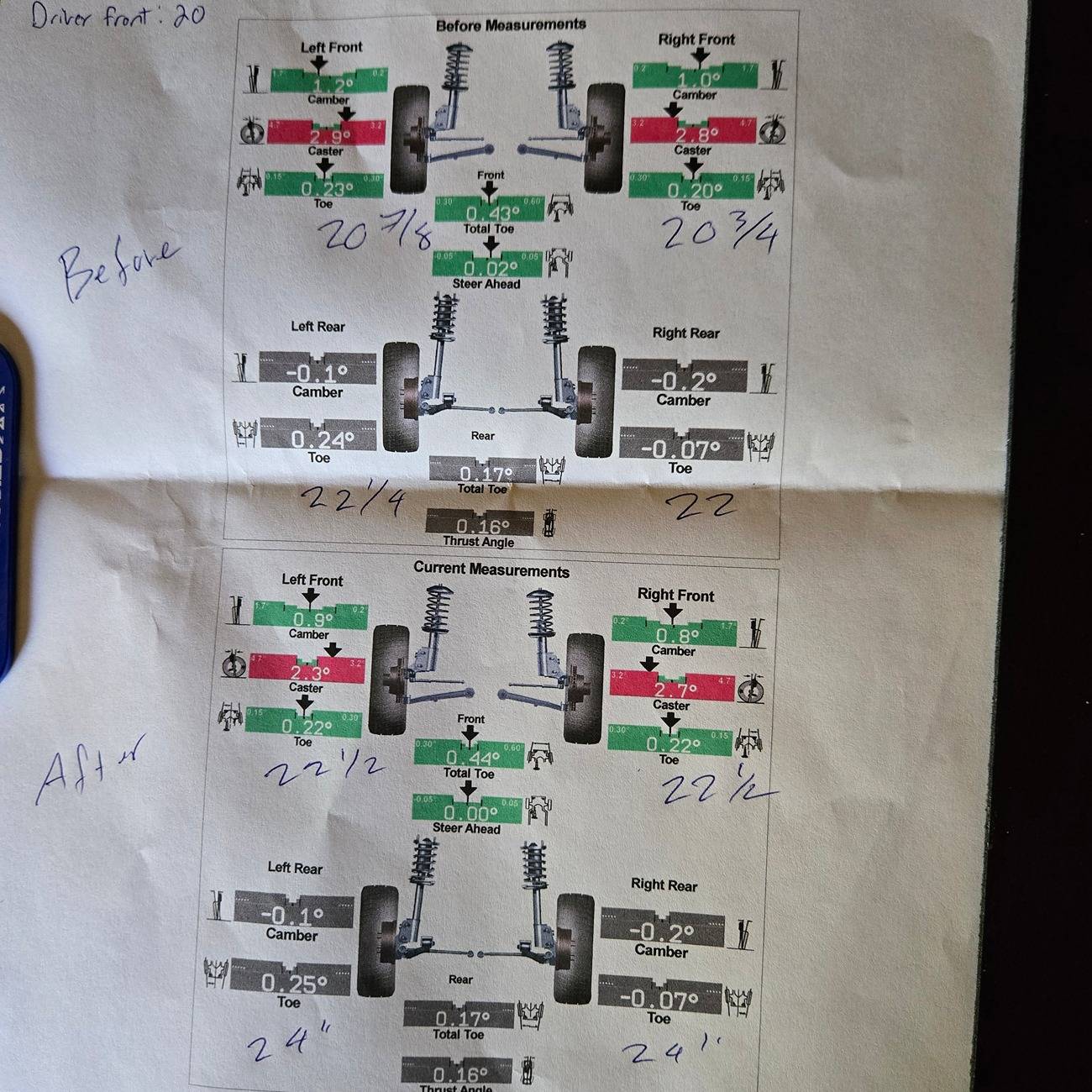

I installed the Alldogs front springs on my TRD Off-Road this weekend. Initial measurements showed exactly 1.5” of lift, but after alignment and 100 miles of driving it has settled down to a 1” increase. Rides really well and I tend to agree that it’s a bit more plush. Was hoping for more lift, though.
Hmm, this is making me consider the Dobinson 2" ones then if they're going to settle that much.
Anyone else's settle to 1"?

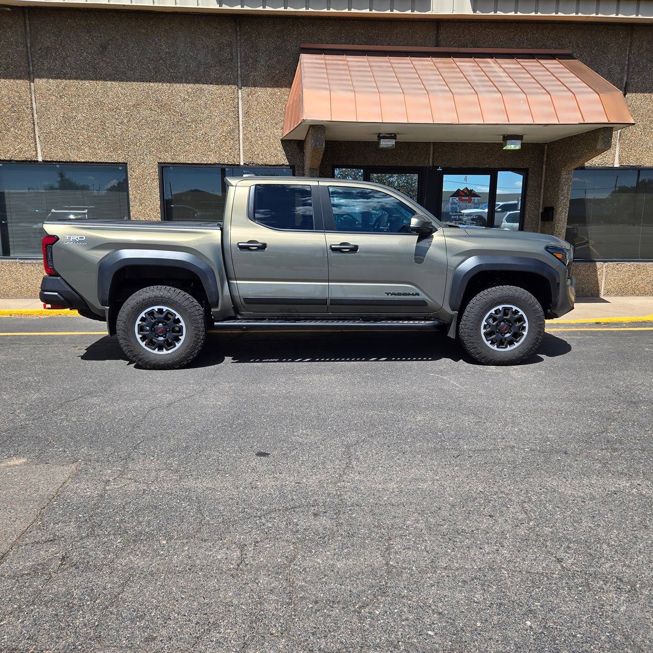

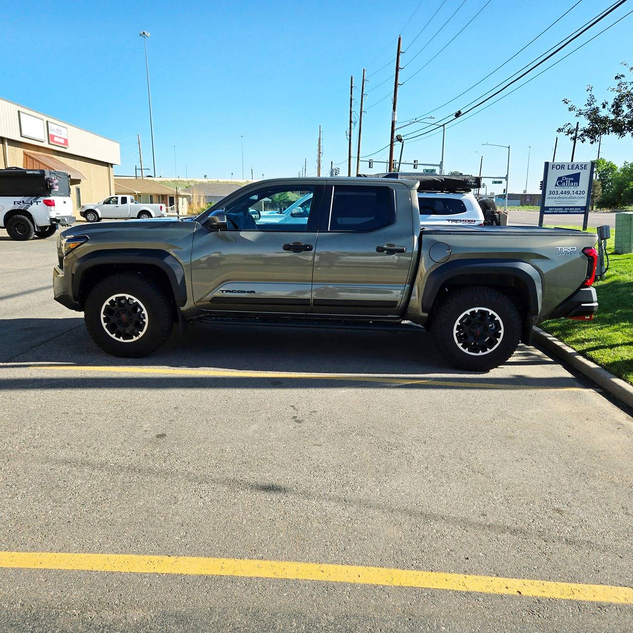

i was told recently when i checked with them that the next batch of springs will have a little more lift in the front so apparently they will be 1.5" after settling.
Romer
Ken
Mar 11, 2024
183
192
Centennial, CO
I called and confirmed this.

He told me the end of the month. He also said since he is out of stock, any new orders will be the new batch
