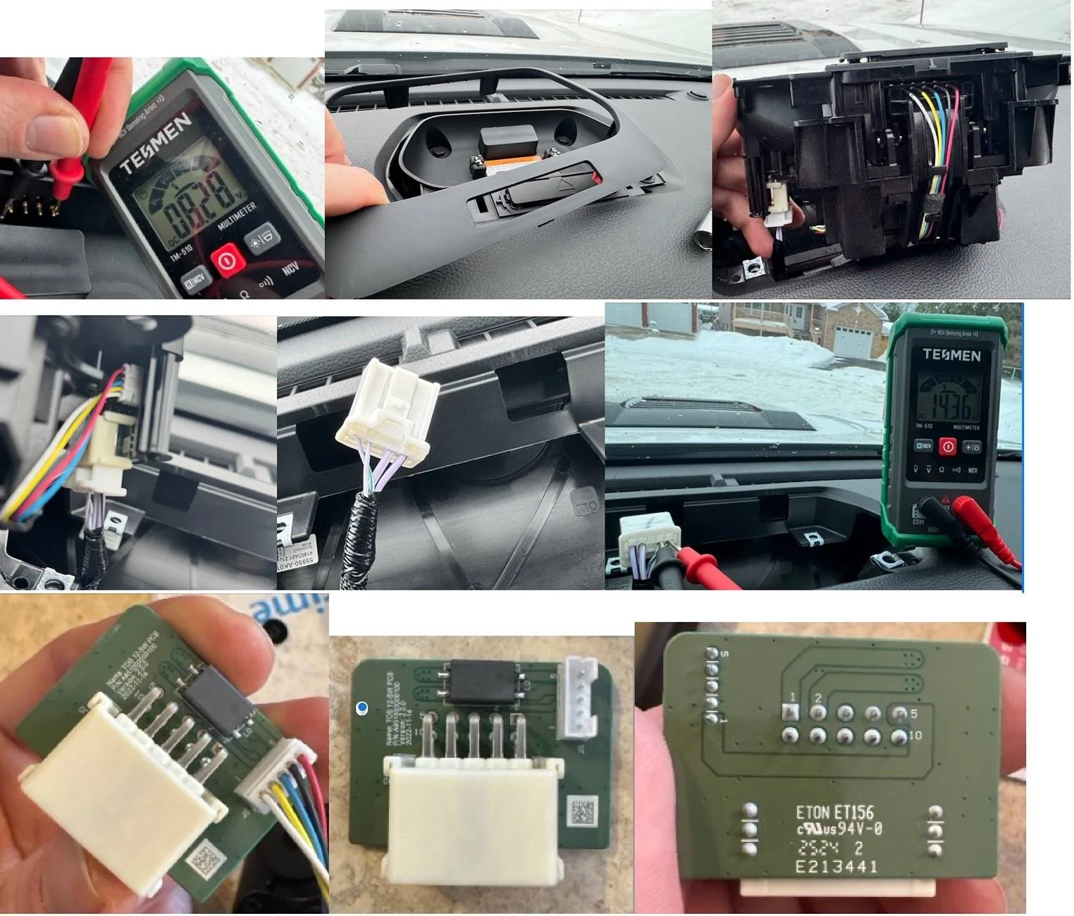

I was looking at the JBL center yesterday [since it's not in the truck!] and noticed it has 5 contact pads for the dock's 5 contact pins.. I think there's 3 scenarios:
1) Custom interface/protocol for power and audio
2) USB interface [should be 4 wire vs. 5... possibly an additional constant +5-12V to the USB's ACC]
3) Power [2 wire] + Stereo Audio [standard stereo 3 wire: left+, right+, left/right-]
On the off chance it's scenario 3 a simple 3 or 4-wire volume knob would do the trick.. I'll get the multimeter out this weekend and see which pins/contacts supply constant voltage and report back.
EDIT: Posted results in follow up message

Update:
There's a good chance we have an analogue single channel 2-wire pair to the dock. Should have speaker, wire and time to confirm tomorrow.
Details:
I took the JBL dock apart today.. Although it is 5-pin/contact the dock itself is fed 4 wires: Batt +/- and what I assume to be center +/-
Batt is constant, verified at >14V with ignition and >12V without. Assumed center channel would be high/amped or low/line and will confirm tomorrow using an old speaker and some speaker wire - I also expect I can trace the center channel wires back to the head unit. All four wires are connected to a very small circuit board bolted to the side of the dock with a single IC/chip that is converting the 4-wire [toyota] input into the 5-pin [JBL] dock output: +8v/+8v/unknown/negative-ground/unknown..

As suspected, we have an amped center channel.. using a passive speaker it sounds much better than the JBL!
Details:
We have a Toyota head unit [and likely JBL amped] high level center + constant battery supply
connected to the dock which in turn converts voltage and audio into to the removable JBL's 5 contact connector. I suspect the dock conversion IC is also performing high-to-low levelling on the Toyota's high center. Using a center channel speaker from a small home theatre kit I am getting much better quality audio and perfect balance to the L/R..
For those planning on keeping the JBL center: IMHO the best option would be is a high level speaker volume adjuster on the Toyota harness to the dock. This would allow you to lower the volume pre-JBL dock conversion and quite likely improve the audio fidelity as well.
I've recorded the center both with a passive speaker and the JBL.. apologies for the minor, "god D" profanity... I'll blame the brutal wireless CarPlay latency there:p :

Roger.. For those wishing to lower the JBL centre volume: I don't know much about lowering a high level channel [amped] - Everything I've found is a high/low converter or a low/line level control. Adding resistance/impedance before the dock is likely what's needed.. This is or was a common requirement for in-ceiling speakers generally in older homes before the Sonos era.. EG: "70V Mono 25W in-Wall Volume Control Unique Thru-Put Easy Daisy Chain Install (White, Almond, Bone) MVC25" which takes a high level input between the amp and the speaker.
