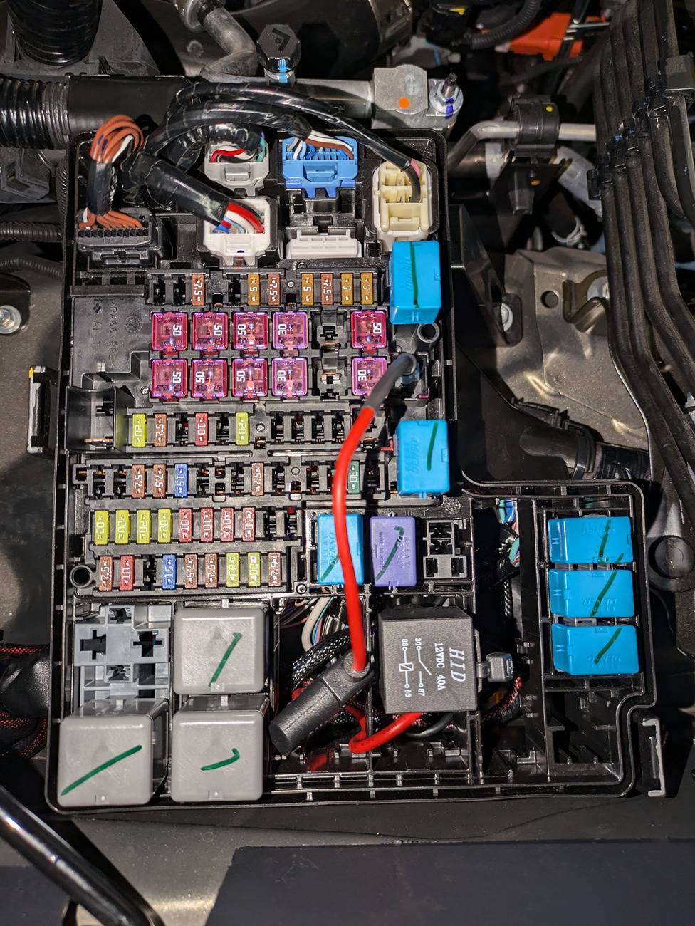

Building on the above comment, sounds like the installer isn't very creative. You can tap into 12v constant hot right in the hood of the hybrid. Just put an insulated spade plug on any unused fuse blade within one of the two fuse boxes. I used the driver side one for my light bar.

That’s not gonna work with a plow setup for certain.
Why not? If you're trying to tap into the battery as a power source, it's equivalent. The rest of it is frame mounting ease/complications.
if you can jumper the truck from within the hood, you can hot anything you need from within the hood.
should one want to insist they need to directly attach to the 12v, then there is a pass-through flange already existing for the leads running from the battery area and cab to the bed and tailgate area.
There is a pass-through flange for the engine firewall in front of the driver in the corner. There is a pass through from cab to bed within the battery compartment under the rear seat.
So where's the issue that would require someone "tearing up the battery compartment?"

To each is own. I would directly wire to the battery and fused independently from the rest of the truck. But hey if someone wants to try it out and report back on there truck all good ??
unused spades are not fused. You need to add the requisite inline fuse or sub-fuse box. It's simply an extension of the battery hot.
Here's my setup running to an in-line fuse, then onward to the switching relay.

While I agree it’s possible it’s also possible you will overload your fuse panel and damage the plow or panel. It’s not a chance I’m taking with my truck. But to each is own.
