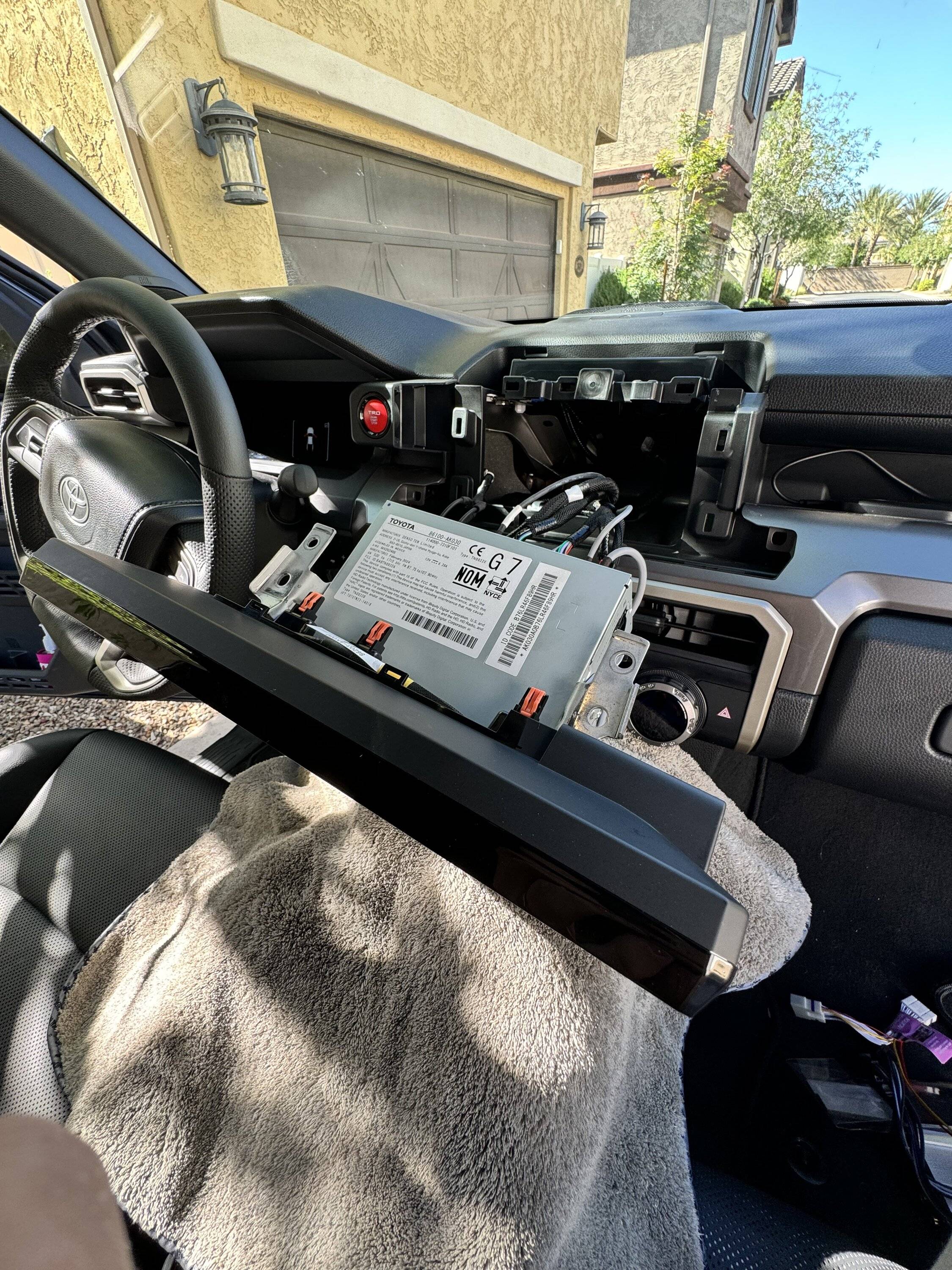

Am I correct in assuming that the stock OEM audio amp in the upgraded JBL is the module mounted to the back of the 14" display?
