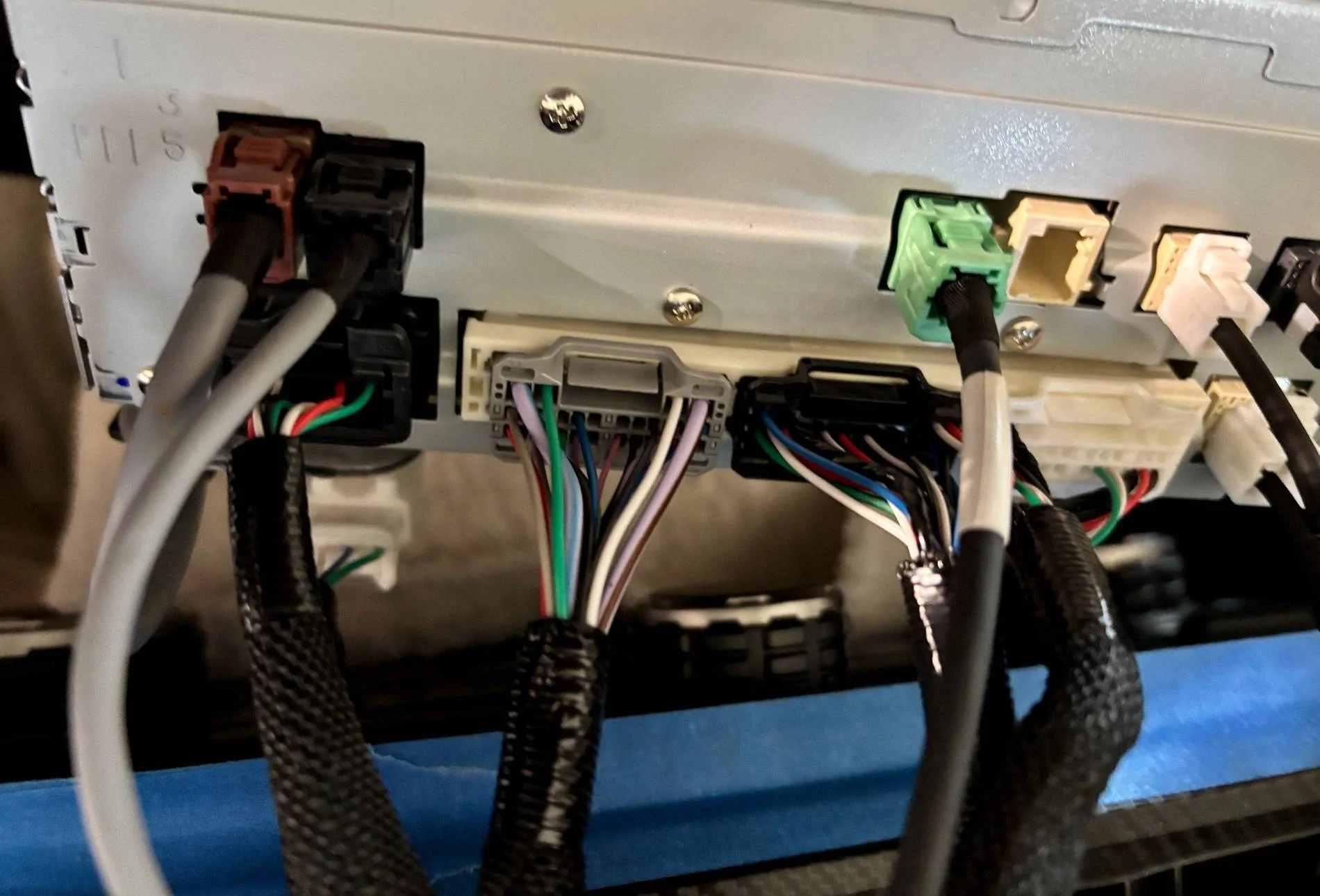

First off, your suggestion on taking out the removable speaker was a good one, it made finding a place for the amp a lot easier.
For a sanity check I attached a picture of the back of my HU before I removed any connectors. I am basically removing the two connectors on the bottom left in that picture, right? That would be the black 10-pin connector and the gray 28-pin connector next to it. If those are not right, then that could be my problem.
All of the Toyota plugs snap securely into the HU. The 10-pin and 28-pin BS plugs snap securely into the HU also. The Toyota 10-pin connector snaps cleanly into the BS cable. But the Toyota 28-pin connector does not snap into the BS cable. I pushed that really hard and it appears to be seated, but it never clicks. Maybe that is the problem?

@hogshooter Yeah I watched those - Thanks!
I'm pretty sure the BS connectors are in the right place. My main question is that Toyota male 28-pin not snapping securely into the BS 28-pin female connector. I might try some mechanical pressure to get them to snap together.

@hogshooter I watched those videos again, and I did have all of the connectors in the right place. I assume that the problem came from not getting the Toyota 28-pin connector fully seated in the BS wiring harness.
I will give that another try when I get the time, and thanks for the help.
Inspect those connectors - you may have a bent pin or something else blocking it.

I had some time this afternoon to finish my amp install. Thanks for the ideas and help @hogshooter and @Ron.
I did have a couple of bent pins in that 28-pin connector in the Beat Sonic harness, as Ron guessed. :thumbsup: So the harder I tried to make those connectors click together, the worse I made it. I straightened the pins and it snapped together easily and I was back in business.
