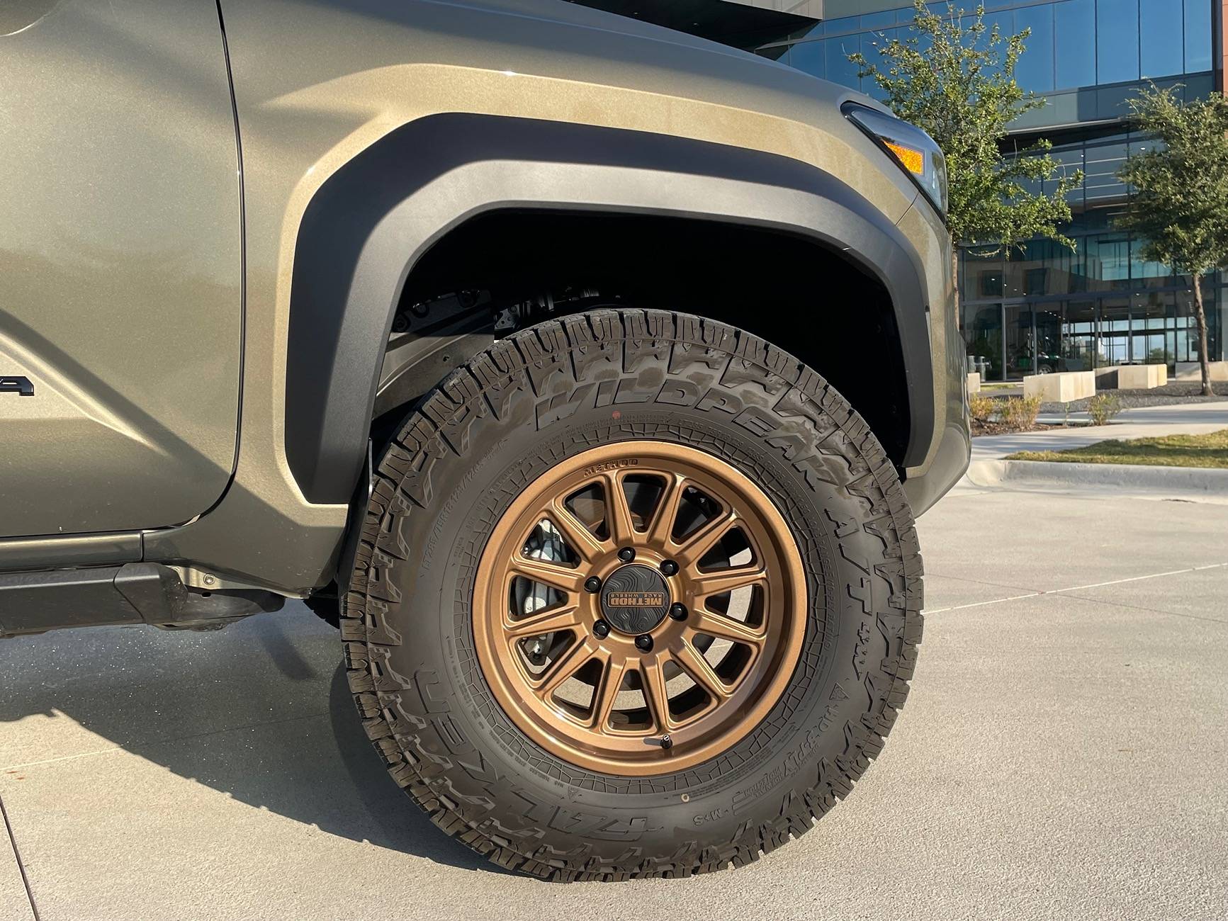

This is the poke on +25, the tread sits about flush with the fender and the sidewall sticks out a little bit past the fender. +35 will sit a little further in than this and +40 will probably have the entire tire under the fender.

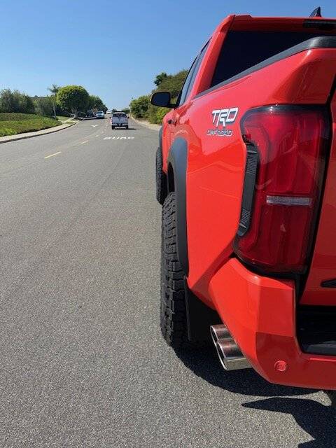

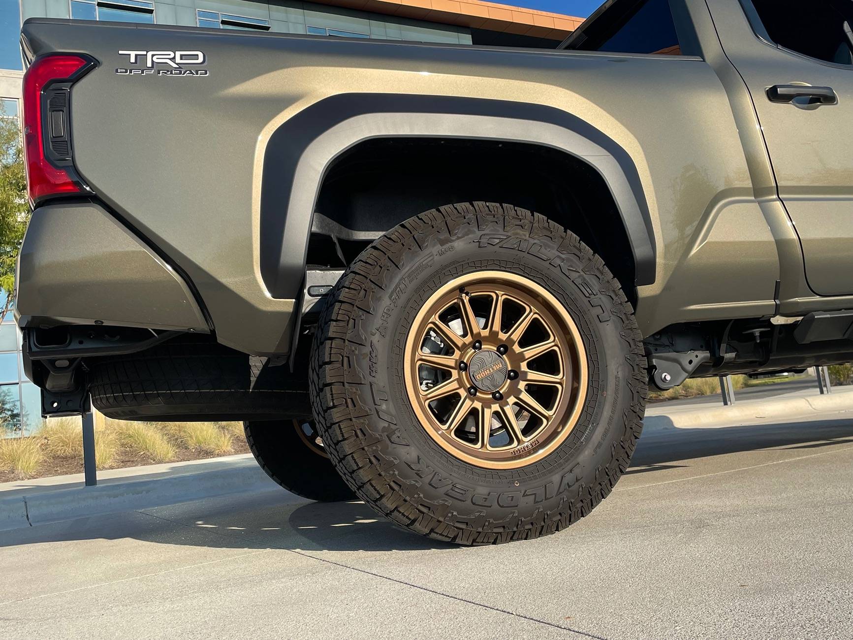

285/75/17 with +25 offset. The tread is to the end of the fender flares, sidewall pokes out a bit.
I chose this offset because I felt it provided the perfect tire “poke” while still providing paint protection from dirt/stones.

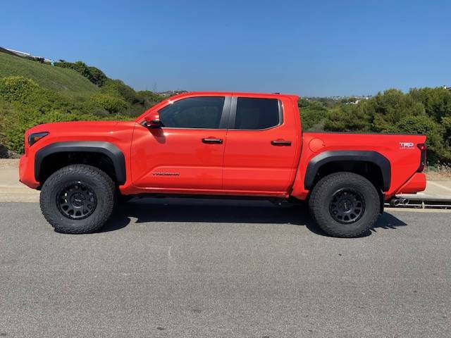

Request granted. This is with a Westcott Designs collar lift installed.

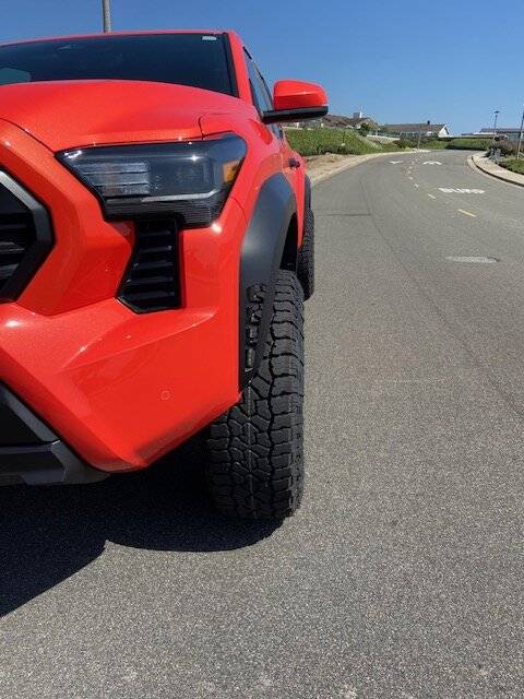

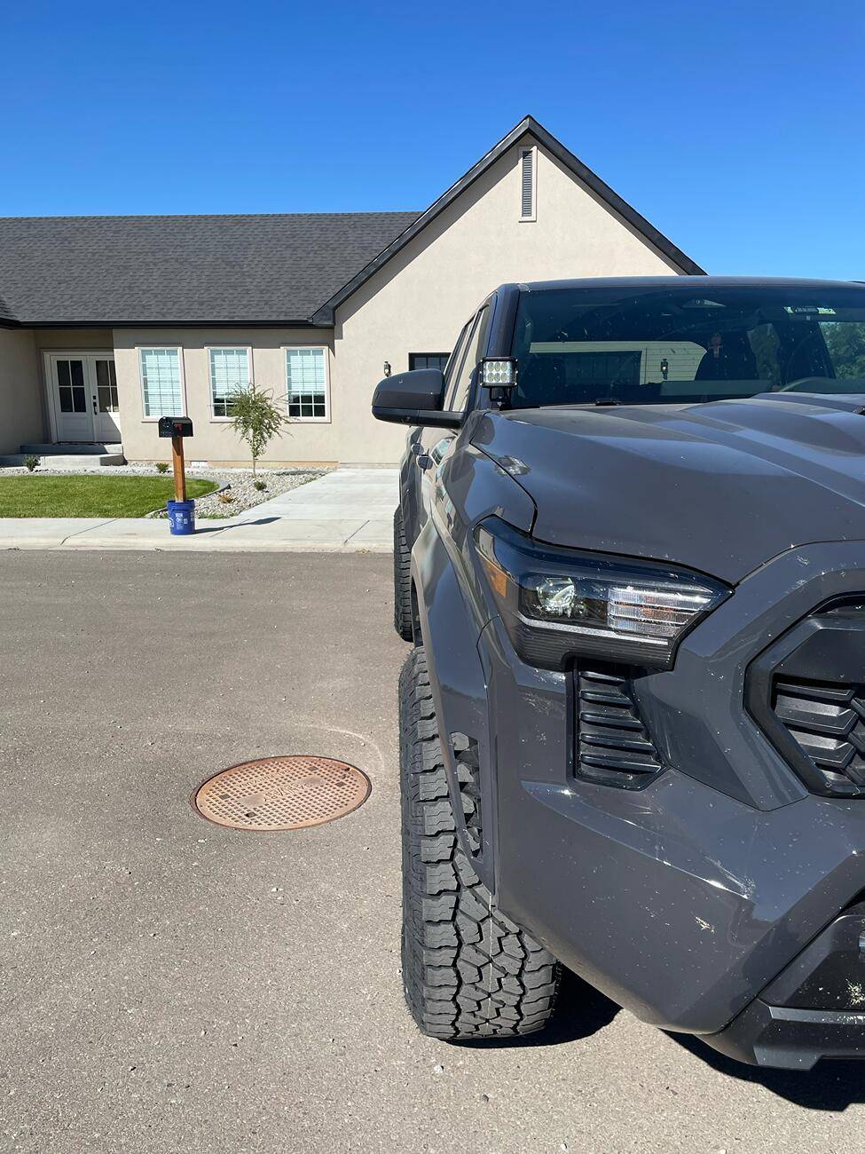

18s with +10 offset. +35 should keep most tires under the fender flares.
