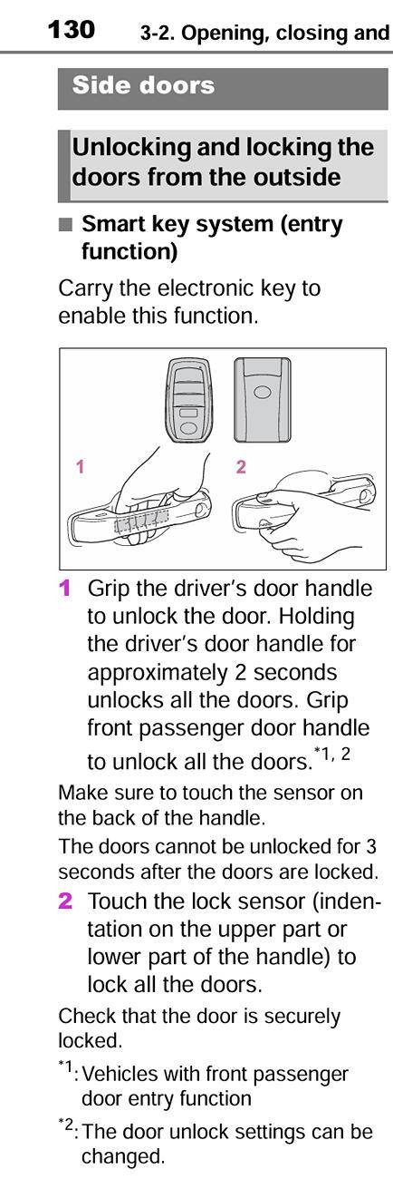

I do wish the Tacoma had auto locking as you describe, but I've found the locking and unlocking using only the exterior door handle a very convenient option. I didn't realize what was going on until I accidentally triggered it a couple times and couldn't figure out why, but you can actually lock the door by grabbing the door handle in a certain way. Here's an image of the appropriate spot in the truck manual.
All you have to do is close the door and then briefly use your thumb and forefinger to pinch the front end of the door handle. There is a little indent there so you know you're in the right spot, as shown in image 2 below. It may not be simply walking away, but it's still pretty quick.

Good info. Thanks for sharing.
